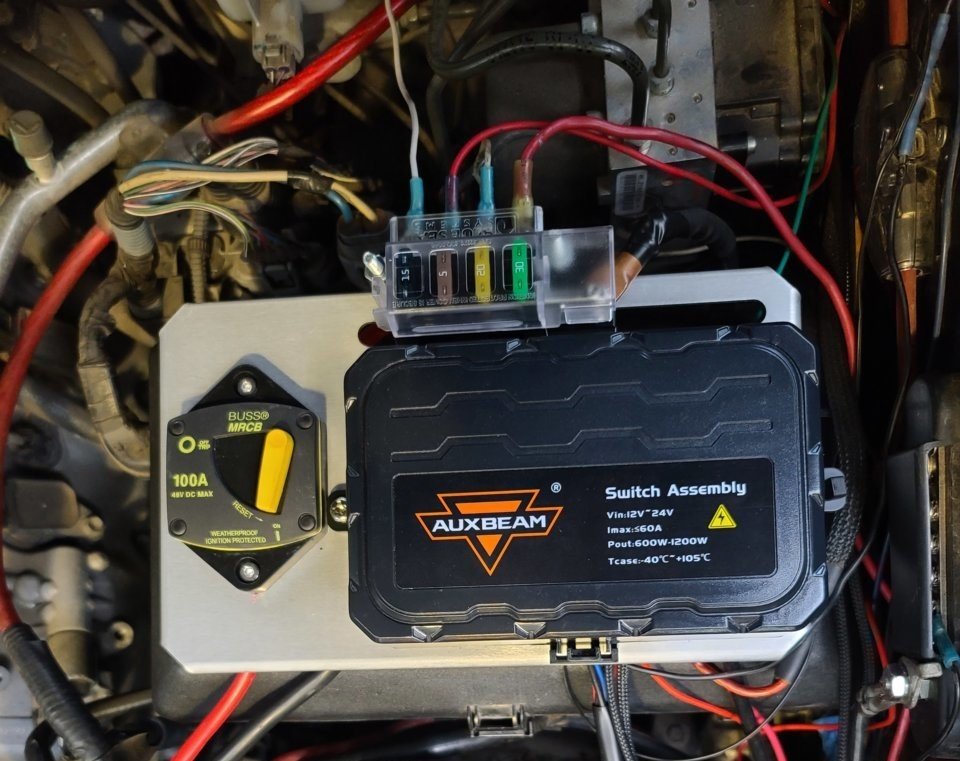

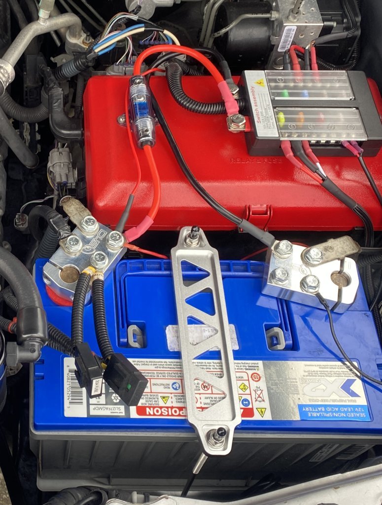

    BeauDacious
    BeauDacious 040 > all other colors
    Mar 5, 2022
    #75444
    515
    Beau
    14 DC 4x
    See here for the solution I came up with.
    2 * 1/2" stand off, with the stock tray.
    I can slide the battery left for removal.
    Wallygator likes this.

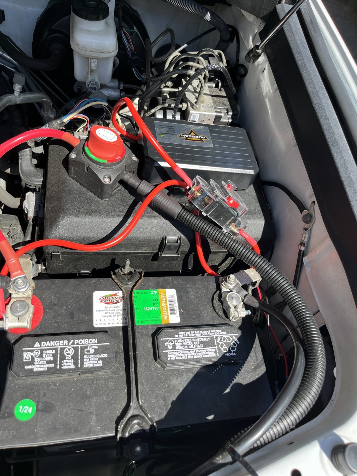

  15. Jul 26, 2024 at 7:17 AM
    PolishedTRD
    PolishedTRD Lorem ipsum dolor sit amet
    Jan 2, 2023
    #89638
    311
    CO
    Supercharged 2011 DC
    Magnuson's Finest Whine

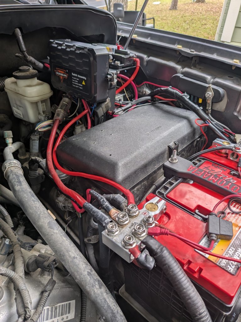

    I used 3M Dual Lock to adhere my Auxbeam to the top of the fuse box cover.
    rdiddy5, smokint, Wallygator and 2 others like this.

    Is that a Stinger Farad cap?
  18. Jul 26, 2024 at 8:14 AM
    PolishedTRD
    Jan 2, 2023
    #89638
    311
    CO
    It's a Stinger 500 amp relay for my winch. I installed the Stinger to isolate power and then use one of the buttons on the Auxbeam to trigger the relay.

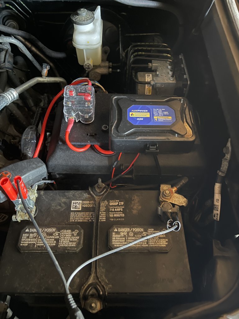

  21. Jul 28, 2024 at 9:27 PM
    smokint
    smokint New Member
    Mar 10, 2024
    #113445
    339
    2017 1794

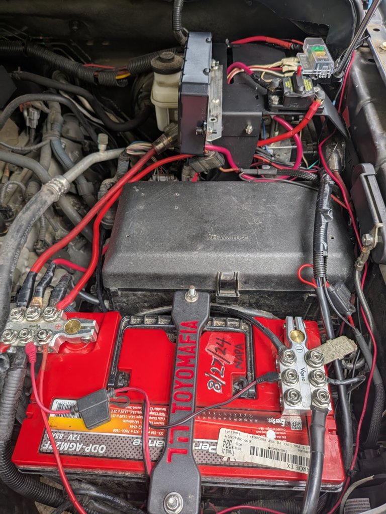

    I'll add my placement to the Auxbeam lexicon.

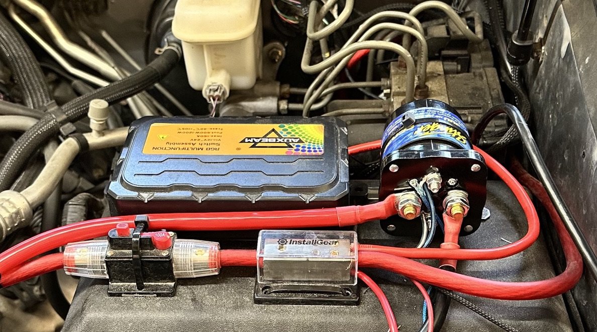

  24. Feb 26, 2025 at 6:44 AM
    #24
    BrandonL812
    BrandonL812 New Member
    Aug 5, 2018
    #17783
    1,471
    Brandon
    2021 Tundra Platinum
    DD ss3 max led fogs. interior and exterior leds swapTRD Shift knob.

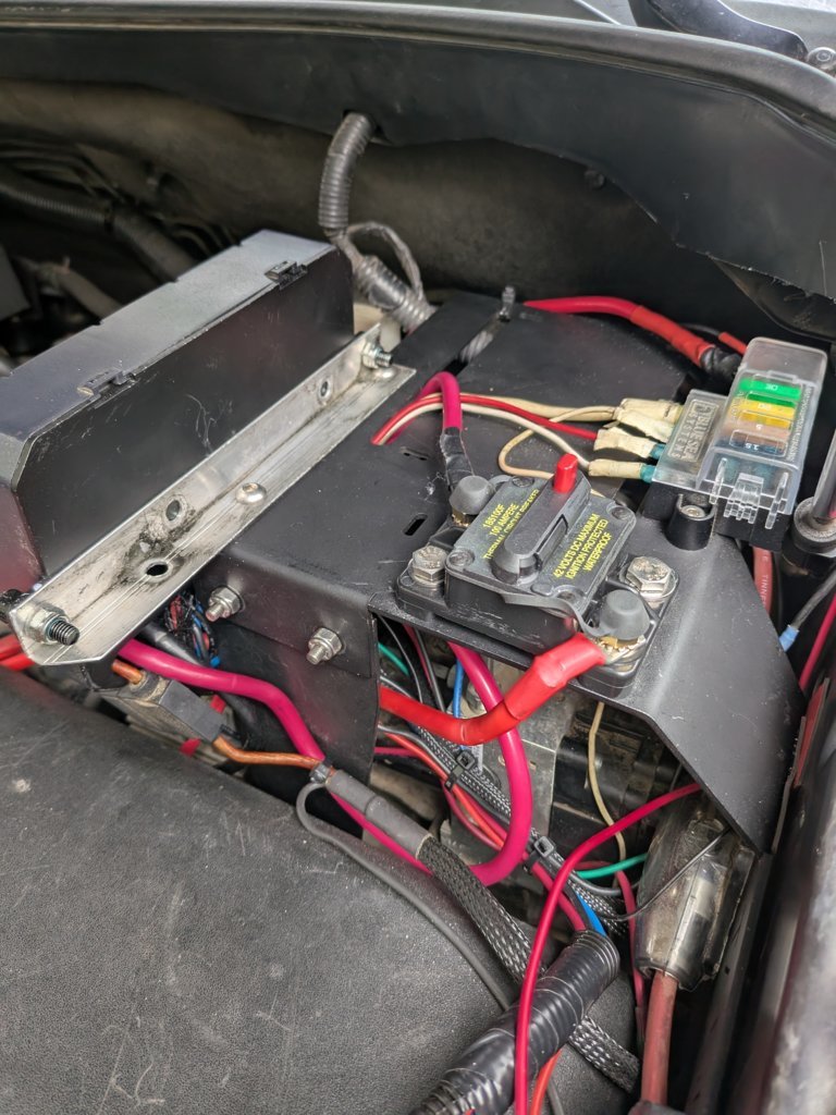

    Mine here.
