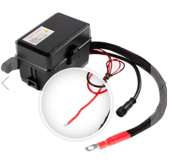

    So this weekend i am going to be installing a auxbeam switch panel just something to run the ditch lights and bumper lightbar. I have a question for the underhood fuse box where would I connect the accessories dimmable wire. its obvious where the power and ground are going but under the hood fuse box is a little different from the inside fuse box. If anyone has a picture of what fuse i should tap into this would be amazing thank you.

    Hey OP did you ever figure it out? My auxbeam panel comes next week and this would be good to know, thanks!

    Yea just fuse tap to acc fuse under hood. Just Amazon some fuse taps I think from like vstar make sure they match the fuse so I think micro or mini not sure and you are good.
