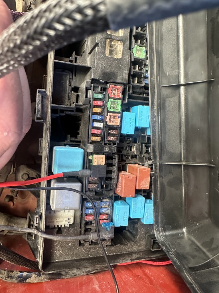

    Need a hand on my auxbeam install. No matter what fuse I try, the backlight stays on. I’m looking for ignition only on. I already have fuse tap in my ignition slot for my DRL LEDS for the iHacker harness. Anybody else run into this issue and have some advice or know which slot I can run my fuse tap into for the auxbeam to only illuminate at accessory or on position? IMG_7281.jpg

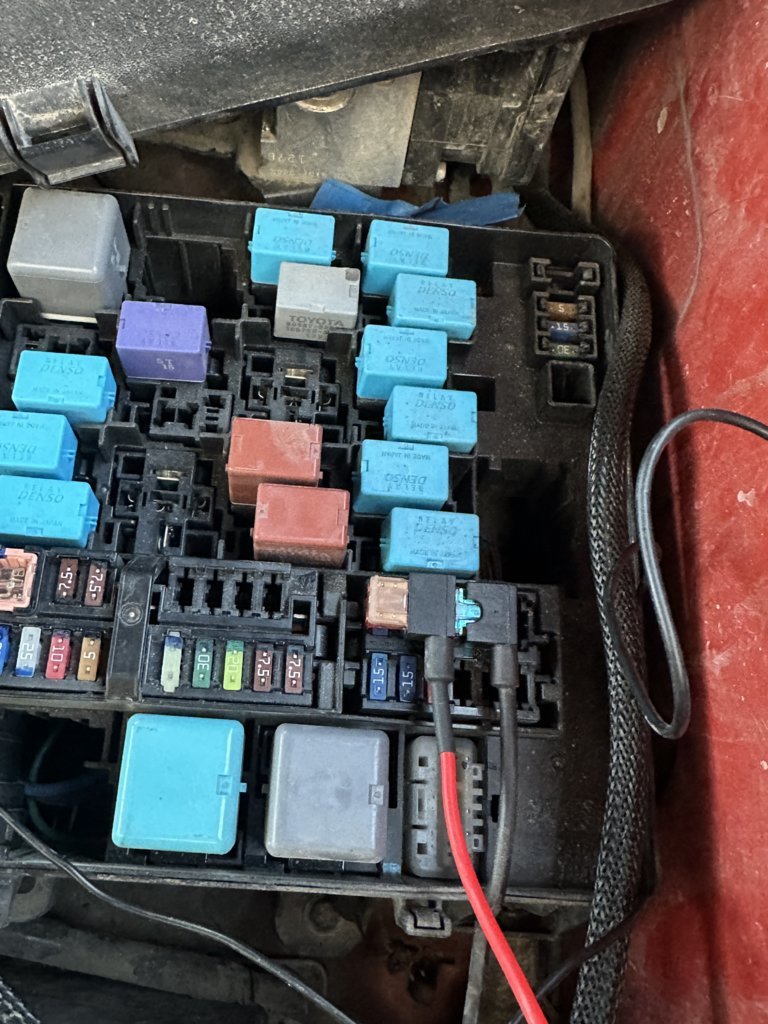

    Well I found I could get it into a headlight fuse and only run the switch when my headlights are on? Wouldn’t mind that to be the case but looking for other options first. Figure if I’m using my light bars I’m probably using my headlights too
    edit: INJ fuse was the one I needed. Hopefully my taps are oriented correctly. All good now
