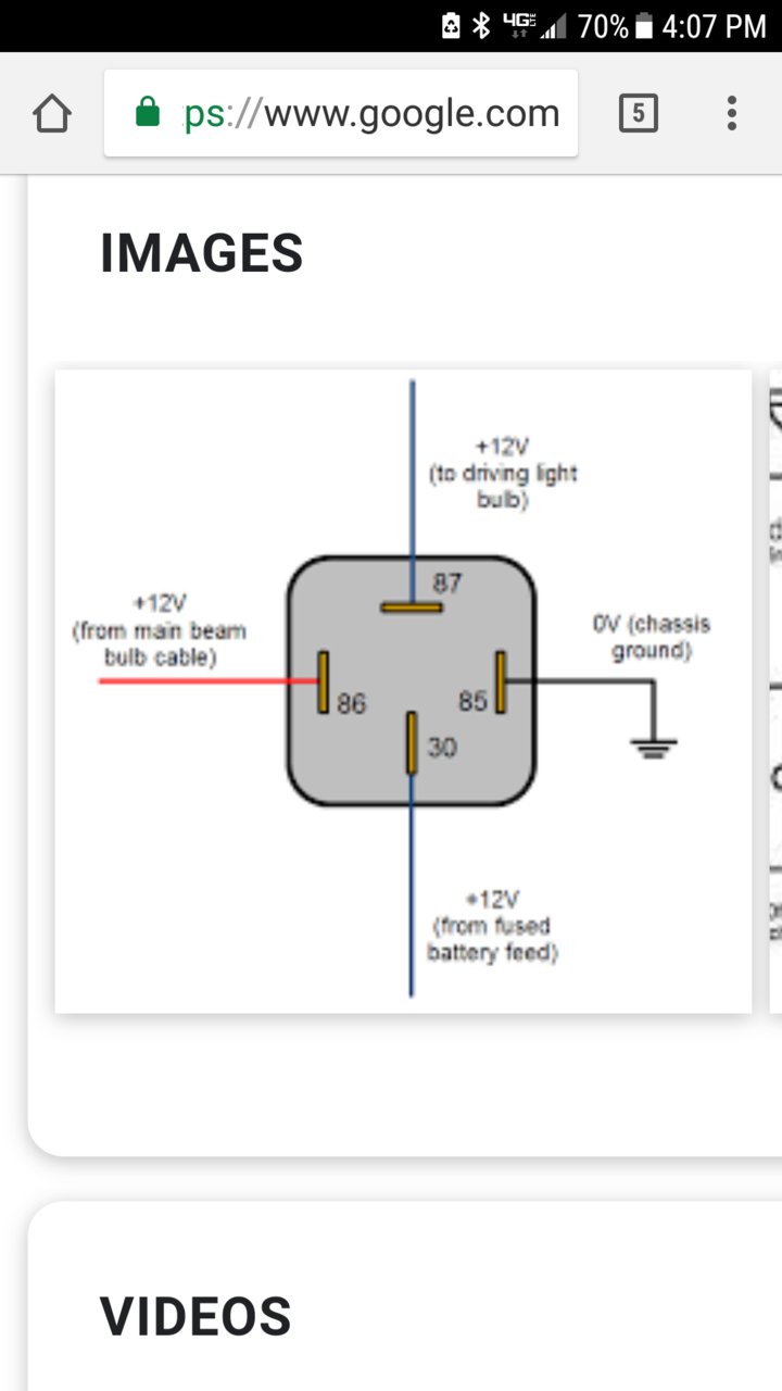

    50,708

    Pudge [OP] Super Secret Elite Member #7

    9,493

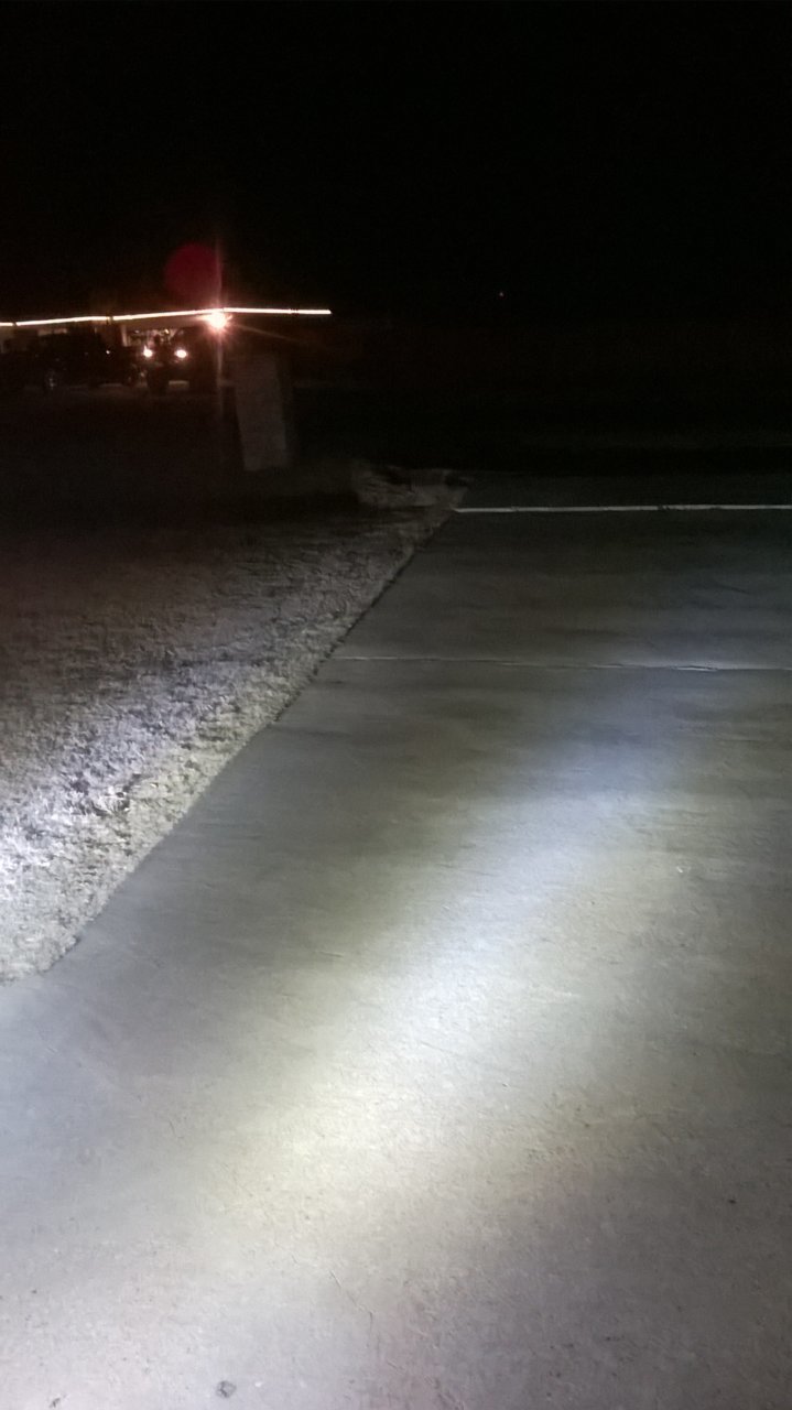

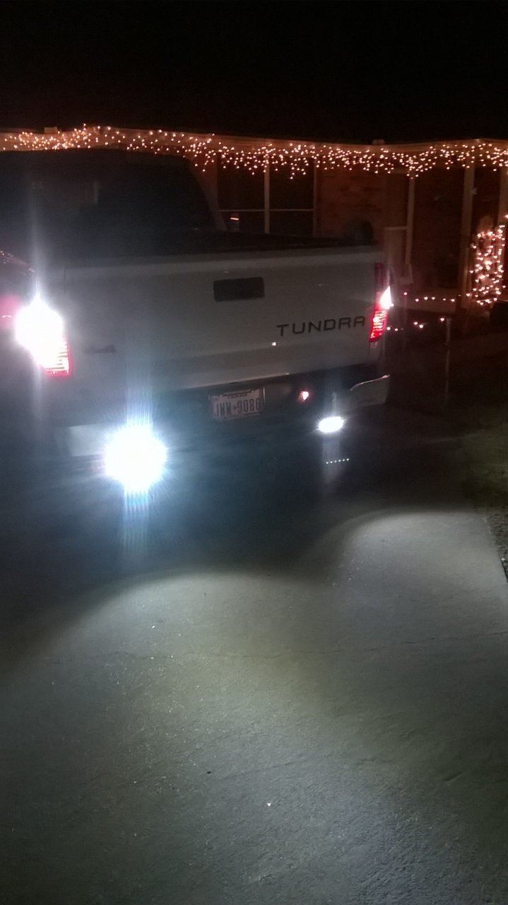

    Found the post with the output pics.
    Here are some pics, the ladder I set up is about 45' behind the truck, the fence is about 75'-80' behind the truck, the metal building is another 15" on the other side of the fence. First pic is no light, the following pics are just the led reverse lights in smoked spyder housings and the 2 - 7"led bars.

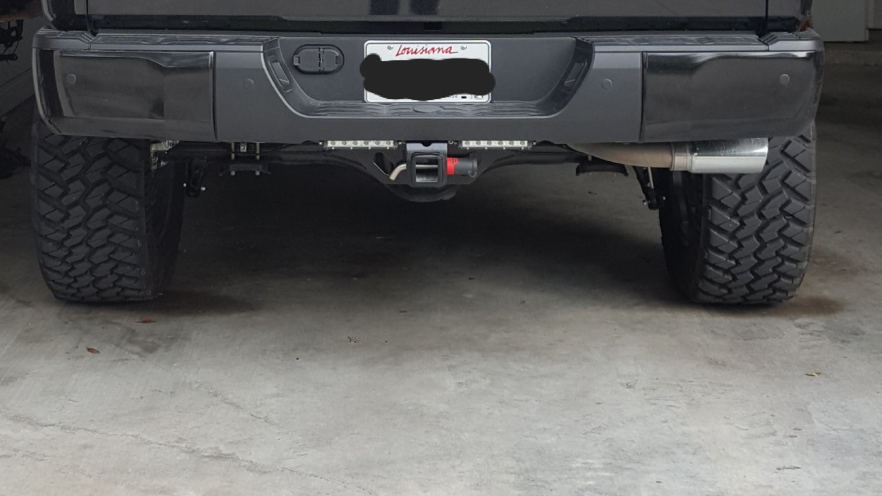

    Really hard to get pics tucked up in there like they are, these are the best pics I could get of how they are mounted. They do push the bottom of the plastic out a couple of millimeters where they touch it, but it isn't noticeable.

    For the record, I didn't use a relay, just tapped the reverse 12v on the back of the 7 pin and grounded each light up under the truck.
