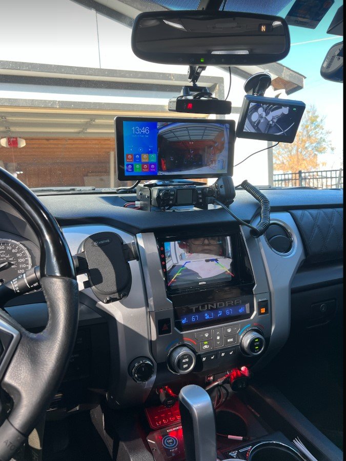

    Here's a progress pic from last weekend, only managed to get the new front cam in, clarity and framerate are very impressive and look great with the new 10.3" screen.
    Still have the front and rear cams linked to the deck.
    ignore the wireless trailer cam screen on the right, it's charging in the center console. It'll be removed once new cams are completed.
