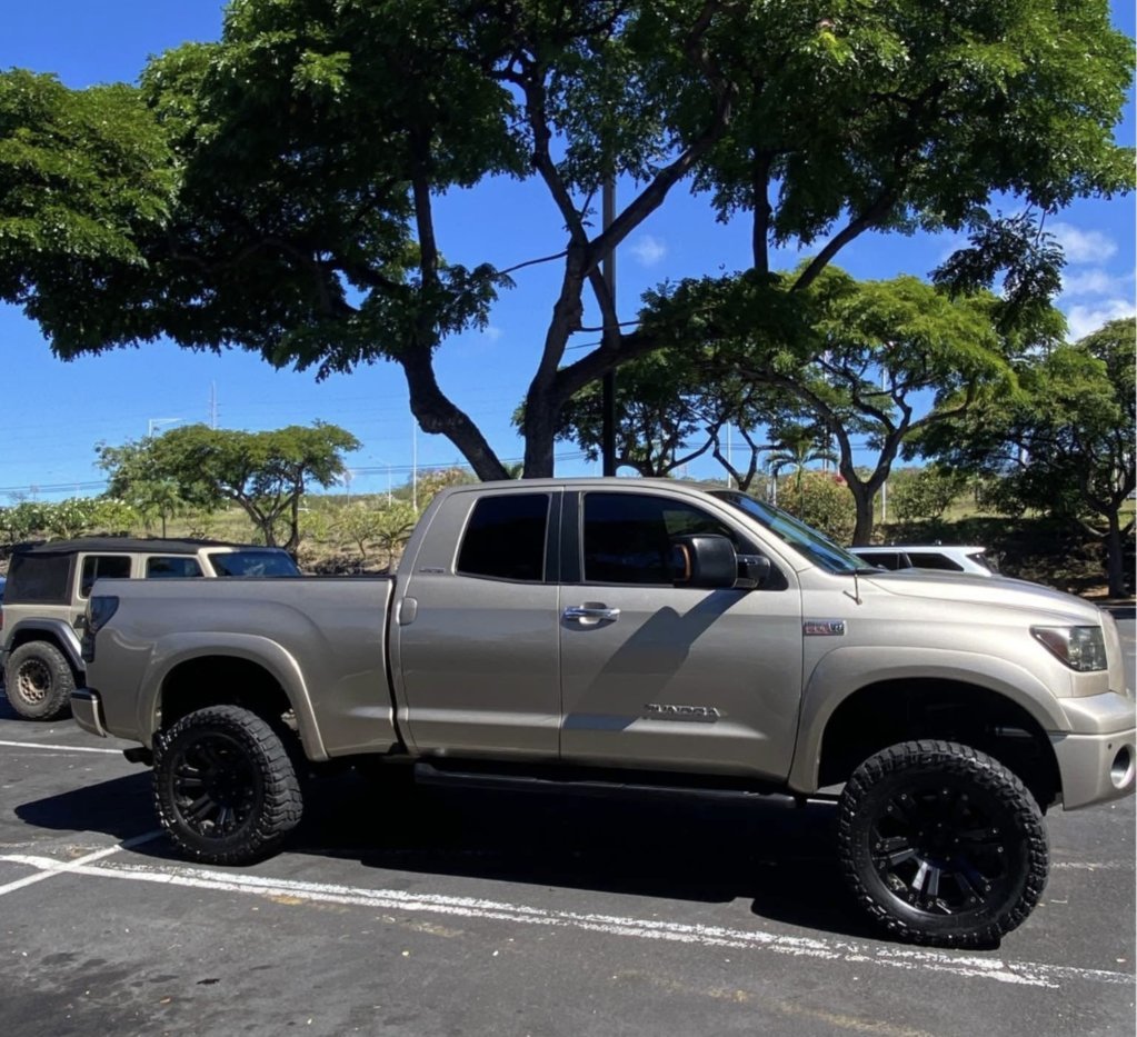

    2007 Limited Edition 4x4 Leather interior Doublecab 5.7
    Low Mileage. Immaculate all leather interior. Truck runs like a champ. No issues. 5.7liter million mile motor that has had every oil - - Tow package with tow mirrors. - King reservoir shocks front and rear - 6” Pro Comp Lift - SPC Upper Control Arms -20” Monster wheels w/35x13.50 Cooper STT Pro’s - Volant air intake - Maganaflow dual-in/ dual-out exhaust - onboard ViAir compression with tank - Kenwood upgraded audio for CarPlay, etc - Bought from original owner who has done too much to remember or list. - a few things I need help, suggestions and SUPPORT with that just need fixing
    I’ve honestly never owned a Toyota long enough to get my own 100,000 miles in it. My 2002 Tacoma has 296,000 miles and still runs perfectly.
    so why are the discussions about drain and fill transmission maintenance seldom mentioned, if at all. I’ve been searching and get no replies.
    I just bought a 2007, 4x4, 5.7 from original owner. He’s changed engine oil every 5,000 miles with Royal Purple. But was unclear about his auto trans drain and full. Isn’t the Royal Purple Max kind of a cure-all for vehicles approaching 100,000 miles even if they are NOT having any issues?
    I can’t hear enough good about Royal Purple but is it worth spending the extra money on it? Is it going to keep my perfectly maintained Tundra properly maintained? I don’t mind spending more money if it’s worth it. If I do a drain and fill now, I should be fine for at least another 50,000 IMG_0121.jpg miles with everything maintained. Is Royal purple worth it or will Valvoline or Mobile 1 give me the same protection.
    So far a 2007 Double cab with 5.7 mostly used as daily driver. Not a lot I’d heavy towing or off roading. I’m now the 2nd owner with all service records and receipts for upgrades. I just want to try my best to avoid any future or problem concerns that I should address before they ruin something. My old 2002 Taco still rungs great with 296,000 on the speedo. Thanks and I’d appreciate any feedback, good or bad.
