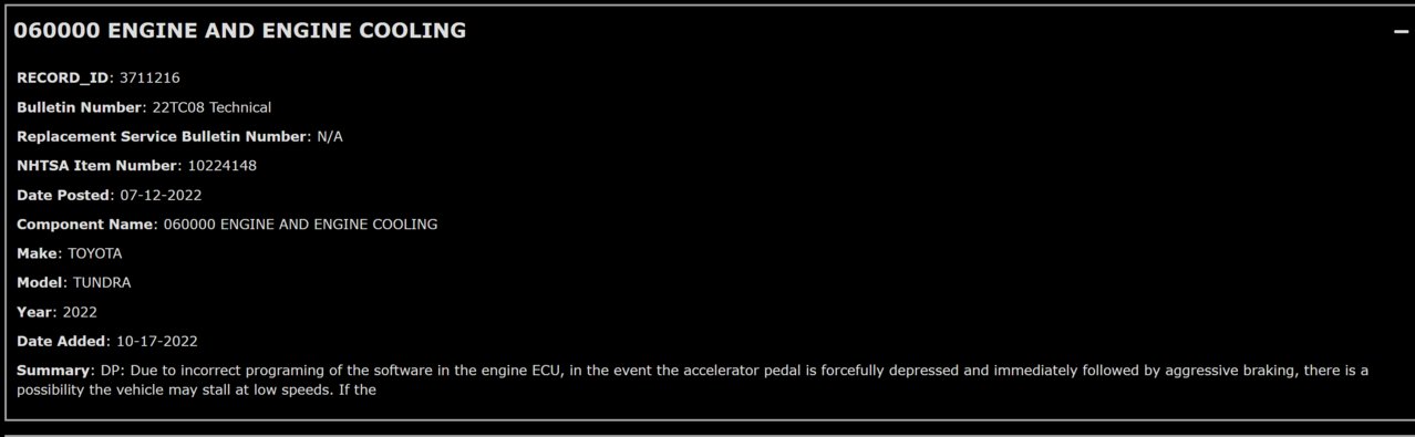

    There was a TSB software update to remedy the low idle, mine actually stalled out a few times. It didn't take aggressive braking for mine to die.upload_2023-3-27_12-55-58.jpg
