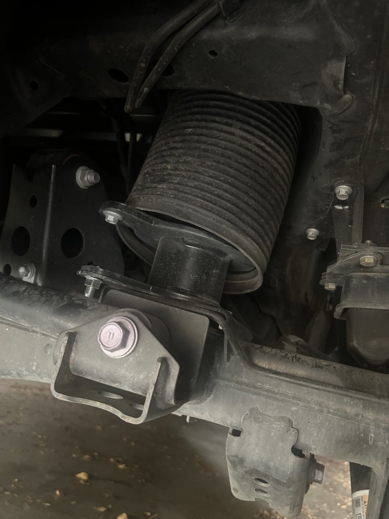

    I have a 2022 platinum with the advanced package which I believe also means that it has auto leveling. I have also installed a 3” lift kit. Does the lift kit affect the auto leveling feature. For some reason I do not believe the auto leveling is working since the lift kit was installed. Thanks in advance.

    What makes you think that?
    Who installed it?
    Post a pic of the rear axle where the air bags/coil springs are at

    Because I hauled some lumber and the rear was lower than the front and normally it is not.

    It looks like you're almost riding on the bump stops. Was this picture take with the truck running?
    Can you take a picture of the adjuster arms? You definitely have a lift kit but I don't see the adjuster levers that also would need modifying.
