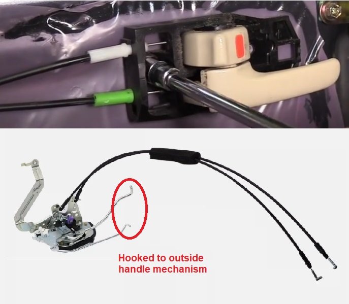

    The door actuator @Shifty mentioned above is what you're needing to look into IMHO.
    Either the actuator or actuator motor is dying a slow death or the 2 rods that affect the outside door handle need attention or the cable that affects the door button needs attention.
    As seen in pic below, the white tipped cable at door button is what moves the lock/unlock button.
    In any case, removing the door card for better inspection is where I feel you are.
    Plenty of you tubes in how to accomplish all that and can offer unless you find one your self.
    accuator.jpgvideo but
    This is an 04 Tundra but should be very much similar to your 03.
