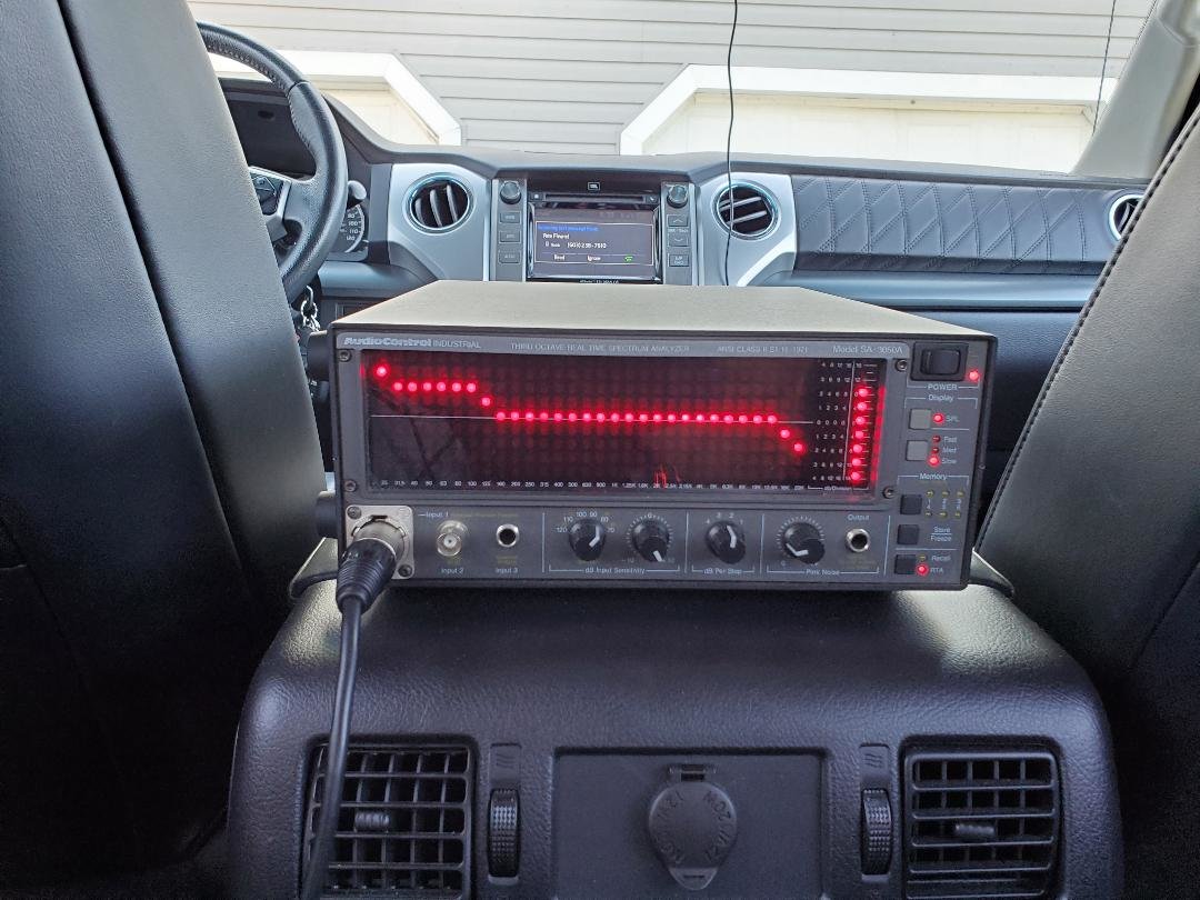

    I firmly believe step one should be to correct the shitty stock signal. The OE headunit both attenuates power at certain levels and is impossible to get an actual flat output out of. There's no way the "3 band EQ" that it has will address this issue. Currently I'm building my system, so far I've installed both aluminum/butyl sheeting and CCF on the doors and back wall. I've also changed the HU. Replacing it made a huge difference. I've owned a 3rd gen Taco, 5th gen 4Runner and now the Tundra. The HU in conjunction with the stock amp has produced a clean signal that matches the power output of most 50W amps I've heard. Its considerably better than all the other Toyotas Ive driven after replacing headunits. Entirely due to the fact the Tundra already has a small amp in line. After sealing the door openings it produces enough bass SPL to be comparable to the JBL system with its tiny sub. All on stock speakers. Having heard the JBL and base stereos I actually feel a HU replacement on the base system sounds better than the JBL in its stock format.
    Replacing the speakers without a more powerful amp will usually result in a loss of volume and dynamics, the large magnets, stiffer suspension, etc all really need more power to get any quality out of it. I already have my speakers ready to go, Morel Virtus 602s for the front and Dayton 6.5s for the rear. I dont have my DSP amp in yet though and just on a whim I put one of the Daytons in on one side in the rear. The stocks handily out performed it in bass production, theyre just simply lighter and easier to drive. Once I've got the amp in it would be a whole different story, but without going that route the stock speakers in the Tundra are actually quite decent for SPL purposes, once you have a quality signal going to them.
    As far as the belief the stock unit isnt garbage, I've run DSPs with the stock Toyota HUs. There are very clear and traceable cuts being made, once the volume is >50% the lower frequencies begin to plateau in SPL measured. The signal to the front and rear needs to be summed usually due to it not being the same and resulting in peaks and valleys in seen on the RTA. Without actually using tuning equipment that statement is just a feeling, there are traceable issues that can be improved. Options are cheap with a HU or better but more $$ with DSP and tuning.

    Actually the factory JBL head unit is not bad to work with and will provide a nice RTA flat curve when using a good processor.

    Yes, as it should. Main point there is in line with mine, sound processing is key to a quality signal and sound. As I said, either cheap with a HU or a bit more freedom and perhaps cost with a DSP. In its stock form the OE HU is one of the biggest limiting factors for quality. Especially when you begin to price out the cost of each component. HU totals can range from 350+ to fully install one. Decent front channels would really need additional power and then you could easily be looking at close to the same price but likely more, all while still having your hands tied in terms of getting their full potential with a sub par input.
