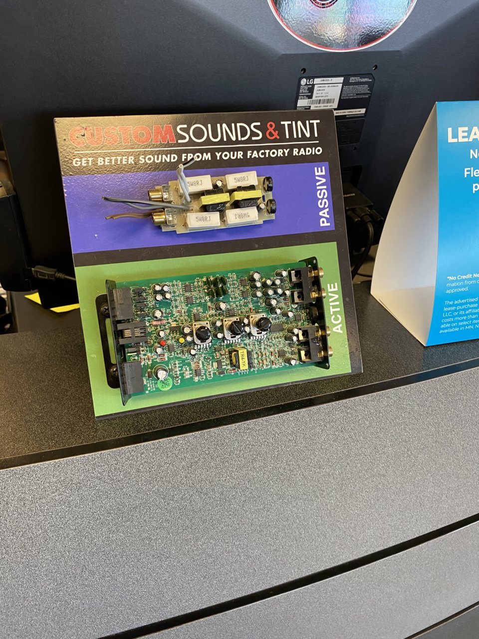

    Yes I did, but I had one of those after market filters installed

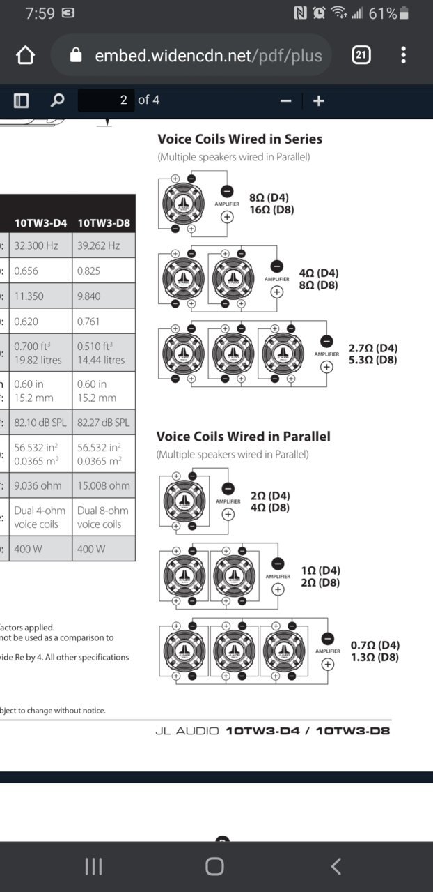

    Screenshot_20210129-195957_Chrome.jpgThis is from JL if these are the subs you have

    You have jl10tw3d4? And that "filter" I bet is the cause of your problems
    Saltyhero13 likes this.

    OK. After looking it up, these particular subs are either DVC 2ohm, or DVC 4ohm subs. Which are they because it matters a little? It also matters how the second voice coil on each sub is wired. It looks like whether they are 2 or 4 ohm, if wired properly, they should work with the amp; 700watts @4 ohms and 1000watts @ 2 ohms. You were right wiring them at 2ohms. Both 4 and 2 ohm subs have a RMS of 150 watts to 500 watts, so they will work in either configuration, but at 4 ohms they would be close to the minimum wattage which is far from optimum if pushed. My guess is the wiring is the problem. The thing is, with DVC subs, you have more options when it comes to wiring, so when it gets sorted out, I think you will have a good sounding system. With three subs you will have more bass than you know what to do with:rasta:

    i would also ditch that "filter" and buy something with industry standing, i ran audiocontrol LCs with epicenters in other vehicles. youll want that bass knob with 3 w8s.

    If you’re using the factory head unit, you will never get those subs to sound like they should unless you get a really good DSP. I have the same subs in my truck and used the factory head unit for awhile with a JL fix86 and it still wasn’t that great even combined with a JL vxi amp with built in DSP. I hand to ditch the head unit and fix86 and go aftermarket head unit to get the sound I wanted and now the 10tw3s are at their potential.
