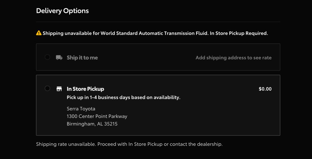

    Apparently Serra wont ship WS and Andersen wants $56 to ship.

  18. Sep 9, 2025 at 7:59 PM
    tundras00
    tundras00 [OP] New Member
    Apr 13, 2018
    #14429
    538
    Yep

    Nevermind. I didn't scroll all the way down when checking out to see the total with Andersen. Serra doesn't do sales tax for me, that's why I try with them first.
