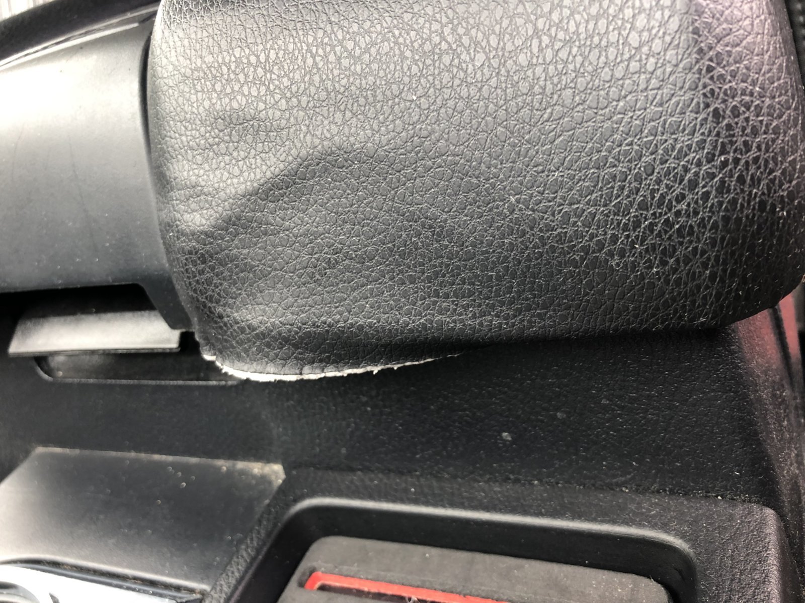

    Have any of you on here have had issues with their armrest peeling? About a year ago mine started peeling in the front right by where the handle is to release and open. Now it's about 2" long. It seems like the leather was cut short and therefore during use, it broke free is peeling back. 2020 with 64K miles.
    I'll get a picture uploaded this afternoon when I head out on lunch.

    Pic as promised

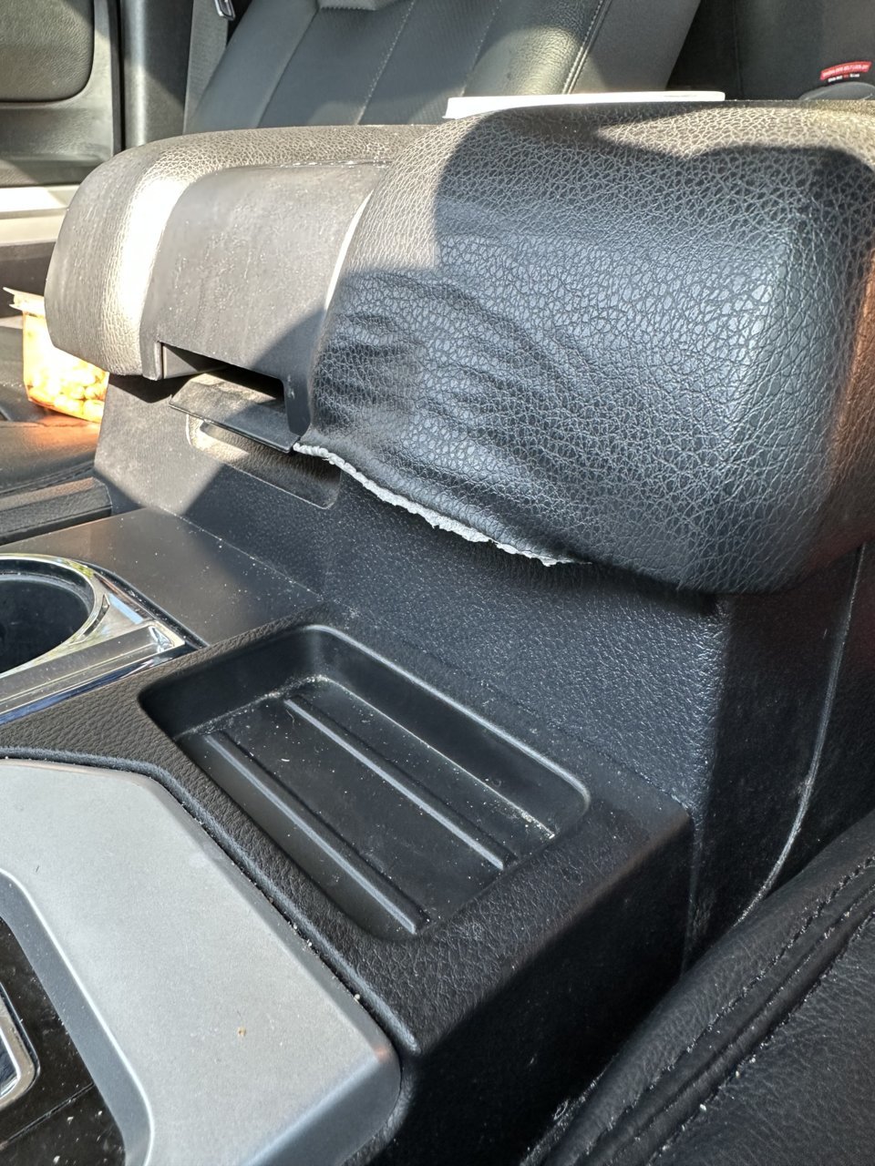

    @Jaypown - Did you try to fix on your own? I just noticed a similar issue on my '21 and I'm trying to figure out the best path forward to repair/replace.

    I took things apart and used some super glue to try to repair things. We will see how long it lasts. Managed to only lose one of the tiny screws holding things together...
