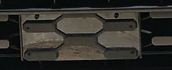

    This post has been a long time coming but I was strung along for months which is why it has taken me so long to post it.
    The main reason I no longer recommend this is because I have been having random "Apply Breaks Now" Warnings pop up. It has not happened a lot but compared to the year before when i never had that happen, one time is to many. (Its happened more then ones though). You will be driving along and then it starts beeping at your and says apply breaks now on the screen. It has never applied the breaks for me which would be the next step but if that happened in the wrong situation it could be catastrophic. If you are driving down the road with cars behind you and nothing in front of you and your truck decided to slam on the breaks for no reason there is a very good chance you will be part of an accident.
    While using adaptive cruse control it also seems to break more often when going around a corner and someone else is in the other lane but no one is in front of you. Again this is not something that happened with my old set up.
    Those are the main reasons why I no longer recommend this product. On top of those reasons about the product itself there are major issues with the company and how it is run. When you buy something you want to be sure that the company that you are spending your hard earned money with is going to stand behind the product which is not the case here. I see that ARES is no longer a member here but is still selling these on EBAY and i saw other members asking about his product. In the 3 months that he was selling them here they went on and off sale about 4 times and the price changed just as many times. One week they would be $120 then the next week they would be over $200 and then back to $180. Currently they are $140 so if you bought it for anything over $140 you got screwed. I paid $108 (info on where the $8 came from later in the story) so that's not a problem for me.
    Ares Did send me version 2 for no charge when my version one broke apart so that was good but the rest of the transaction was one lie after another. I was one of the first to buy the product on August 17th and was told it would go out early next week. On the following Tuesday i asked if he had sent it out so i could install it that weekend (and since it was early next week). He said it is going out in the morning and i would have it by Friday. On Thursday i get a message asking me what grille was installing. I told him again (it was all in my paypal payment.) and he said it would be there by Saturday. Later that night i got a message that even though i sent him the info again he sent me the wrong one could i send it to another customer of his and he would send me the correct one Wednesday. It came in the mail Monday and i turned it around to his customer on Tuesday and sent him a receipt with my PayPal address figuring he would pay for his mistake. I was wrong. On Saturday i messaged him and asked if it had gone out yet because i had not received it and he said it had not. It finally shipped the following Tuesday (September 1st).
    I received it on the 4th and on the 6th i messaged him with photos of it cracking. He was accommodating and said he was going to send a new one. He sent it out on the 17th and i installed and reviewed it on the 19th. I at the time was happy with it (because the break now errors had not happened yet) but had listed some cosmetic issues or things i would change in my review. That day (September 19th) he messaged me and said thanks and he was going to be implementing my changes and send me a new one. He said he would send it out tomorrow or Saturday. We talked via PM multiple times with me taking photos for him of the 2 versions on my truck and what i thought of versions he was making. After that i messaged him a couple times to check in and on October 14th he finally responded and asked me which version i liked better even though i already told him back in September. He said he would get me the new shield out tomorrow. October 31st i asked if it was sent yet and he said he was waiting on the new design so i could review it. I have never received the new version and i emailed him via ebay and asked about it and he said he was not going to send me one even though it was his idea.
    I dont care about the new version since i most likely will go to OEM. I waited to post anything about the sensor issues to give him the benefit of the doubt that it would be fixed/work in version 3. Version 3 might work great but just know for your (insert today's price of the product here) you are going to get something that may or may not work that will be shipped to you when he gets around to it, maybe.
