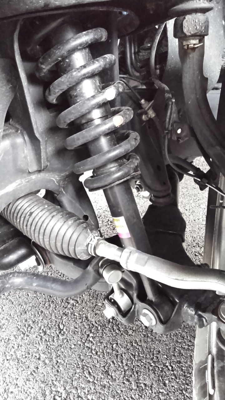

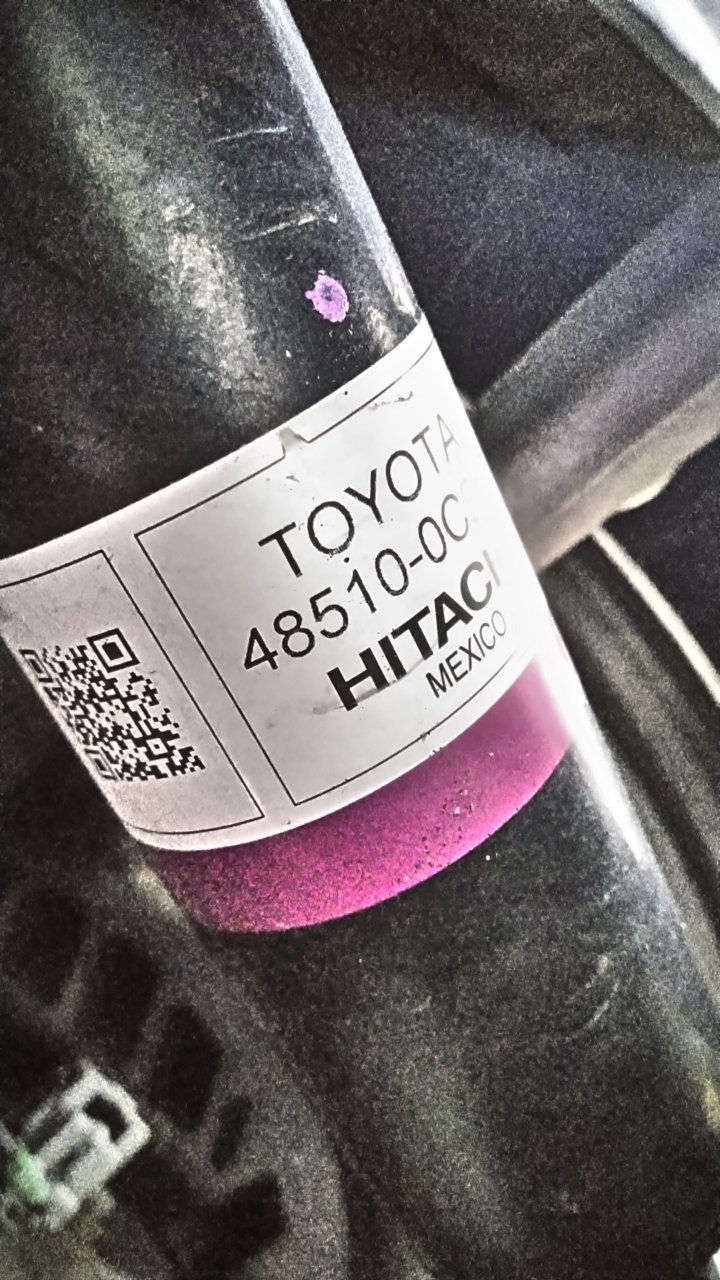

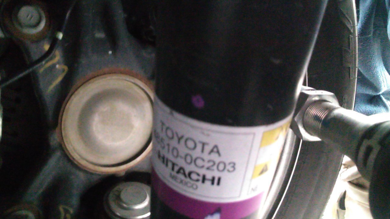

    I have a 2021 base model 2wd. I'll look for stickers and take pics when I get to work.

    Driver side: 48510-0C203

    Perfect! Thanks a ton! I found a "new" set of takeoffs" for 100 bucks.

    YES!! they fit and work perfectly, now for 1000 miles. And they came off of a 2020 FOUR wheel drive. (non TRD)
