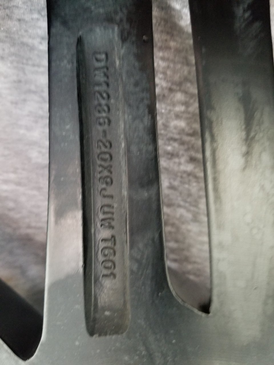

    I believe these rims are 20x9 with a +50 offset but correct me if I am wrong. What is the largest tire I ran run on these rims? I am planning of getting a 6" lift here soon and hoping I can run with these rims for 35s before I upgrade my rims. Any info would be more than helpful.

    The only thing throwing me off is the +50 but I have some 35x12.5 18 tires on my truck until my new set up but must wheels where 18x9 with 0 offset

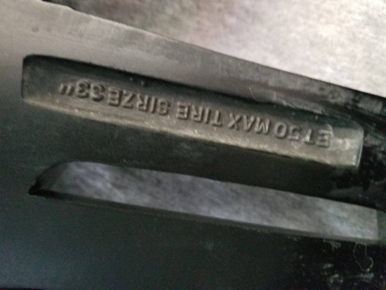

    On the back of 1 of the spokes on the rim it's stamped nothing bigger than 33".

    On a 6" lift the +50 will have your wheels and tires looking tall and skinny. You can run 35s on 3" lift. 37s with trimming as some are now doing

    Also it will say somewhere back there if it’s an 8 or a 9. Plus the dealer should be able to tell you the size and offset.
