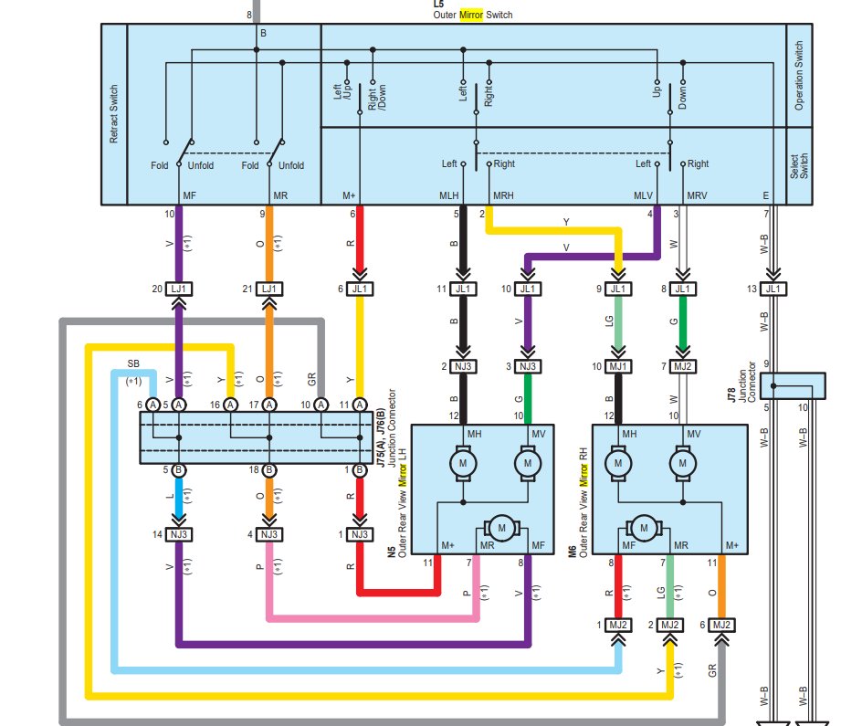

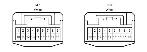

    To see if you have existing wiring, you can test your mirror plugs with a DMM and see if they have wiring and/or a feed.
    M6 (right) and N5 (left) are your mirror plugs.
    You'll need to pull the door panel.

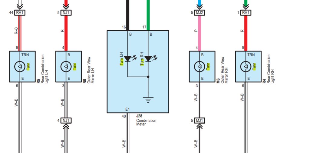

    Turn signal wires and pins
    Left
    Pin 4 red wire hot
    Pin 3 white wire w/ black stripe ground
    Right
    Pin 4 pink wire hot

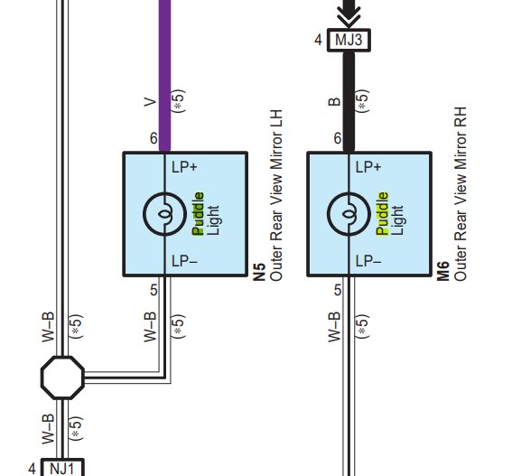

    Puddle lights
    Left
    Pin 6 violet wire hot
    Pin 5 white wire w/ black stripe ground
    Right
    Pin 6 black wire hot
    Power fold AKA retract
    *1 notes retract motor
    Left
    Pin 7 pink
    Pin 8 violet
    Right
    Pin 7 lime green
    Pin 8 red
