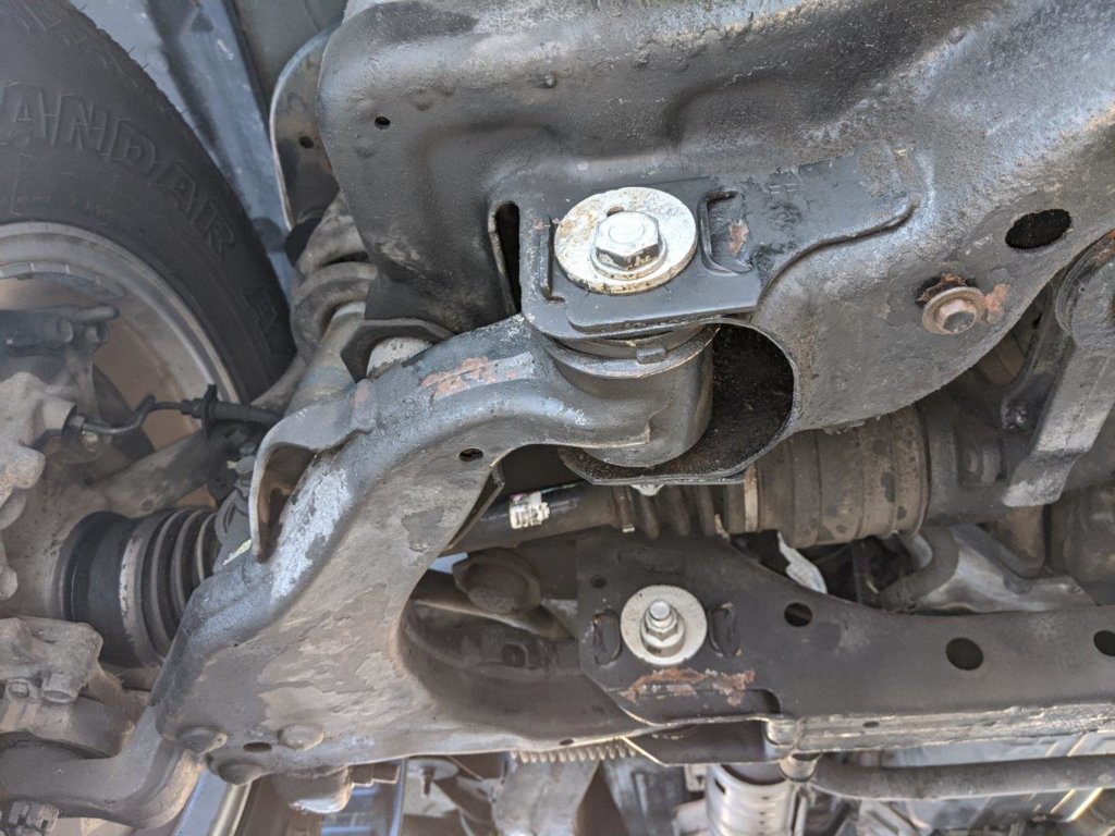

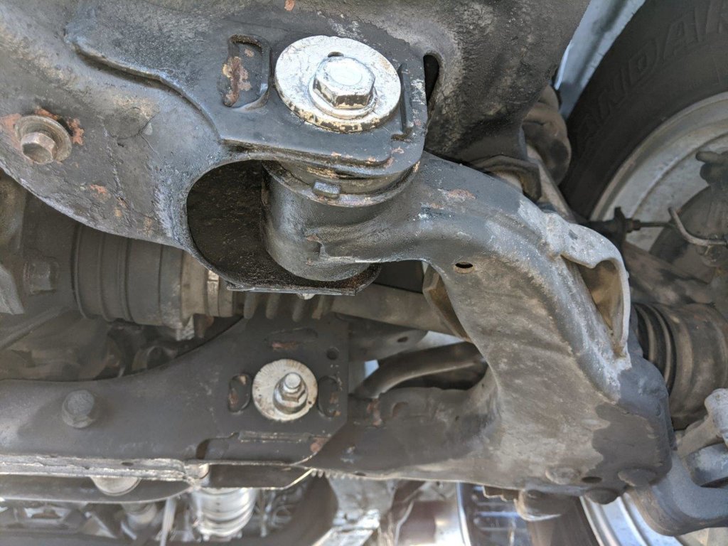

Are my LCA bushings shot? I think I know the answer. What to do with them?

    That’s a lot of play on drivers side. Passenger wasn’t horrible, but still some. Replacing the LCA is usually the route people go. Buy one that comes with bushings installed, or buy one raw and install the bushings of choice (likely better solution). Otherwise, get the torch out.

    I figured it was time to replace them.
    I'm definitely going with OEM adjustment cams and bolts. Also going to go with the complete arms. Not interested in replacing the bushings only. Too much work.
    Probable going to go with OEM arms but will wait to hear about the Moog and Delphi. Truck is only driven about 2500 miles a year.

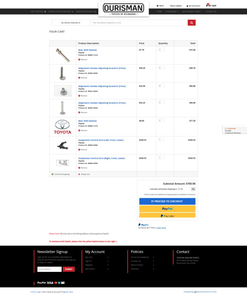

    Looks like the cheapest price on all OEM parts is $700 + $50 shipping at Ourisman Toyota of Richmond.

    Possibly if they have a sale going on. My typical dealer in AL was able to get to $520 out the door, no tax, free ship on the arms. If there was a sale going on, like the 25% sale that just ended 7-10 days ago, coulda got that closer to $390 shipped for the pair.
    Looks like your part numbers would be 48069-34040 (driver) and 48068-34040 (pass).

    This is Ourisman.

    Where are they shaking out after shipping and tax?
    You may want to run the numbers through https://autoparts.serratoyota.com and see if they can beat the after-tax + ship price.

    Probably close to $800. I run them through that site. Thanks.

    A bit more on price and shipping. Doesn't include the 6% tax. I need a sale.

    Go to Checkout and they'll take the shipping off in the checkout area. Should come out around $645 if my math is right. If they don't take off shipping, in the Checkout window, apply promo code FREESHIP.
    Just looking to save you $50.

    Thank you Shifty for the Serra suggestion. Just ordered the LCA's and a few other things.Tundra 095.jpg Tundra 094.jpg
    I held off on the hardware. After cleaning the area I'm hoping they will come out and be fine. We'll see?
    I didn't want to wait for a sale because I need to install the OEM LBJ's and reboot the axles with OEM boots. Great weather right now but winter is coming and I have to work outside in the driveway.

    You can generally reuse the bolt and rear adjustment CAM nut. The CAM sleeve will almost always need to be replaced due to corrosion.
