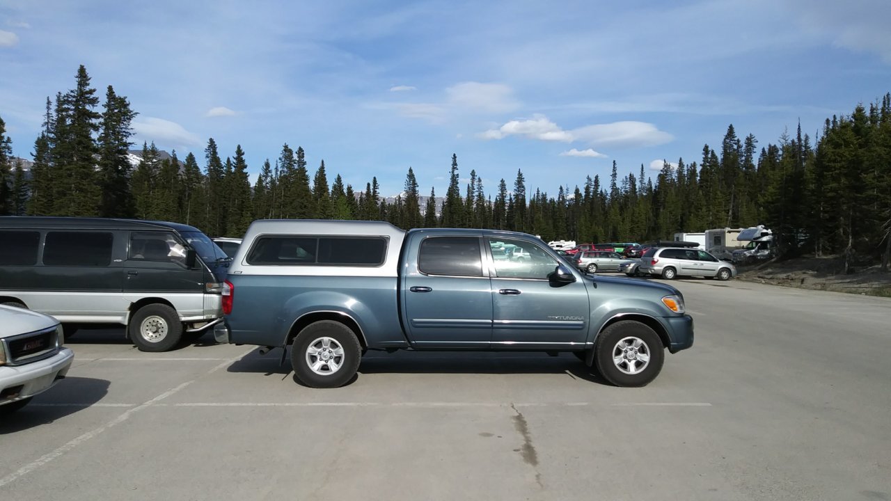

    Good points about measurements. The after measurement was taken right away at the same location. After driving on it for a day it settled down almost 1/2". Also worth mentioning that I have a shell over the truck bed with no additional leaf spring support yet. That could be making the whole thing sag backward.
    My cardinal sin with the whole situation is I never got a picture of the truck with the new springs before I took them off so I could actually commute to work. The camber was super off and I didn't want to get an alignment if I wasn't keeping the springs. But here's a photo before the lift, loaded down with camping gear and kids.

    Oh, so you put the old set back in? Thats a good move.
    To properly run the kind of lift you describe it is better to have aftermarket upper control arms. You can get by on stock ones for a while if your upper ball joints are in good shape, but the suspension wouldn't cycle well. I would look into maybe SPC or even the newer JBA upper arms.
