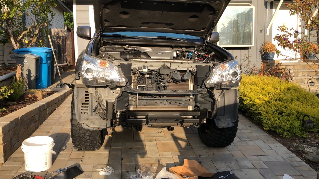

    Jimes [OP] New Member
    Nov 27, 2014
    #764
    949
    Bay Area, California
    2015 toyota tundra trd pro
