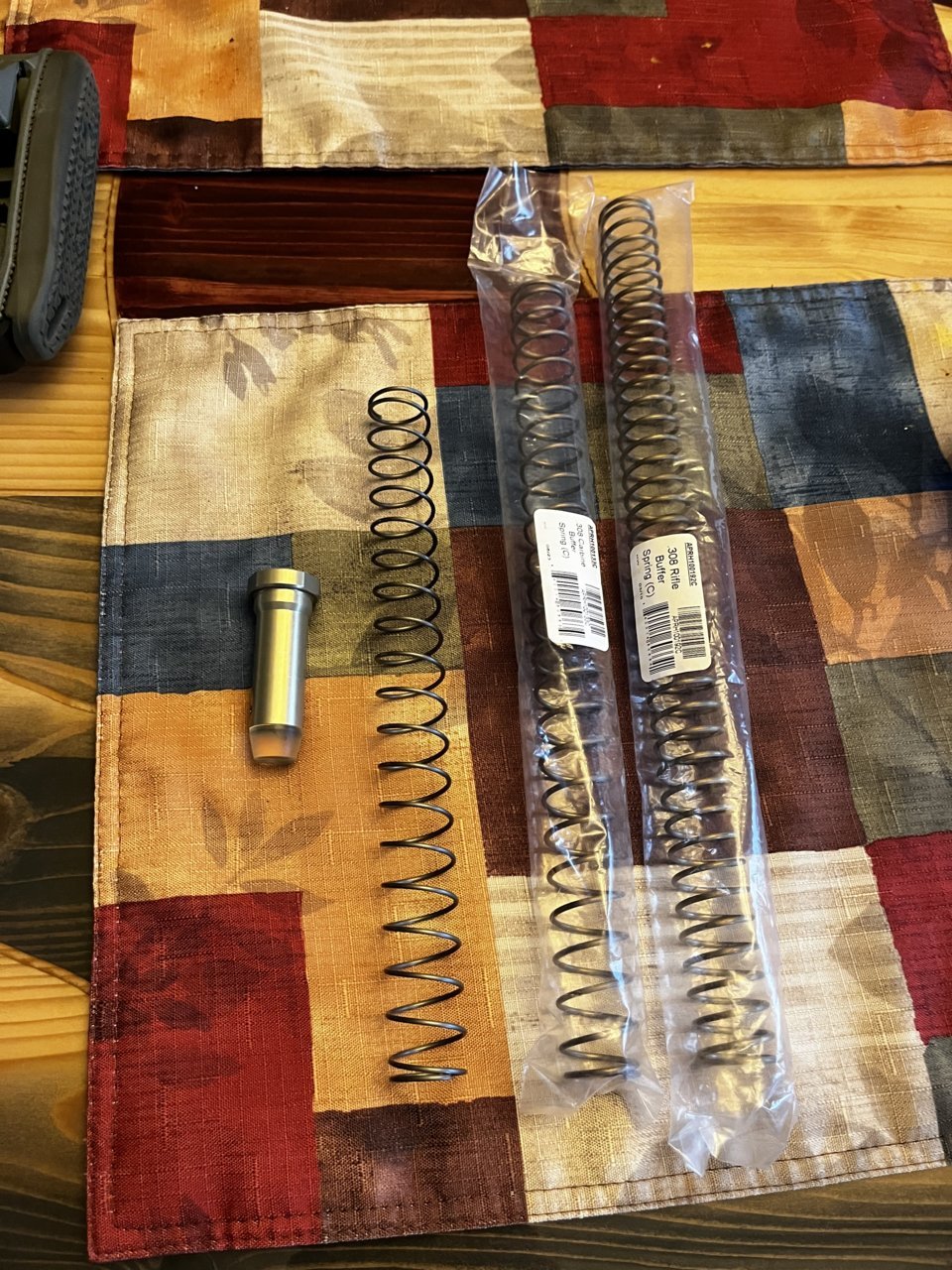

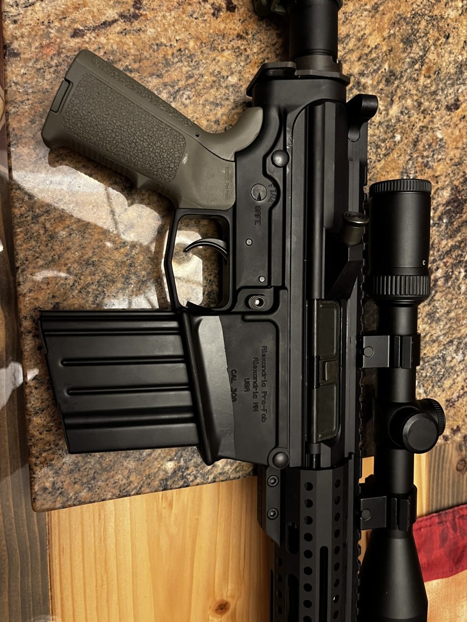

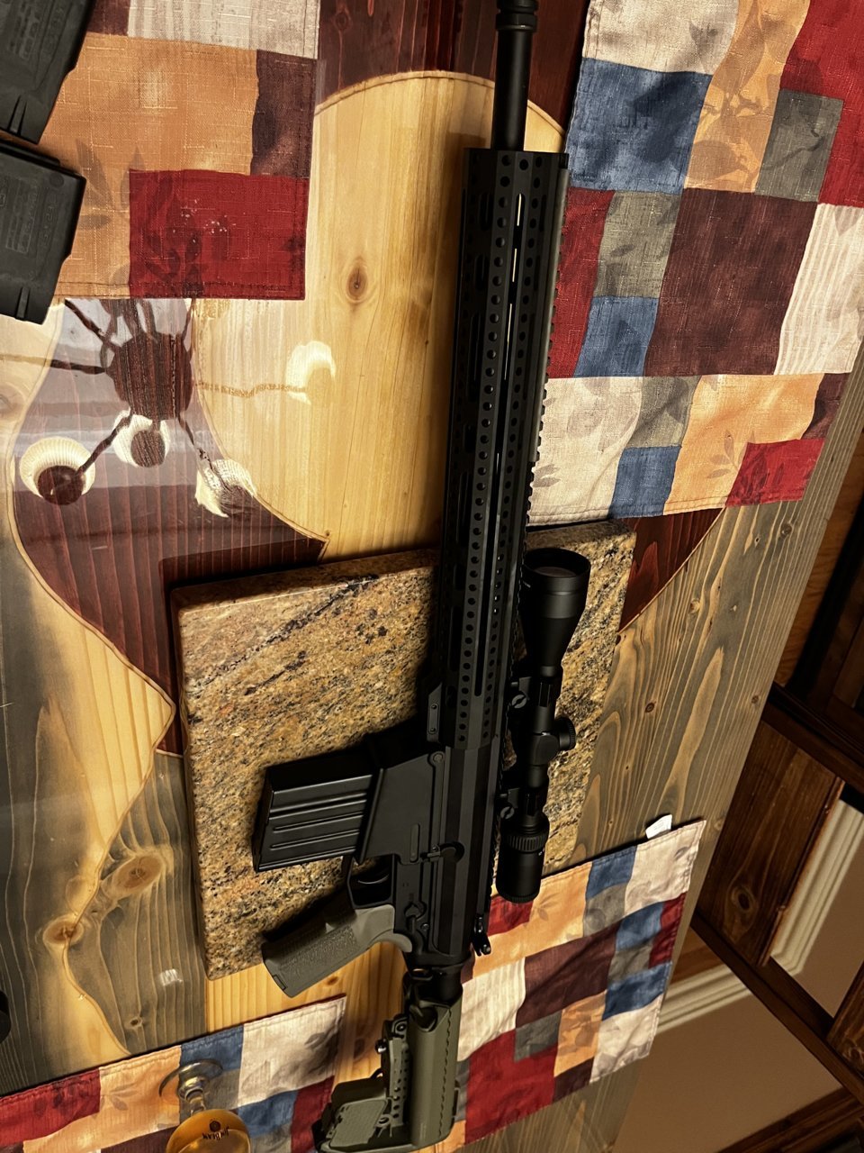

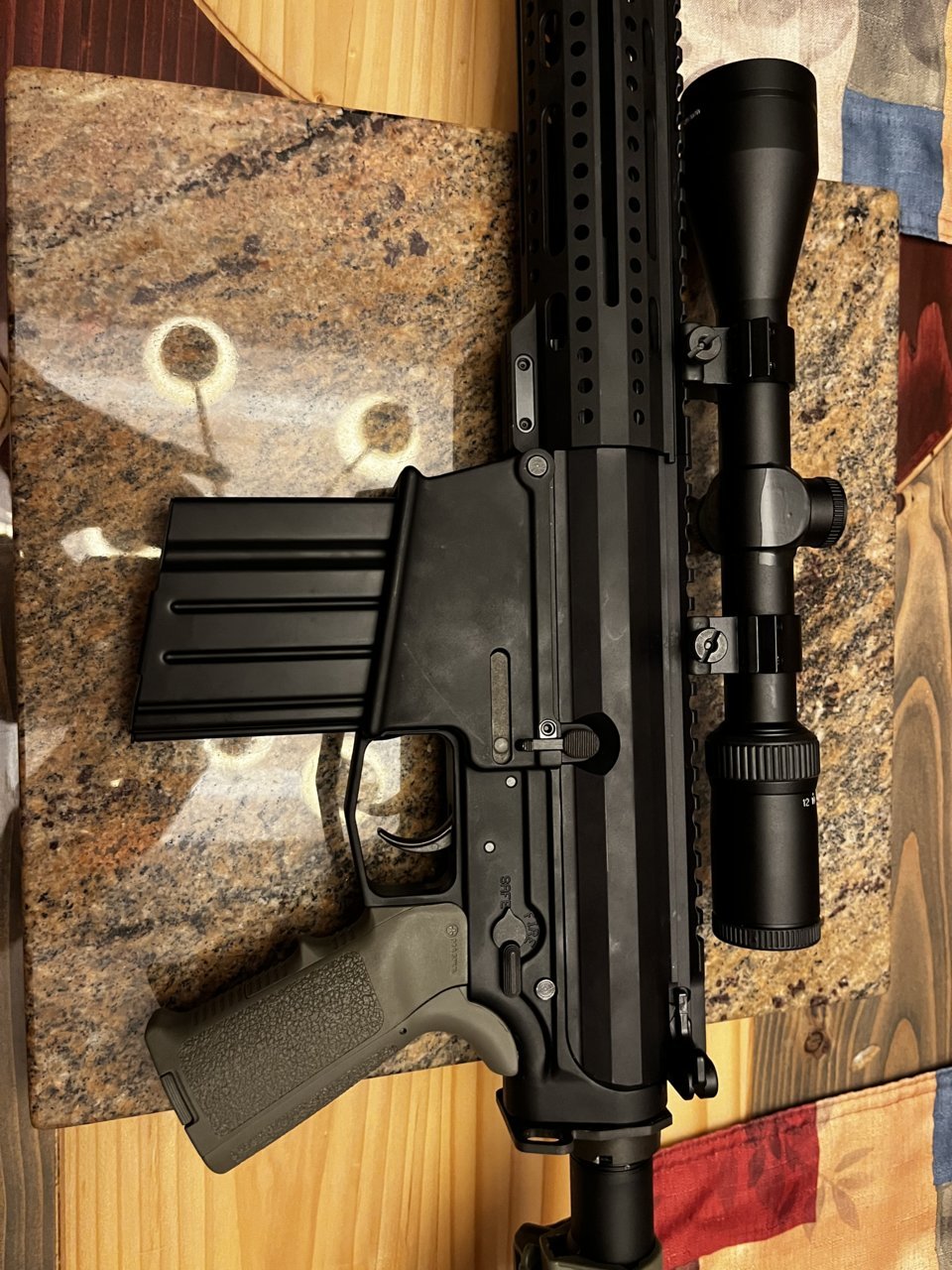

    Problem:
    Damn BCG would not go into battery. Sometimes it would, but 90% of the time it would be a one fire and done. Now I realize that a new weapon might malfunction a bit in the break in period, but this was over the top.
    I had a guy that I served with in the navy in TX. His son is a Marine and builds many different platforms for his local LEOs. So to say he is knowledgeable is an understatement at 22 years old. Just so happened that his son was wanting a break from the Texas oven temp’s, so he drove up to assist.
    - I had already checked the BCG, gas rings, o-ring…everything was good.
    -Tried different magazines thinking one was faulty. Nope. At least I have plenty of spare mags now. :rofl:
    -checked my gas block and tube. Good there. Hell, even removed the gas tube to eliminate the chance it was hitting the gas key.
    - My friends kid came over, we totally broke down the weapon except the buffer/spring. I mean, what’s the chances some dumbass would install a AR-15 spring? We went through it all and just couldn’t make it work.
    - He left and then I got a package on my gate. He sent me a few different springs since this is the last thing we didn’t check or change out.
    Well the chances in this case are pretty high. Left to right: buffer, ar-15 spring, AR-10 carbine spring, and AR-10 Rifle spring.
    I installed that AR-10 Carbine spring in and what do you know…cycles and goes into battery like it’s supposed to. Now to dial it in to around 200+ yards.
    Moral to the story…
    Don’t trust anyone buying gun parts and that they are correct.

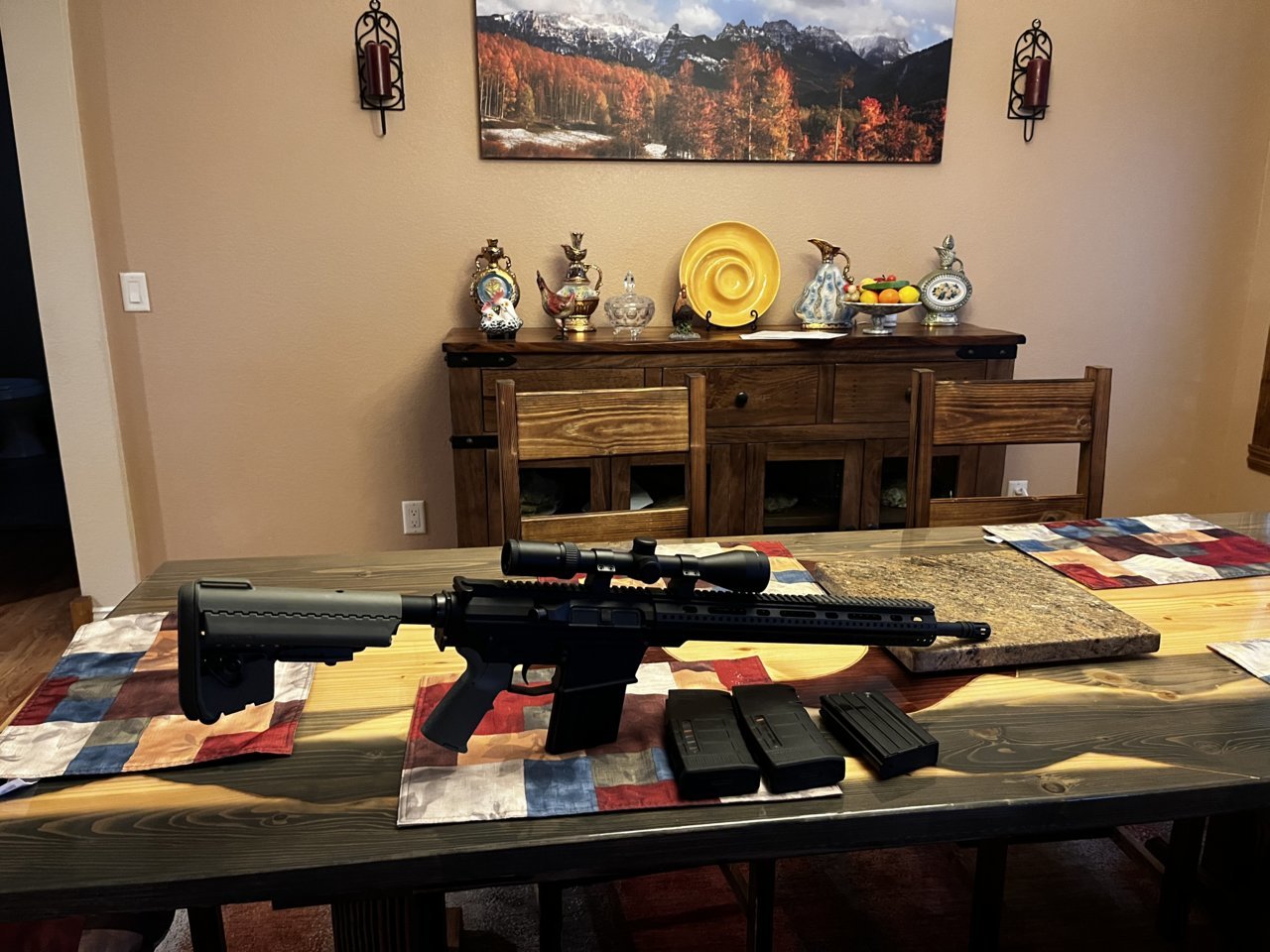

    8D137D61-15C4-4854-96CD-8B8A0DF5D958.jpg 00D98572-DFE0-439F-BDD5-4B847A19947F.jpg E8AA2013-DB0B-419A-8765-7B009F579F05.jpg B42D318C-62DE-4D1D-BC93-EDC47E8B7111.jpg
    It needs a bi-pod. My 13 year old can’t even hold it up while standing. It’s a heavy boy. I handed it to her and she said “dad, I have to sit down for this one..”

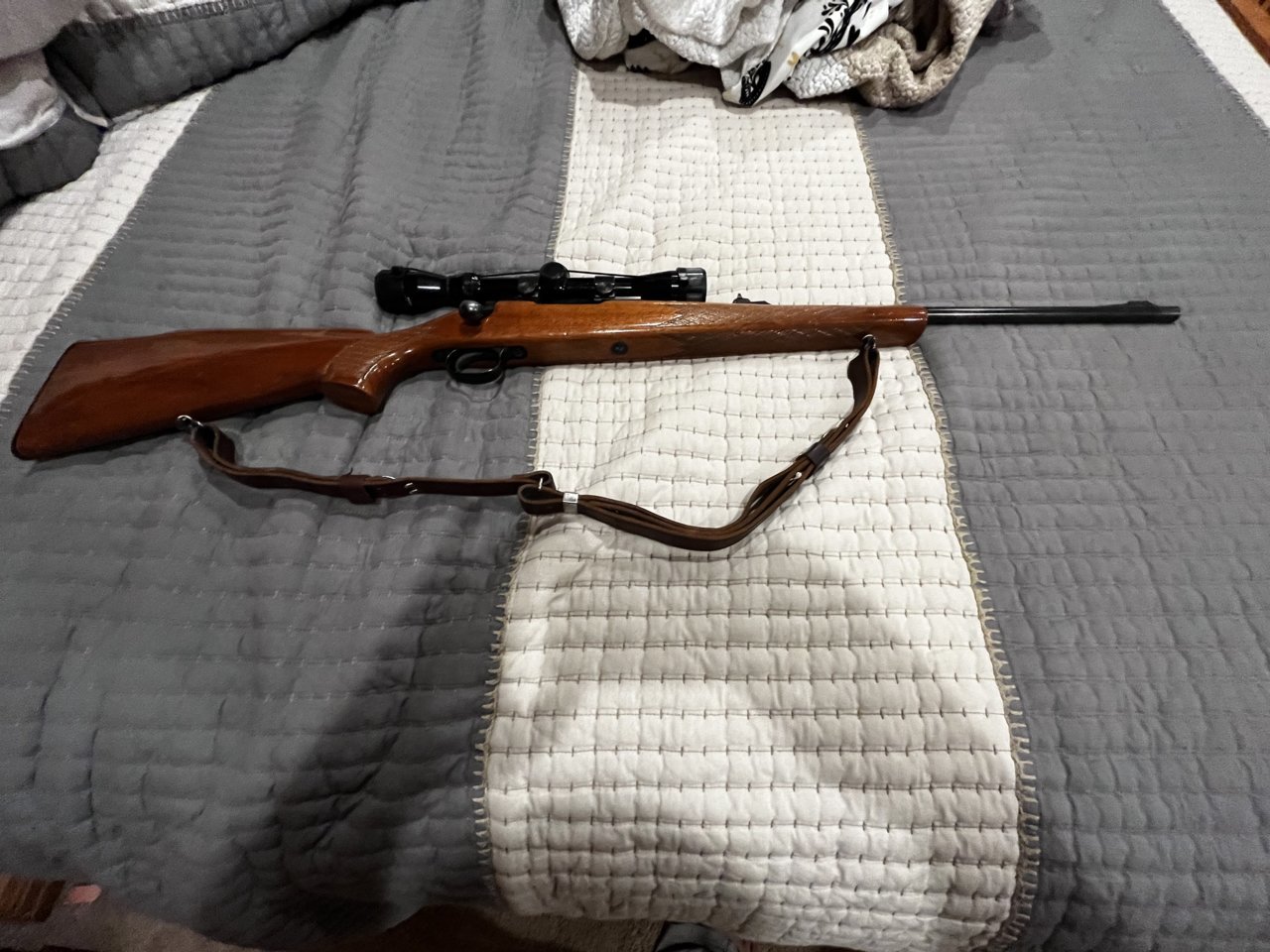

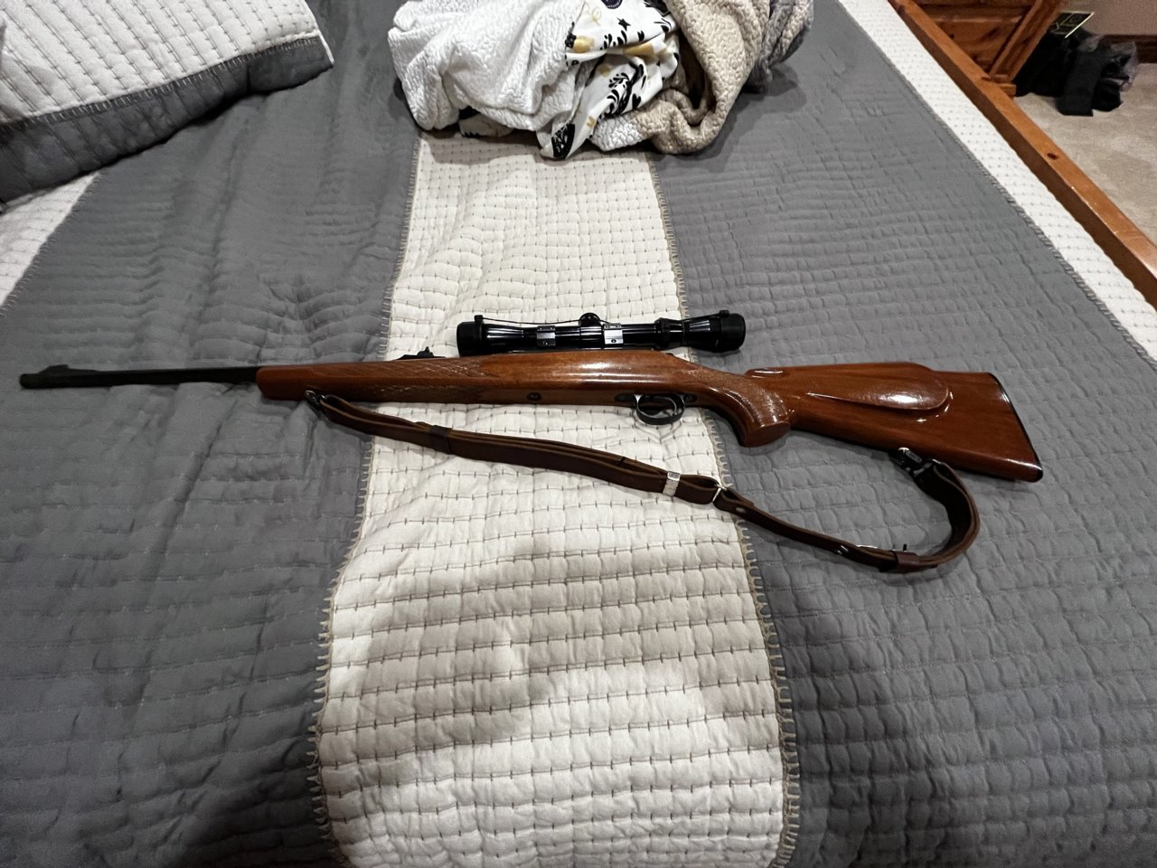

    The .243 is a great all around rifle for
    youths. I used mine on the last Montana hunt at 18 years old. I started using this rifle 32 years ago.
    70F289EB-9417-4B97-B57C-5A3C79468CA0.jpg ED77FC15-276A-45EC-AD36-68B94FDB10C6.jpg
