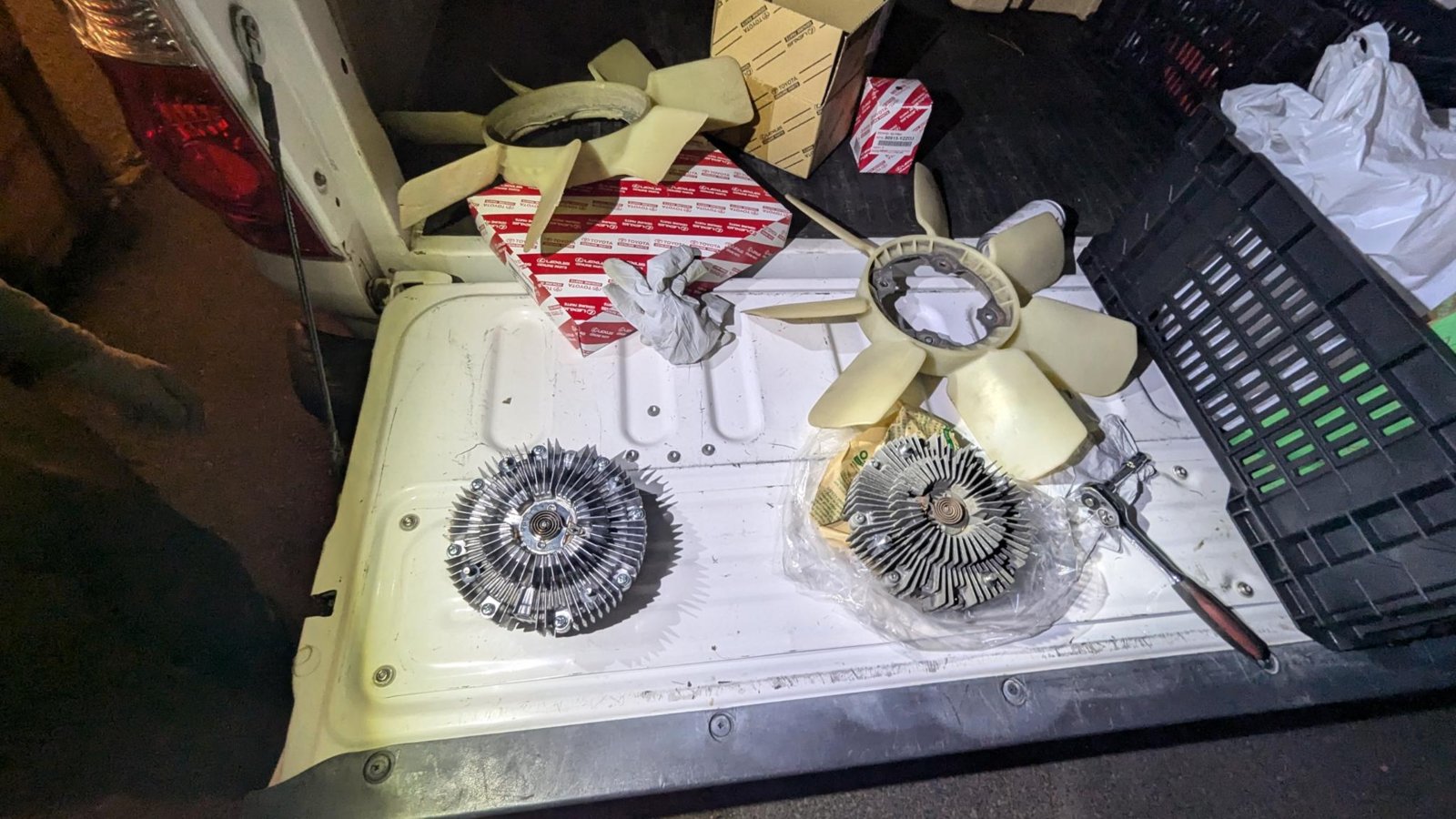

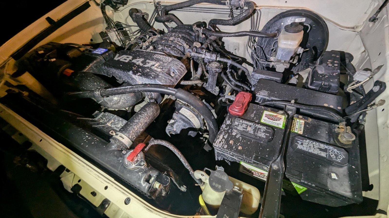

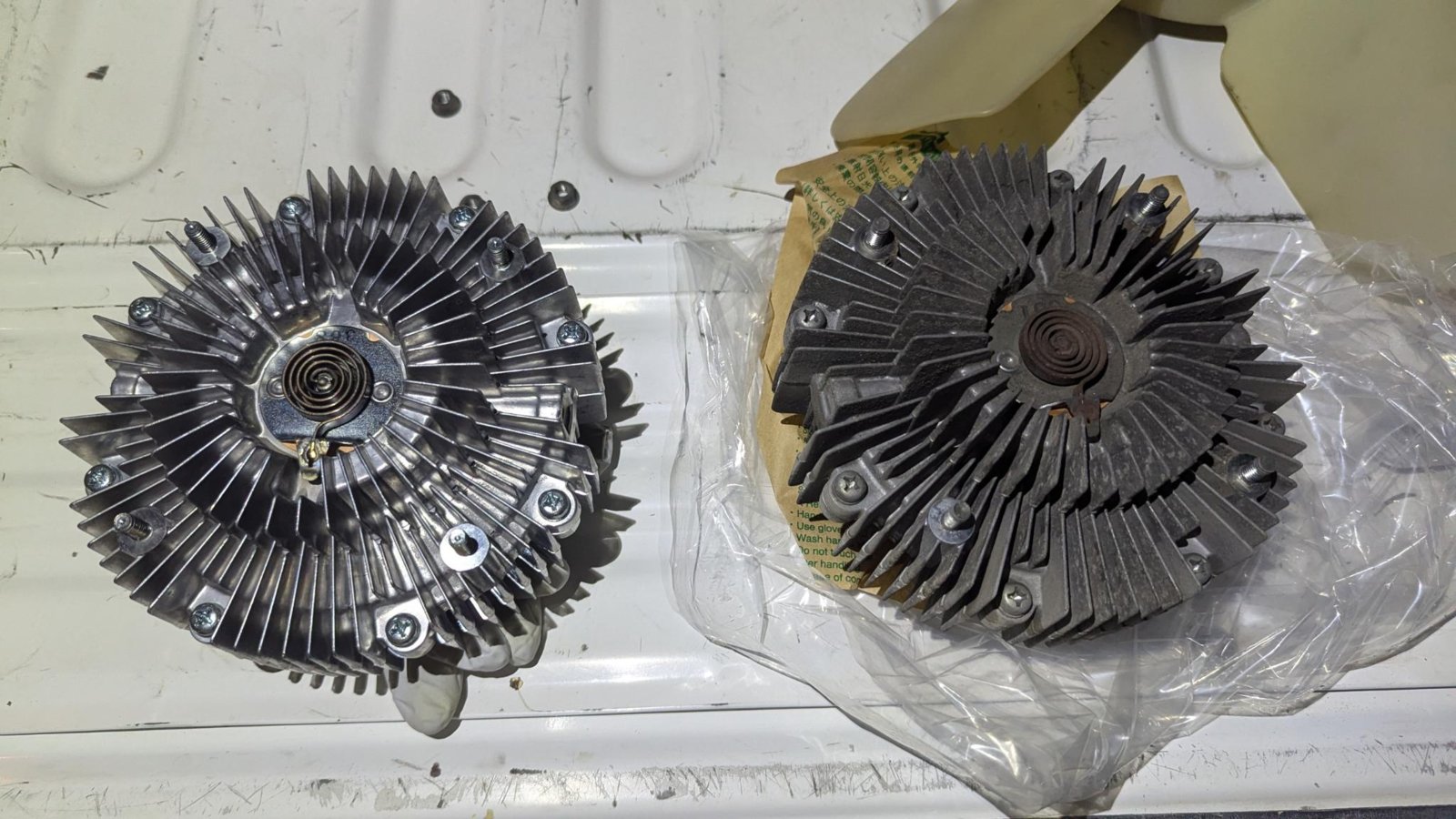

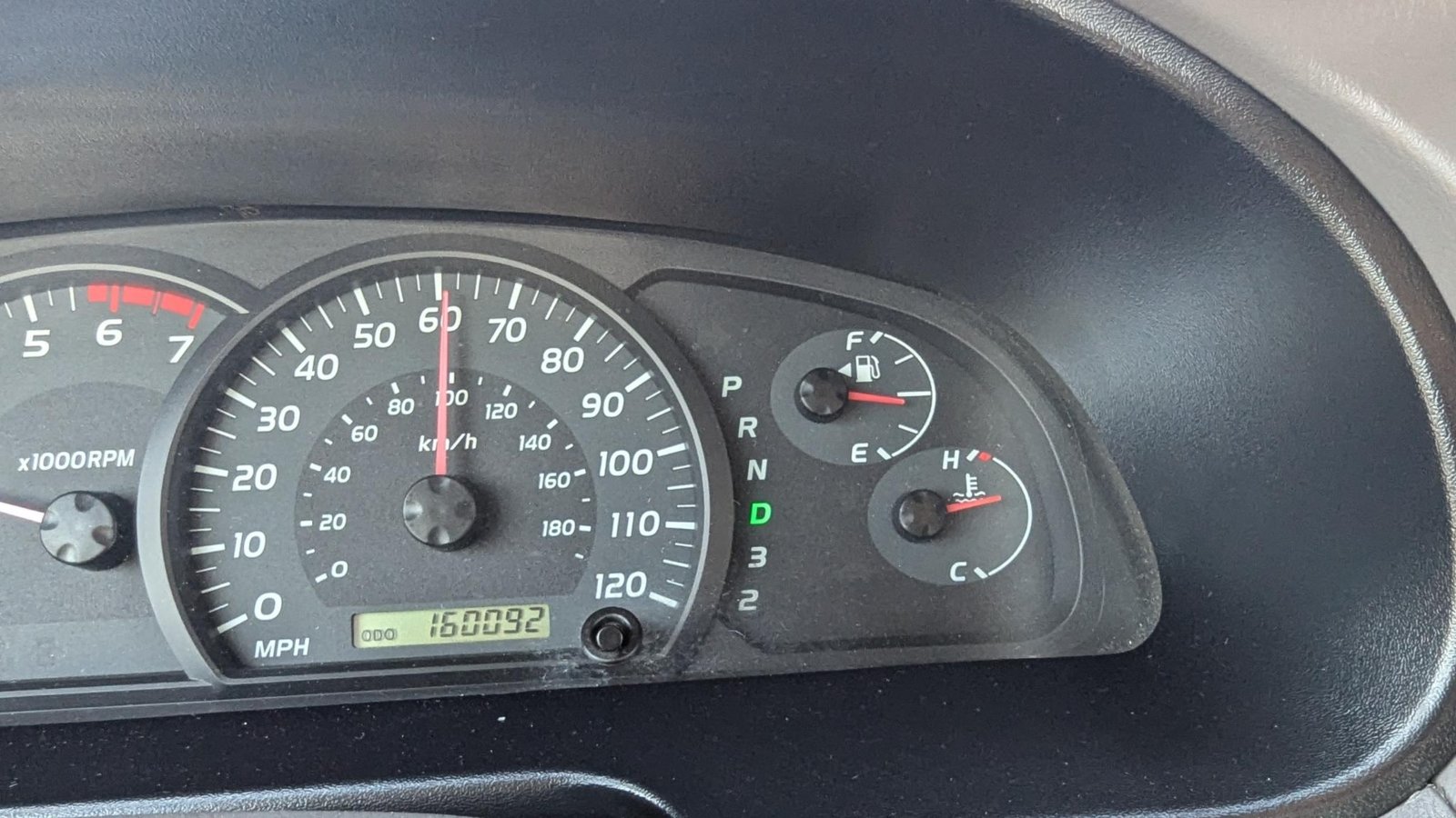

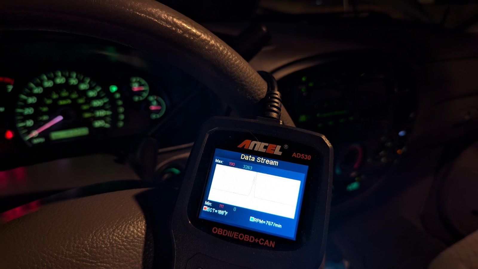

    Tundra was being tested in 115F+ degree weather. Ended up replacing the fan's fluid coupler after an overheating event. Observed how and when the coolant temps rose. Basically, any combo of the following caused overheating, 1) RPM's <1,500, 2) low speeds, 3) ambient temps above 95 F degrees. Keeping rpms between 1500-2000 at long stoplights, while eyeing the temps, and checking the traffic light, sure kept me alert.
    ^Blazing hot in the desert!:bananadead:
    ^Coolant temps normal on highway speeds, until I got to a hill
    ^Fun mess. Note the radiator cap, which will be under watch while keeping track of coolant temps.
    ^Quick trip to the dealership to get a new fluid coupler. Top left is a cracked fan from a Land Cruiser being compared with the Tundra's - the Land Cruiser's is much bigger. Left is the new coupler. Right side is the Tundra's fan, which was in good shape, and the old coupler.
    ^ So shiny!
    ^Initial testing showed coolant temps were steady at 190F (+/-) degrees. Hooray!
    After the install, the air felt being blown was significantly stronger. And the next few days, coolant temps were back to normal.

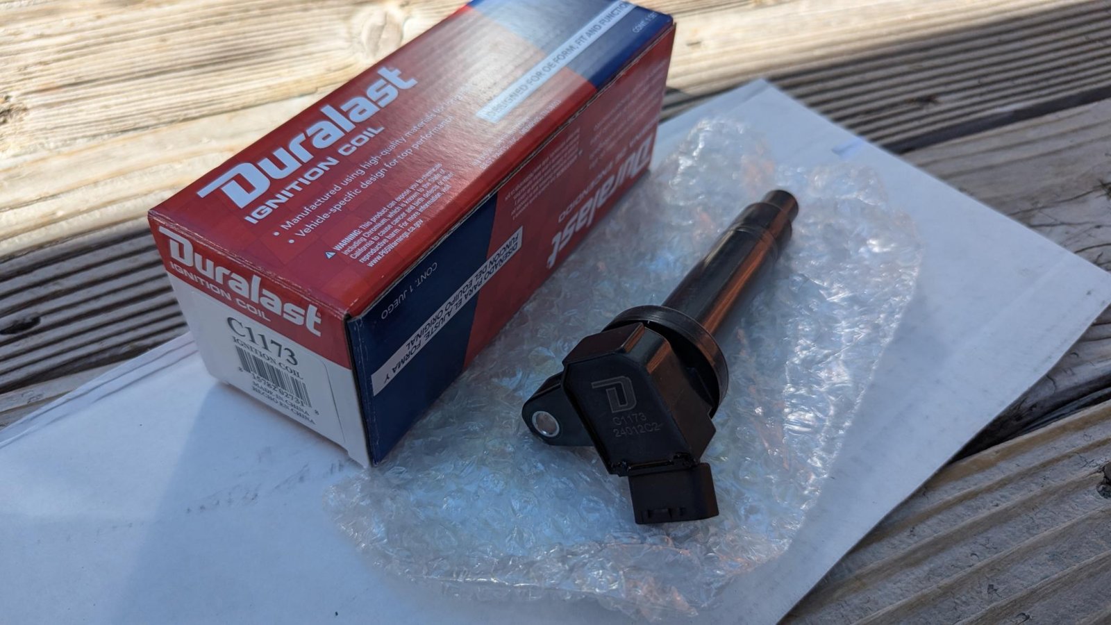

    Few days later after driving up a mountain, coolant temps did go up and reservoir tank overflowed a tiny bit. Then misfire on #2 happened, which was confirmed after swapping the ignition coil with #4. Bought a Duralast unit as a short term fix to be able to drive home.
    ^#2's temporary fill-in

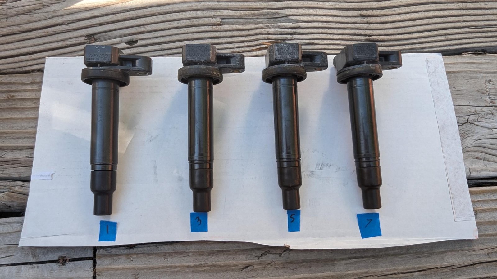

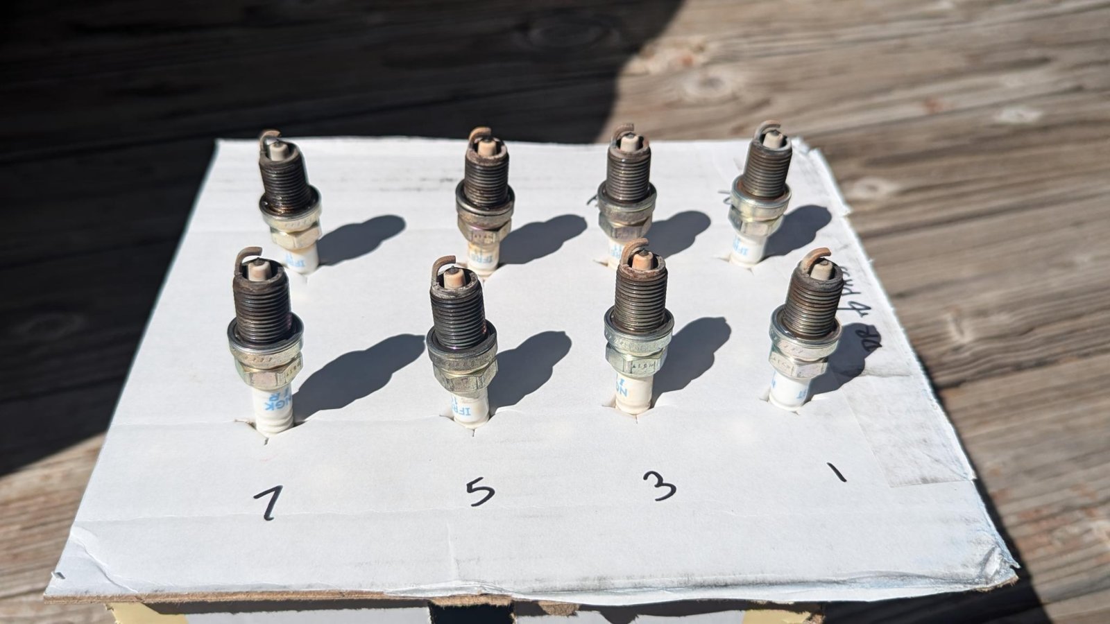

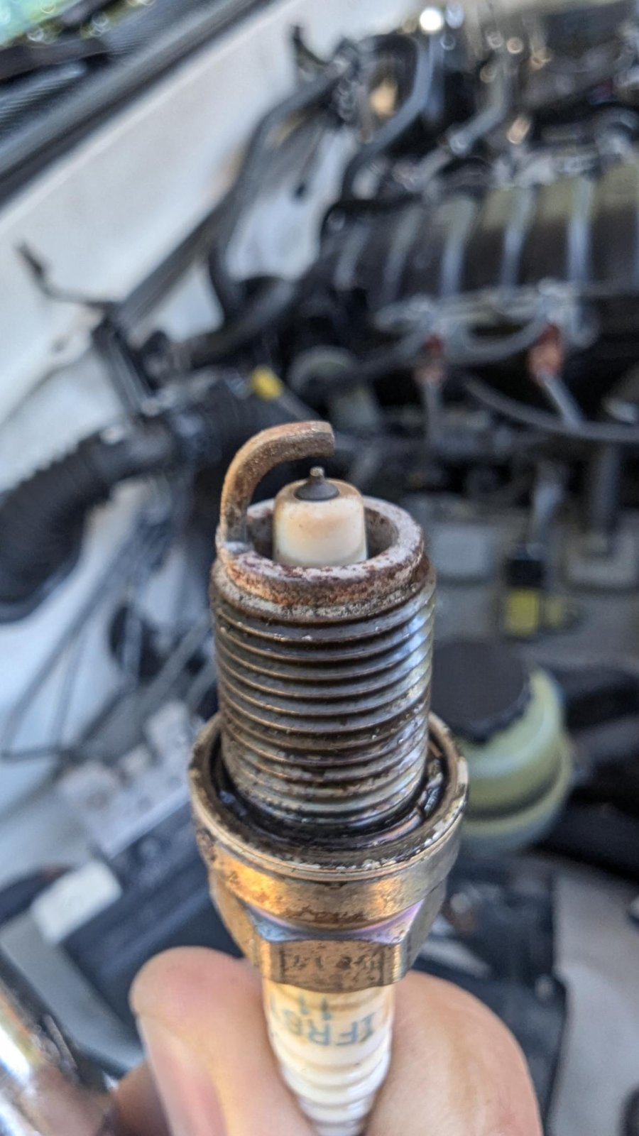

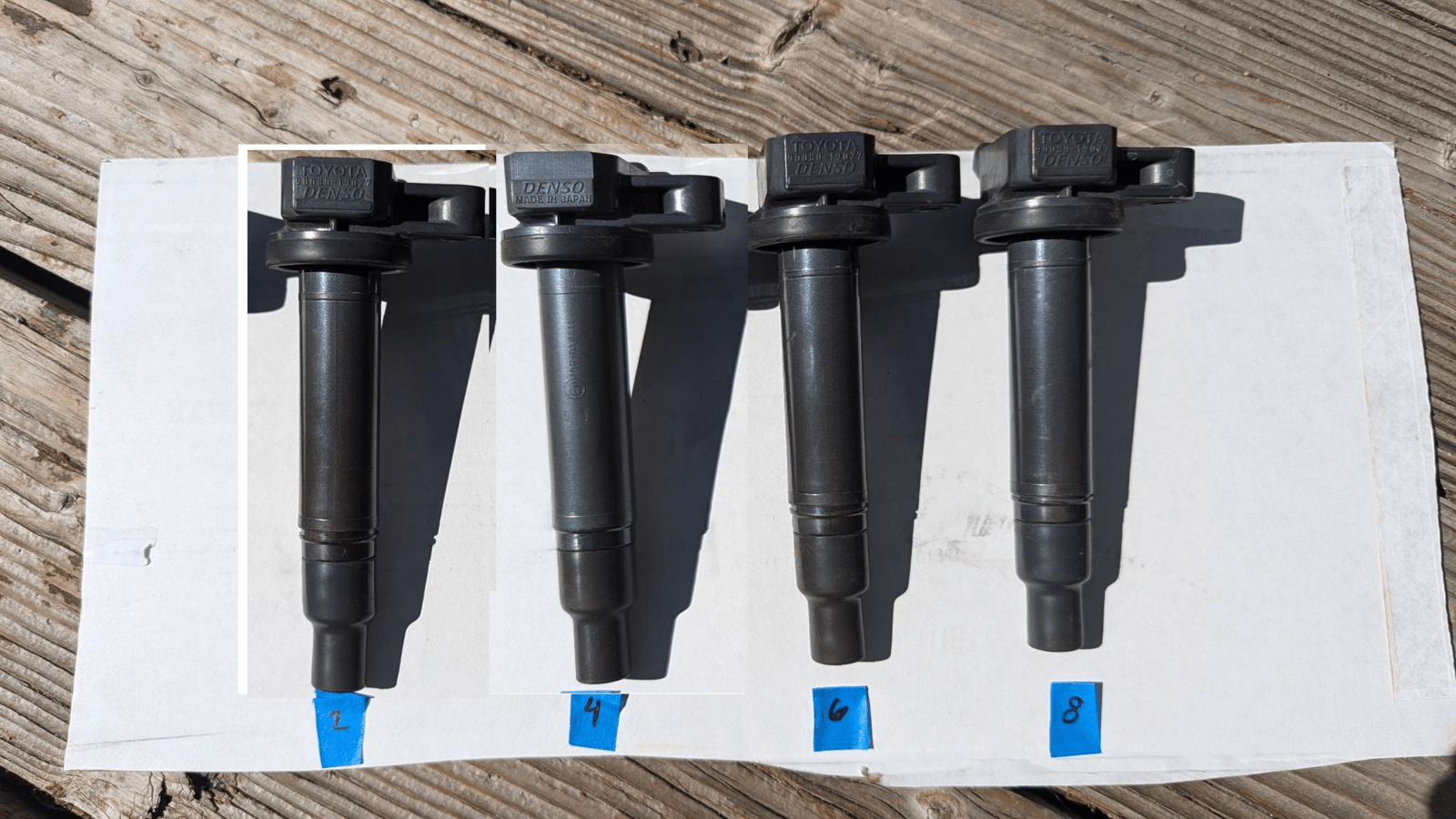

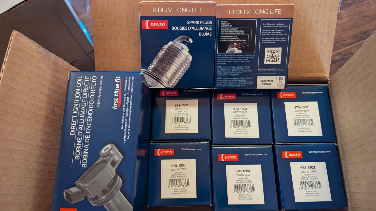

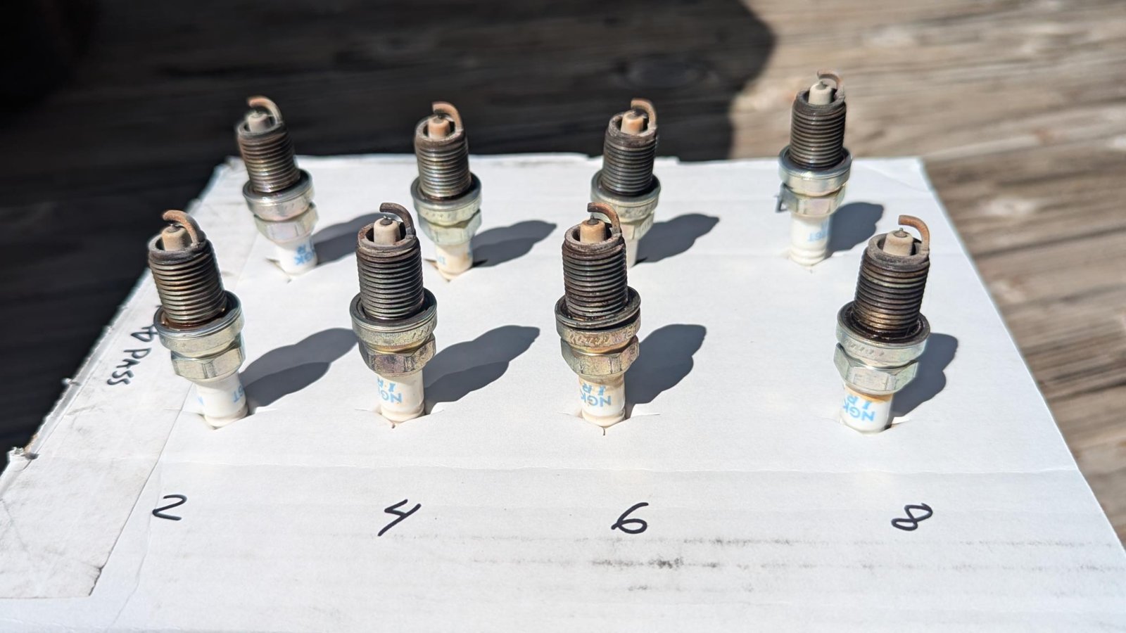

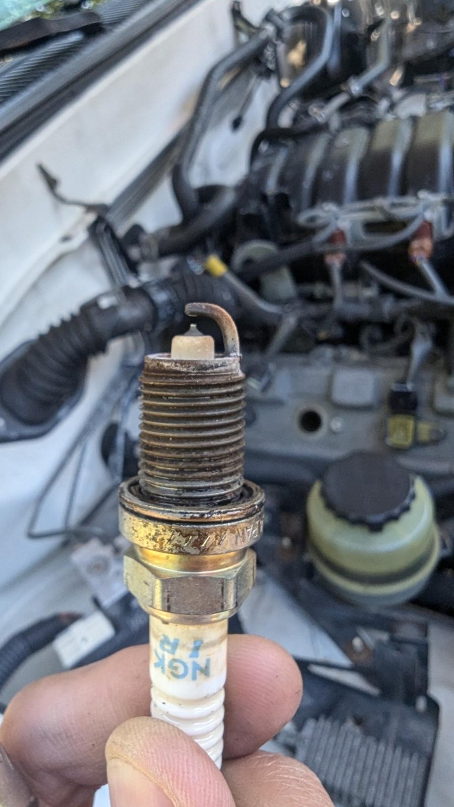

    Later that week, misfire on #6! :annoyed: Got me thinking that the rest of the original coils may be on their way out too, especially being subjected to 120F weather and constant mountain driving. So, out comes all 8 coils and spark plugs for a closer look.
    ^ 2-4-6-8 coils. Ignore the photoshop swap. #2 and 6 were the ones involved in the recent misfires. #4 is a newer unit.
    ^2-4-6-8 spark plugs. #2 and 6 were the ones involved in the recent misfires.
    ^1-3-5-7 coils. #1 is a newer unit.
    ^#7-5-3-1 spark plugs
    ^#2 coil's damaged boot
    ^#6 spark plug. One of the two dirtiest plugs at the threads/washer.
    #8 spark plug. The second of the two dirtiest plugs at the threads/washer.
    Observation for the ignition coils:
    2 - damaged boot
    4 - newer unit, looks good
    6 - browned boot
    8 - multiple cracks
    1 - newer unit, looks good
    3 - cracks
    5 - cracks, dirty boot
    7 - dirty boot
    Observations from taking out spark plugs for the first time:
    2 - a little too easy to take out
    4 - ok taking out
    6 - tighter, and threads/washer were dirty with a dark film residue
    8 - a little too easy to take out, and was also dirty at the treads/washer with a dark film residue
    3 - tighter
    5 - ok taking out, dirty at the treads
    7 - was tighter, dirty at the treads
    Some research about spark plug tightness, especially on high mileage 2UZ's that ran on original plugs, led me to an important post from ih8mud. :pccoffee:
    It is a highly recommended read if you ever hear the "tick tick tick/pop pop pop" sounds that could be mistaken as exhaust manifold leak or gasket leak, which is a sound I have been hearing lately. I was originally suspecting a possible exhaust manifold leak or just noisy camshafts, so this is another thing to keep in mind. I'll be checking if the sparkplugs walk out around every oil change.
    That's it for now. New coils and spark plugs coming up.

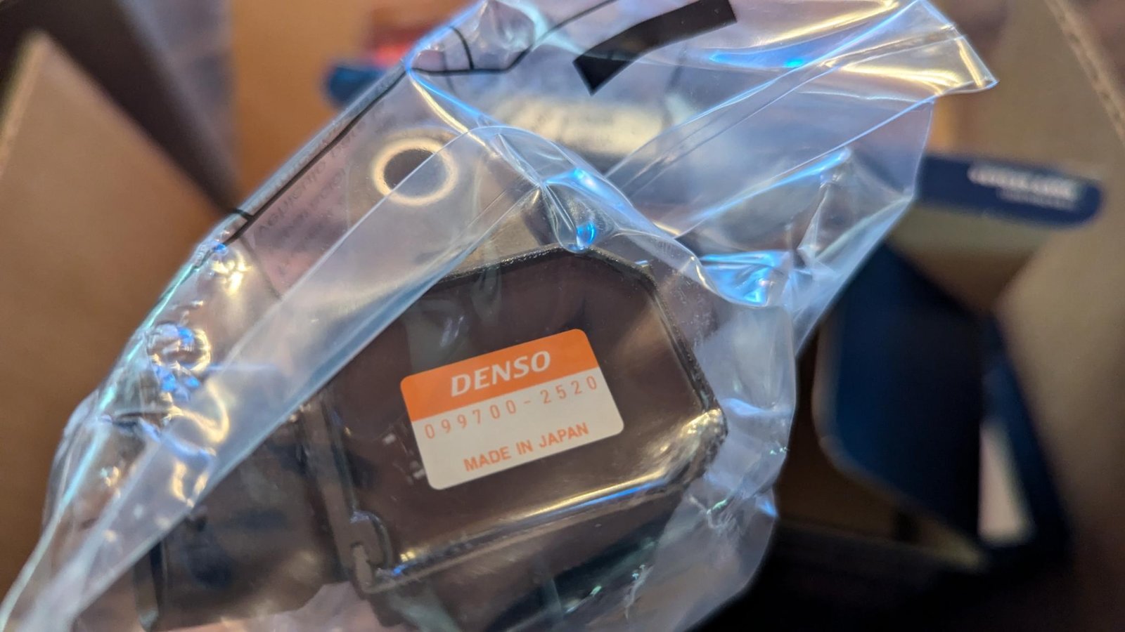

    ^This new set should last for a good 100k.. :spending:
    ^When did these xxxxxx-xxxx stickers start being used? I've seen pictures of Denso coils using a black sticker with xxx-xxxx PN format. :monocle:

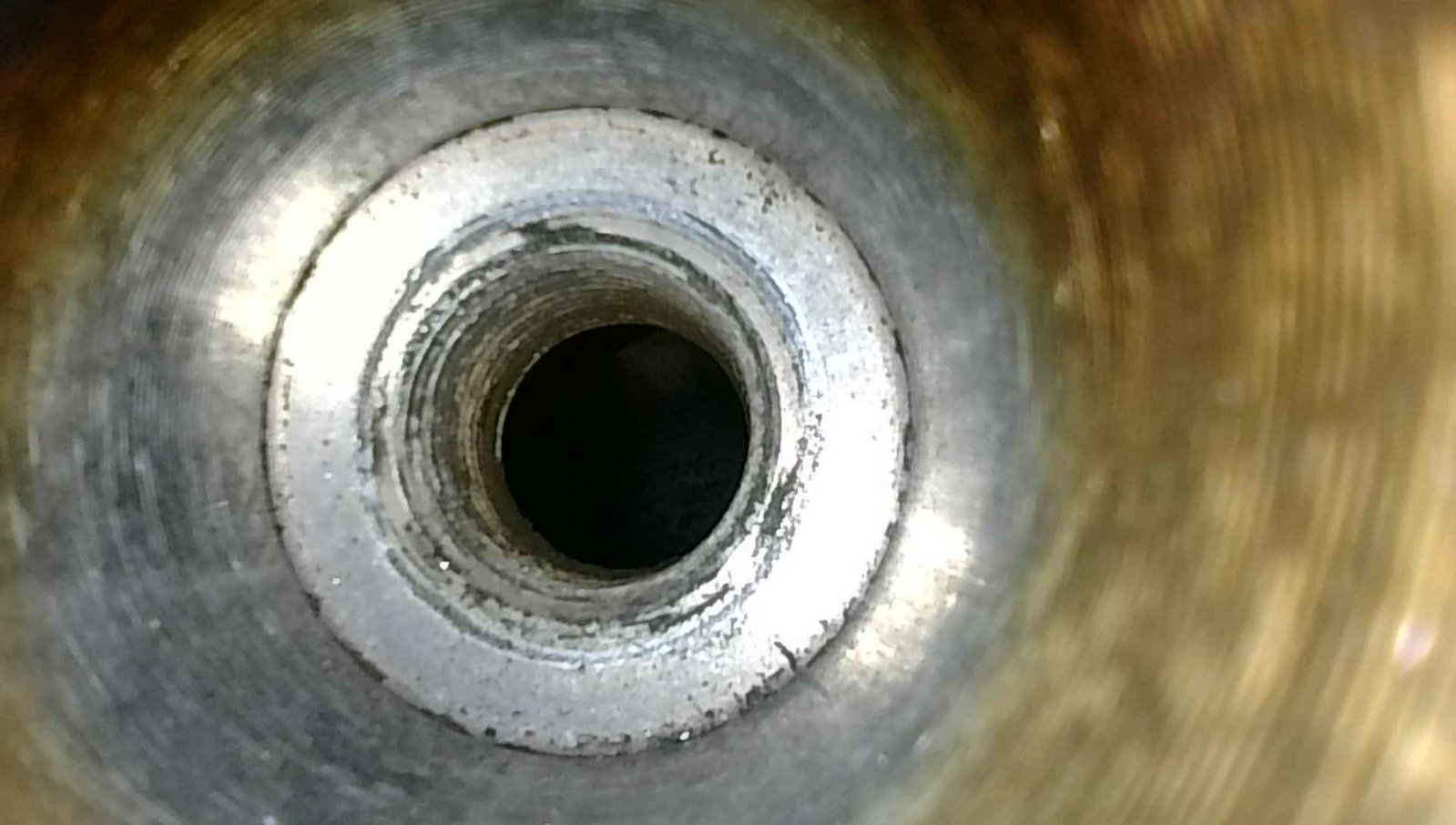

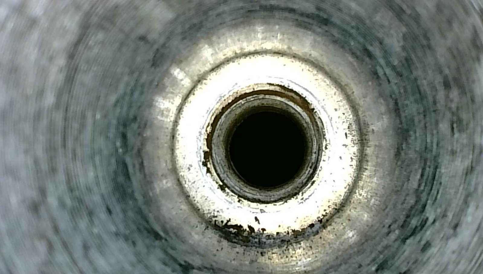

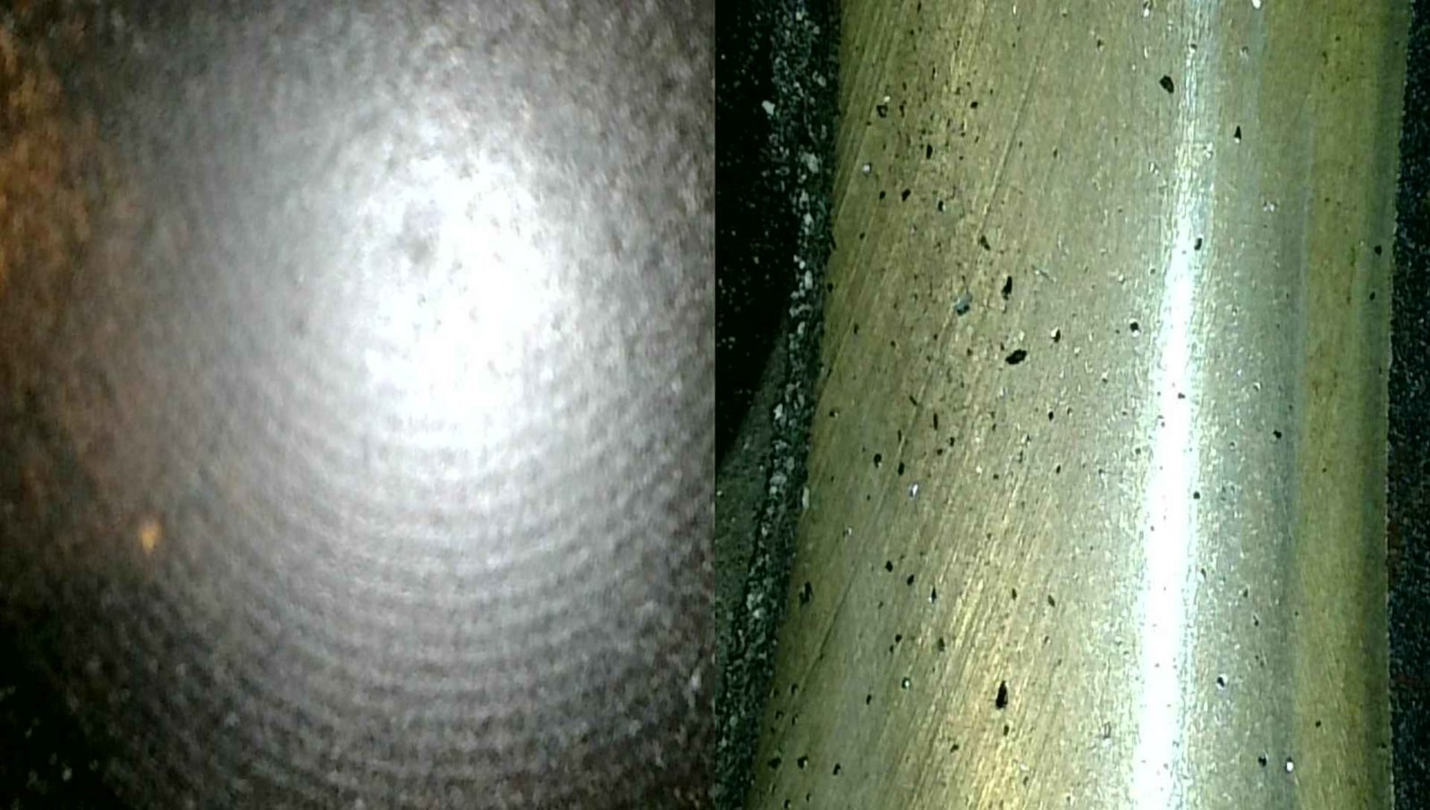

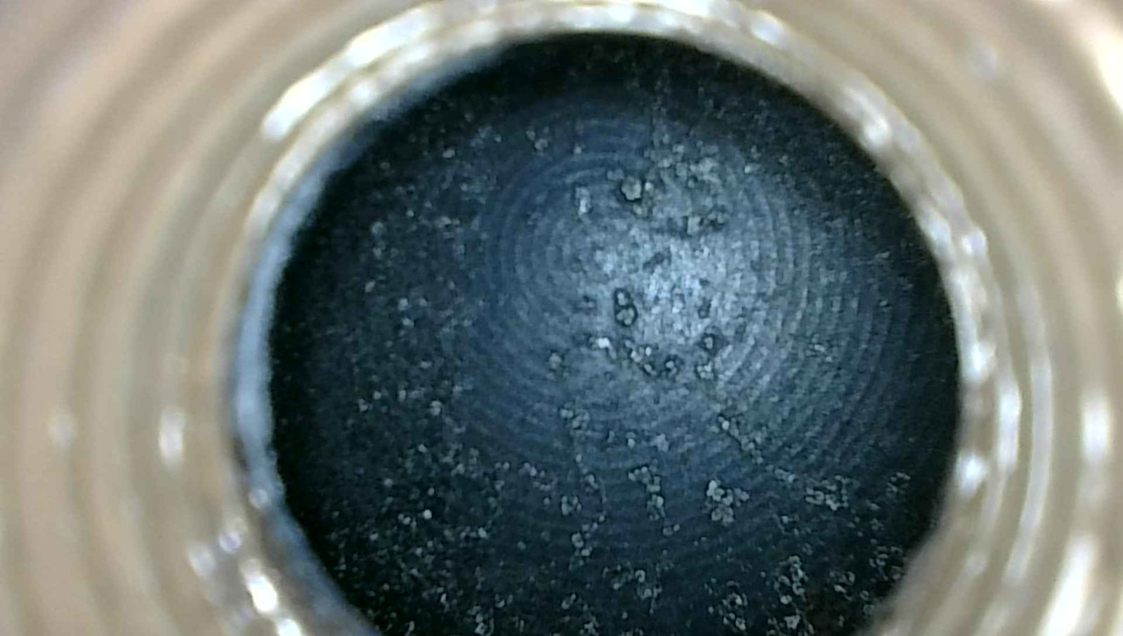

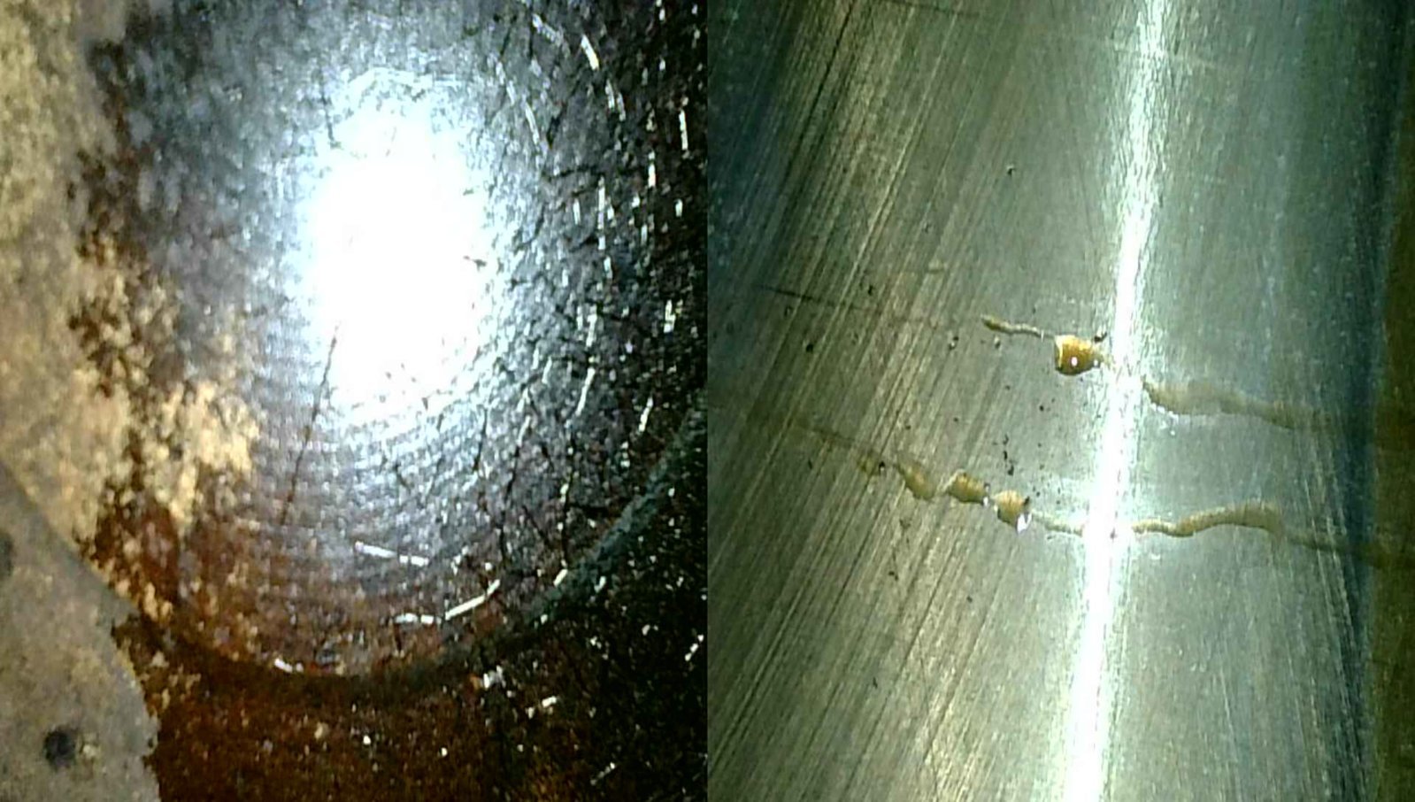

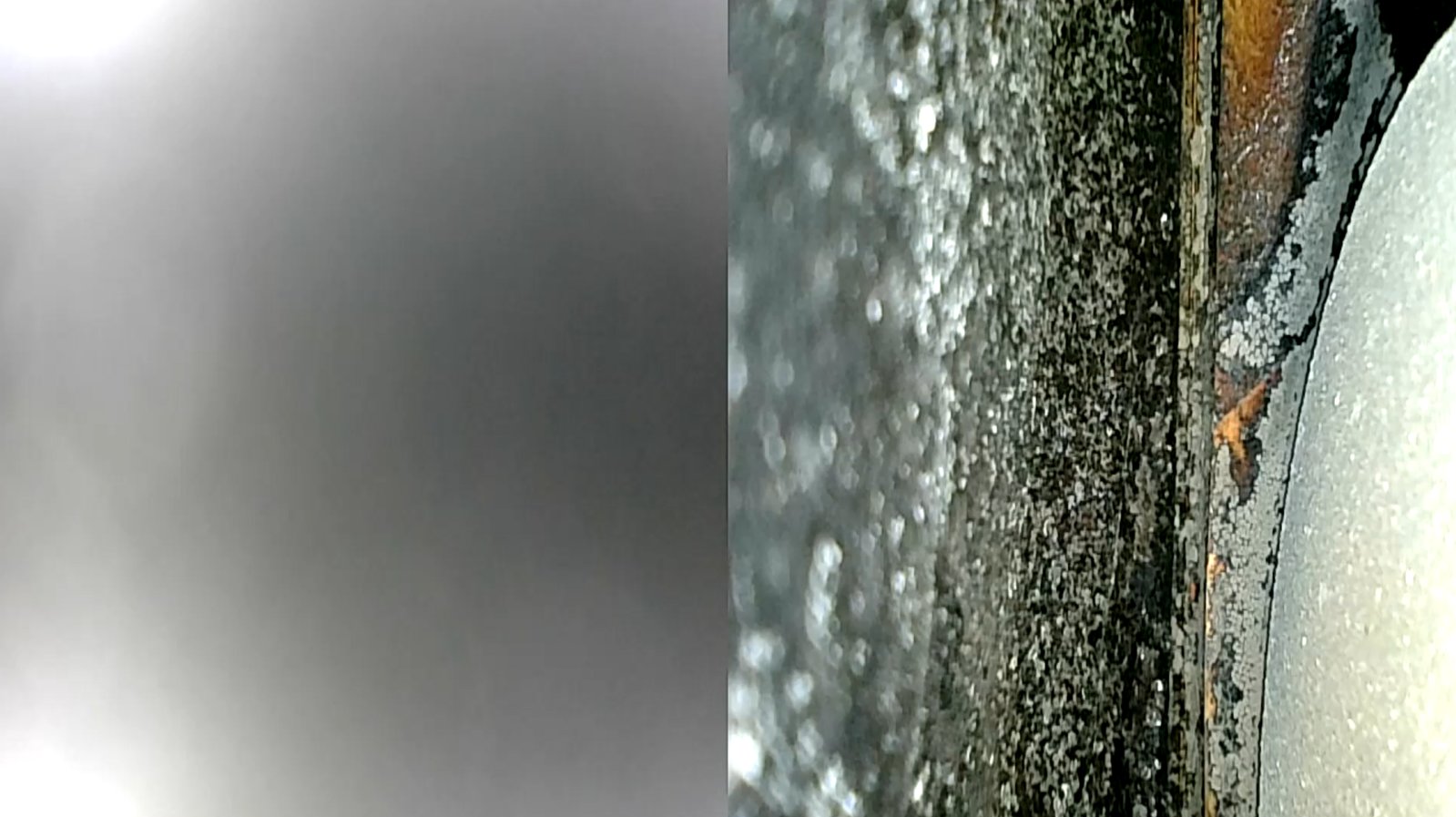

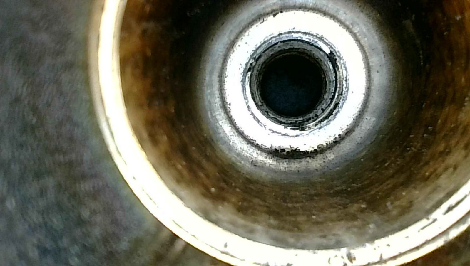

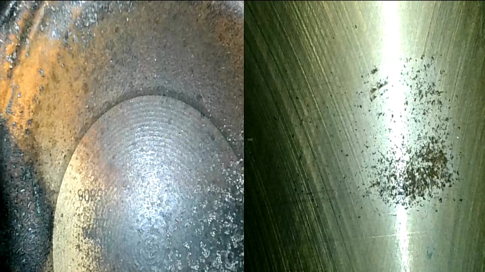

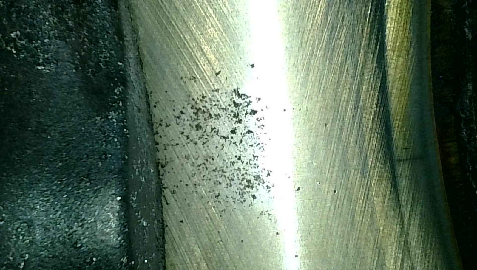

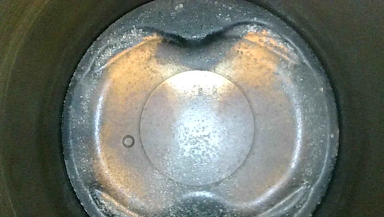

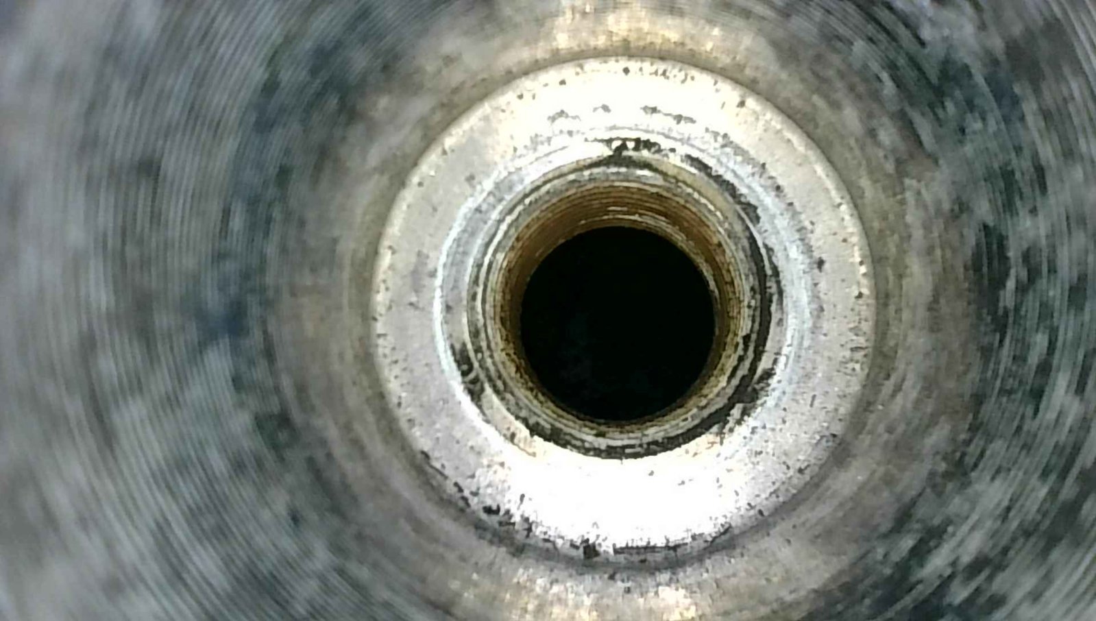

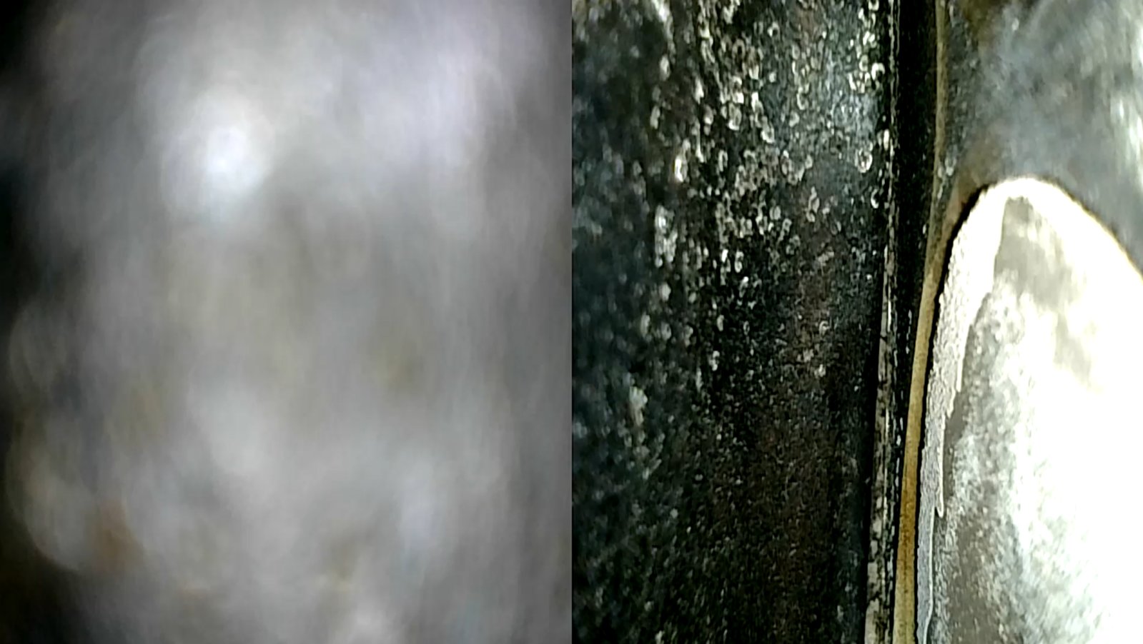

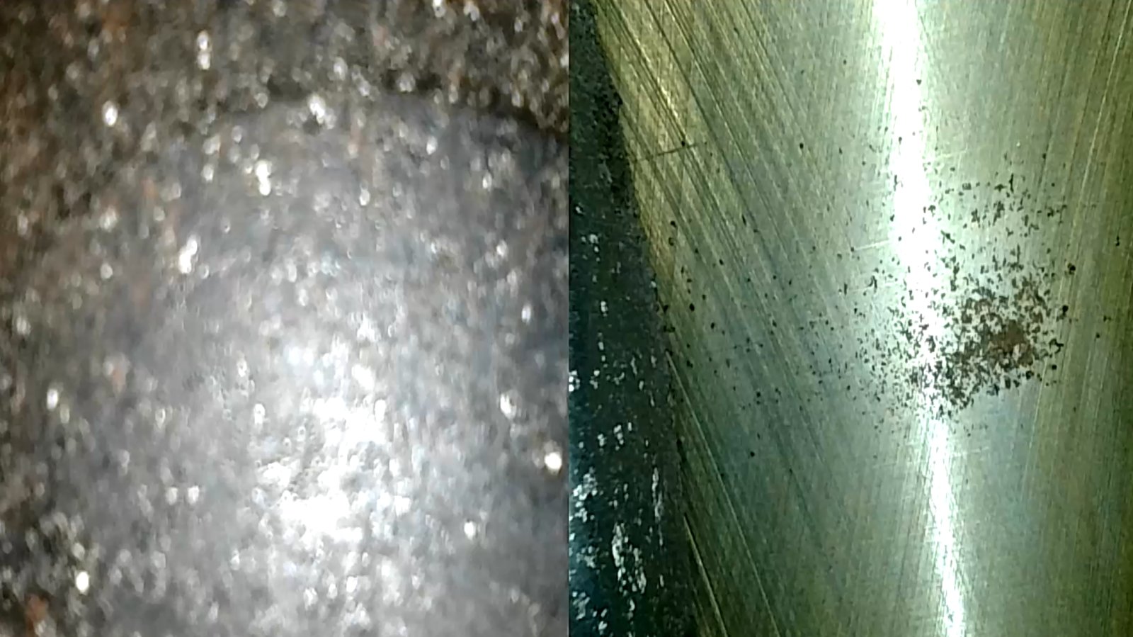

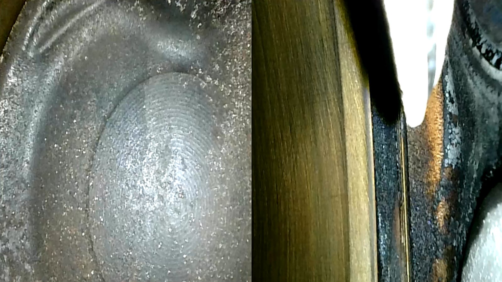

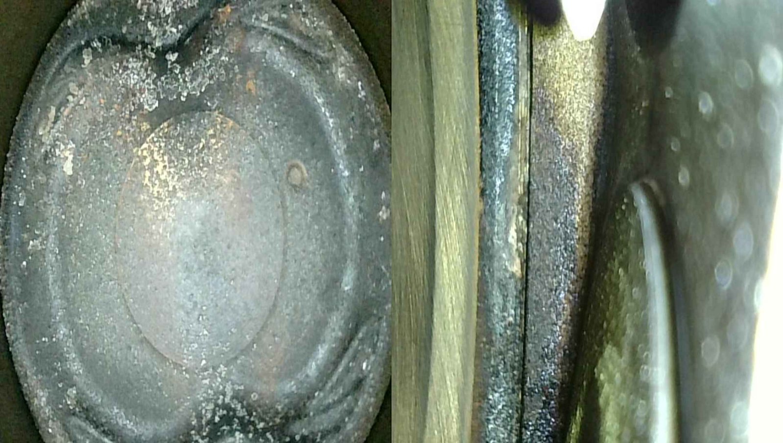

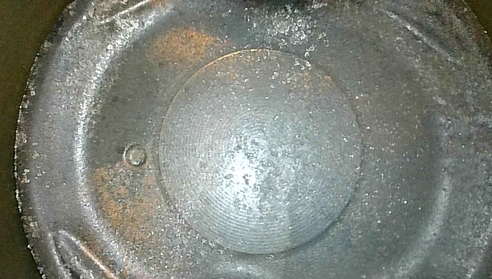

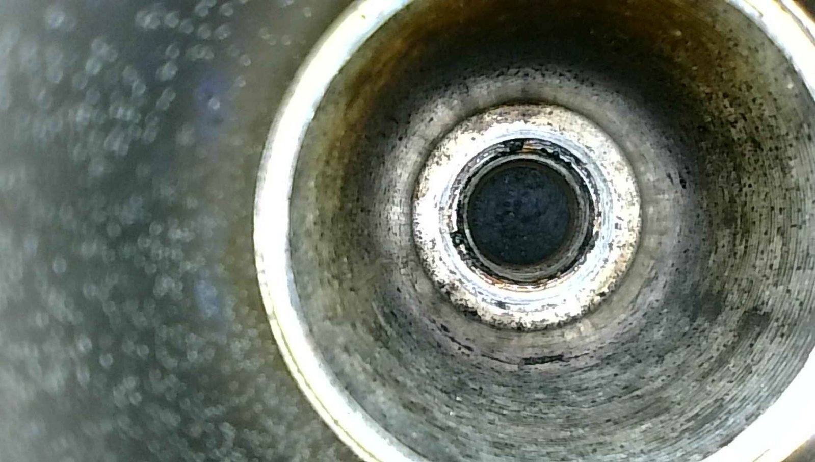

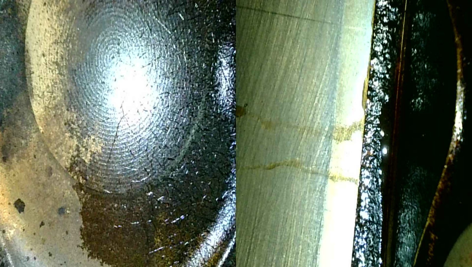

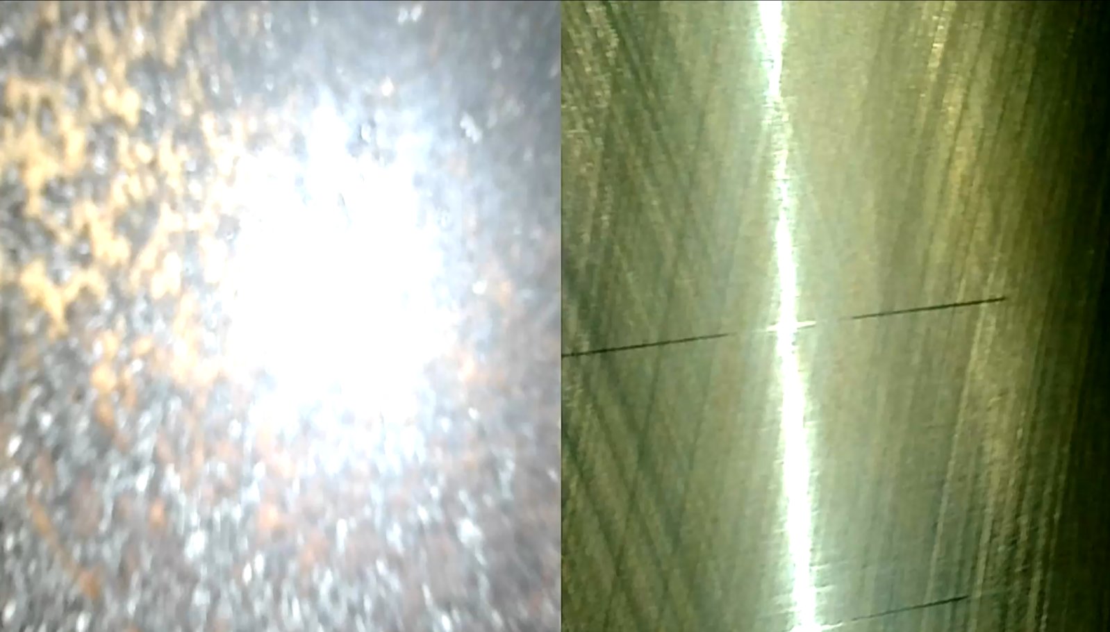

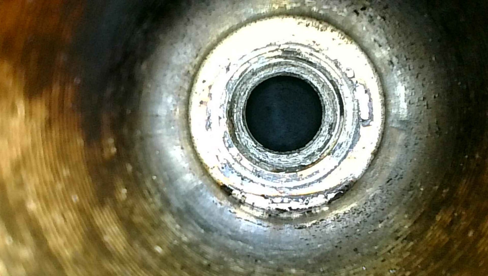

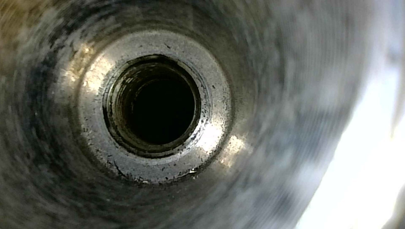

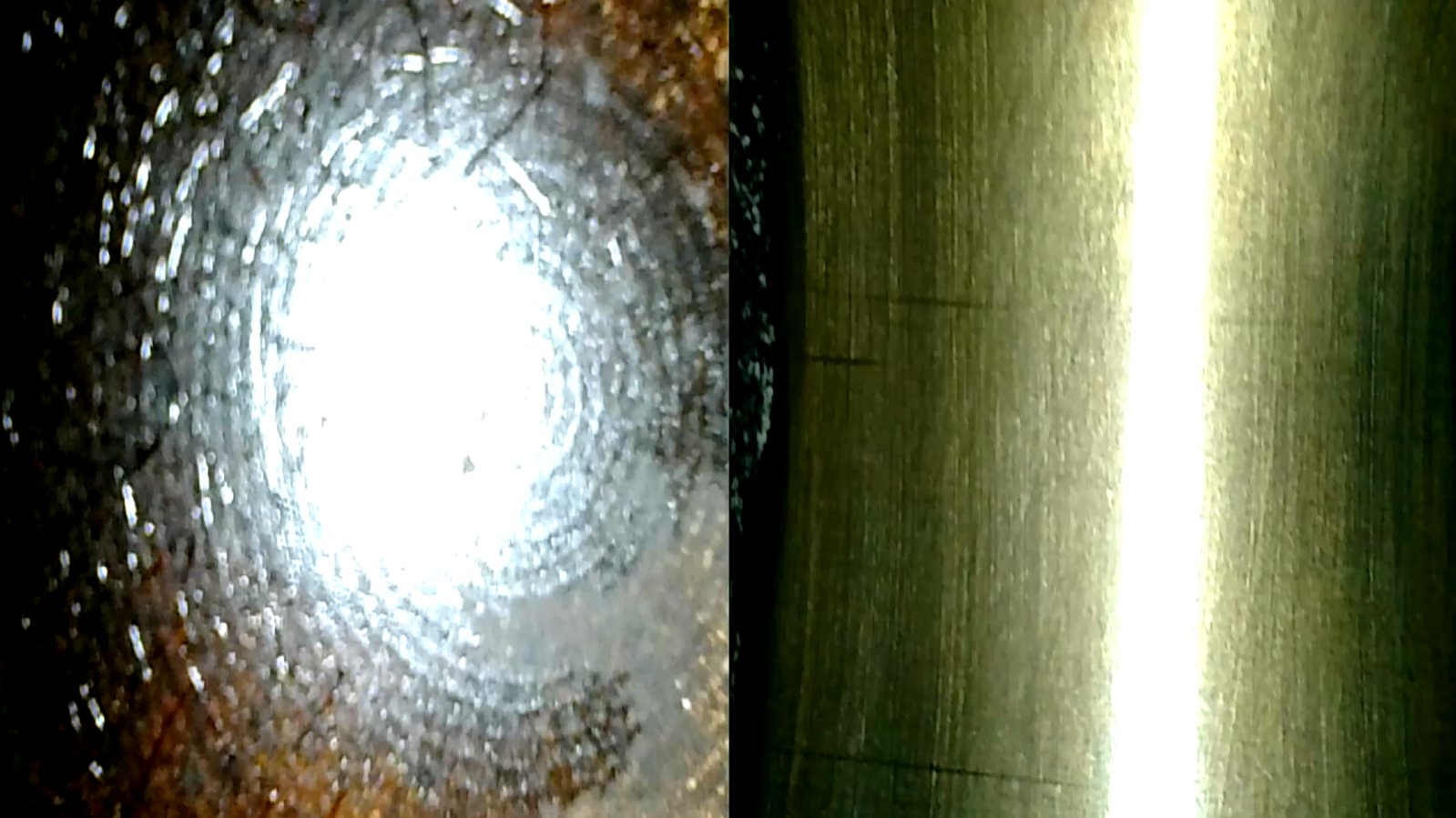

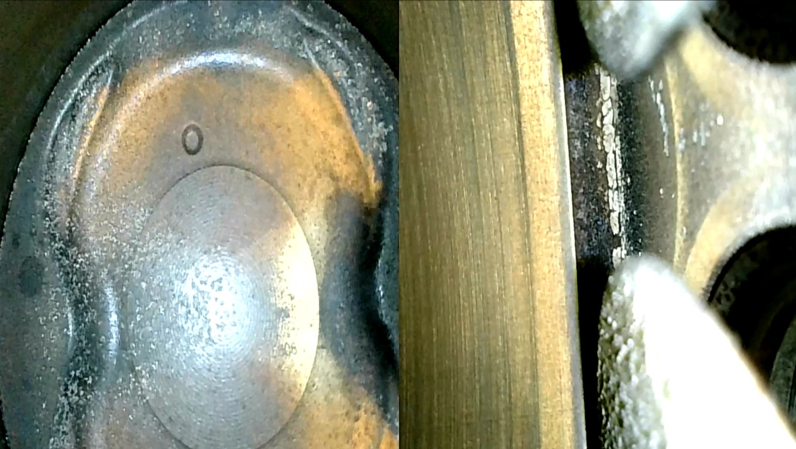

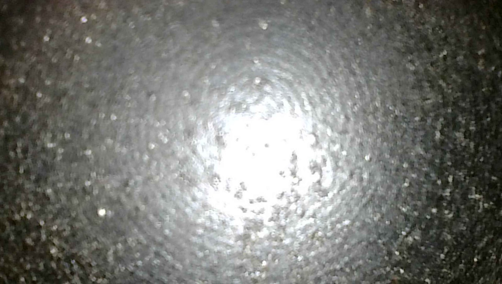

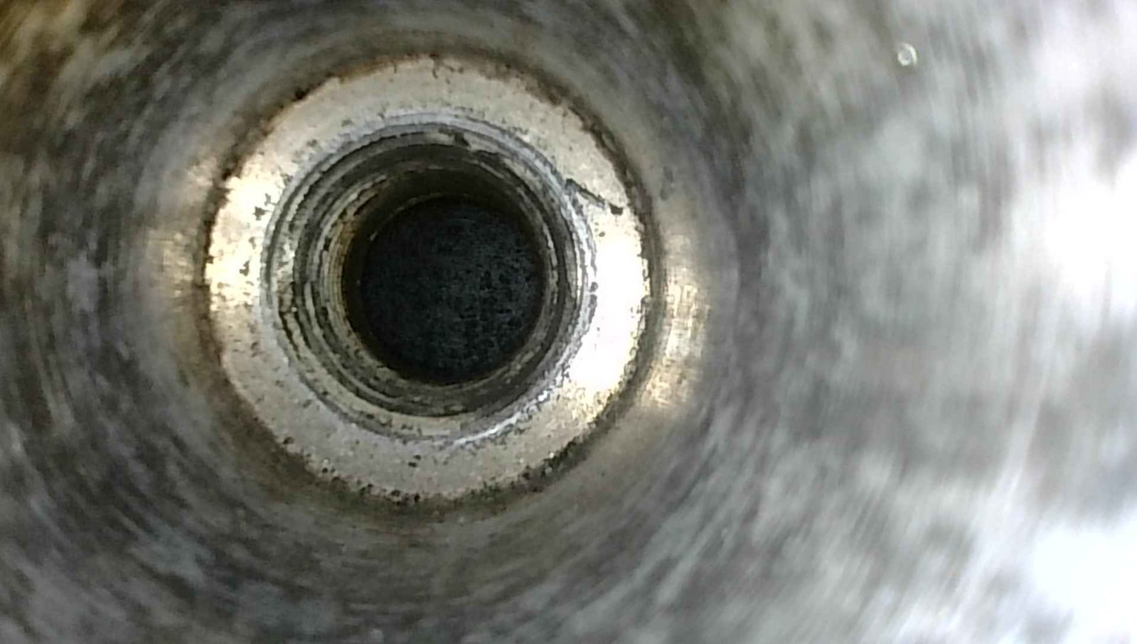

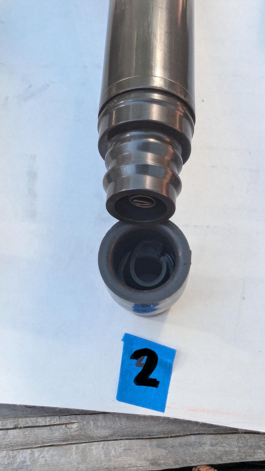

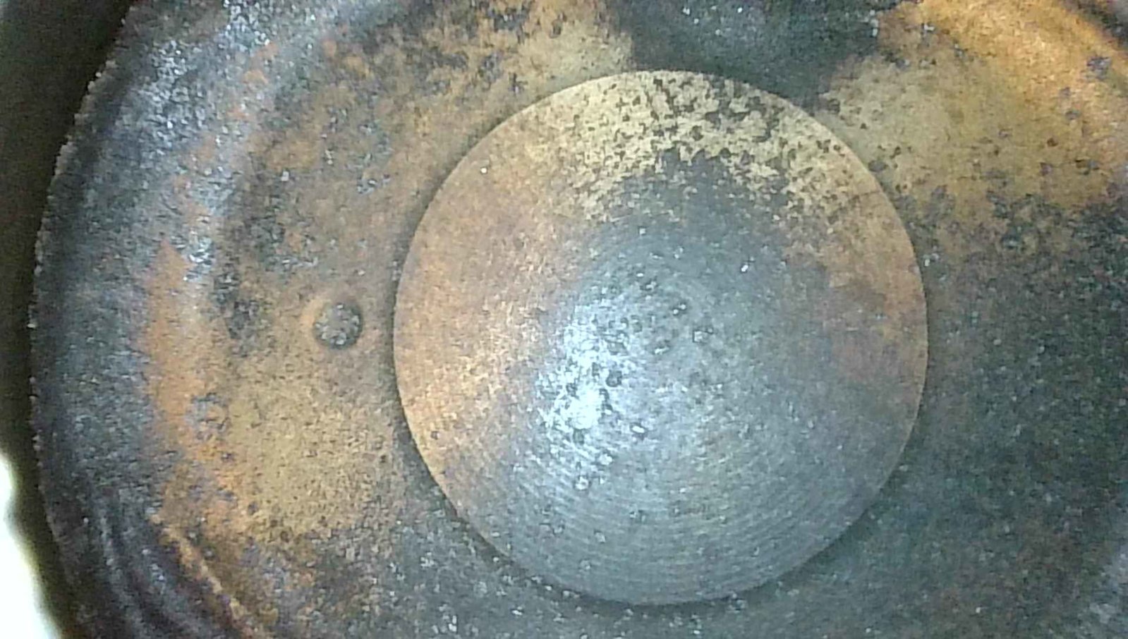

    Before installing the spark plugs, let's take a peek into the combustion chambers! The dot on the piston crown is the front mark. So, in the pictures, the dot at 3 o'clock has the front of the engine towards the right and dot at 9 o'clock has the front of the engine to the left.
    Pictures labeled for easy reference.
    Cylinder 2:
    ^#2A
    ^#2B
    ^#2C
    Cylinder 4:
    ^#4A
    ^#4B
    ^#4C
    ^#4D
    ^#4E
    cylinder 6:
    ^#6A
    ^#6B
    cylinder 8:
    ^#8A
    ^#8B
    ^#8C
    Cylinder 1:
    ^#1A
    ^#1B
    ^#1C
    Cylinder 3:
    ^#3A
    ^#3B
    ^#3C
    ^#3D
    Cylinder 5:
    ^#5A
    ^#5B
    ^#5C
    Cylinder 7:
    ^#7A
    ^#7B
    ^#7C
    ^#7D
    ^#7E
    That's it for the initial inspection of the combustion chambers.
