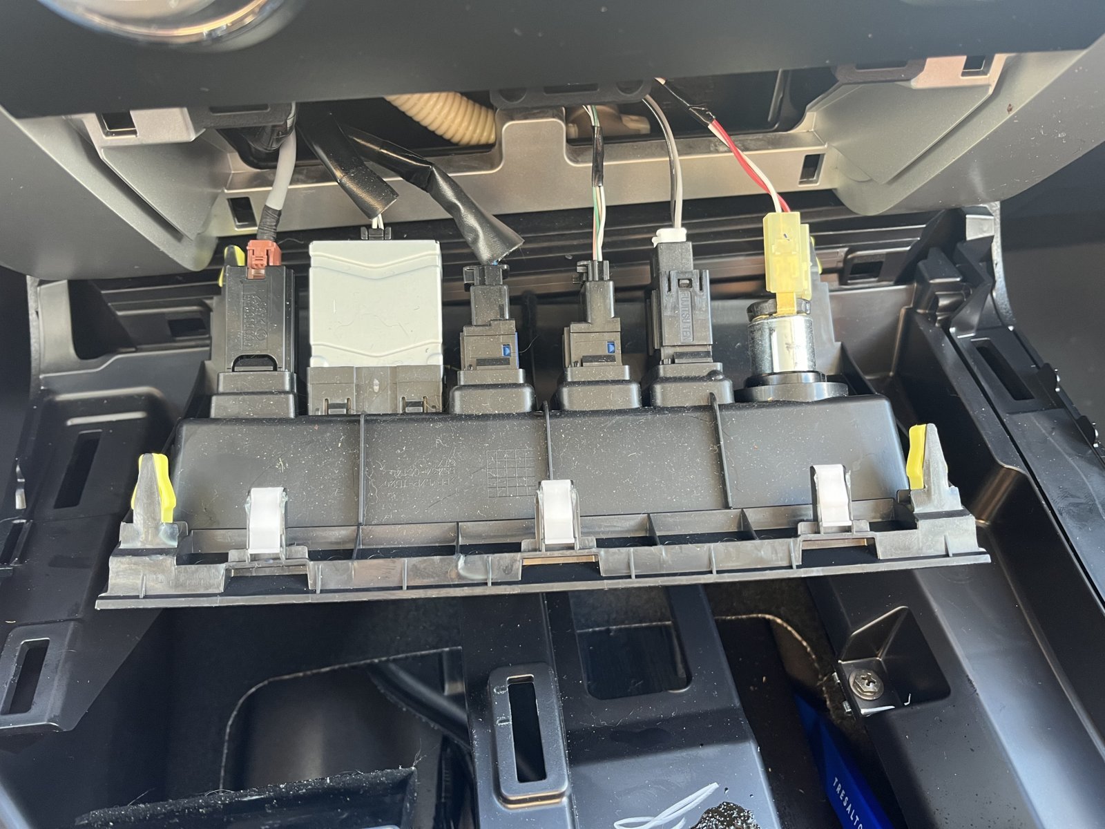

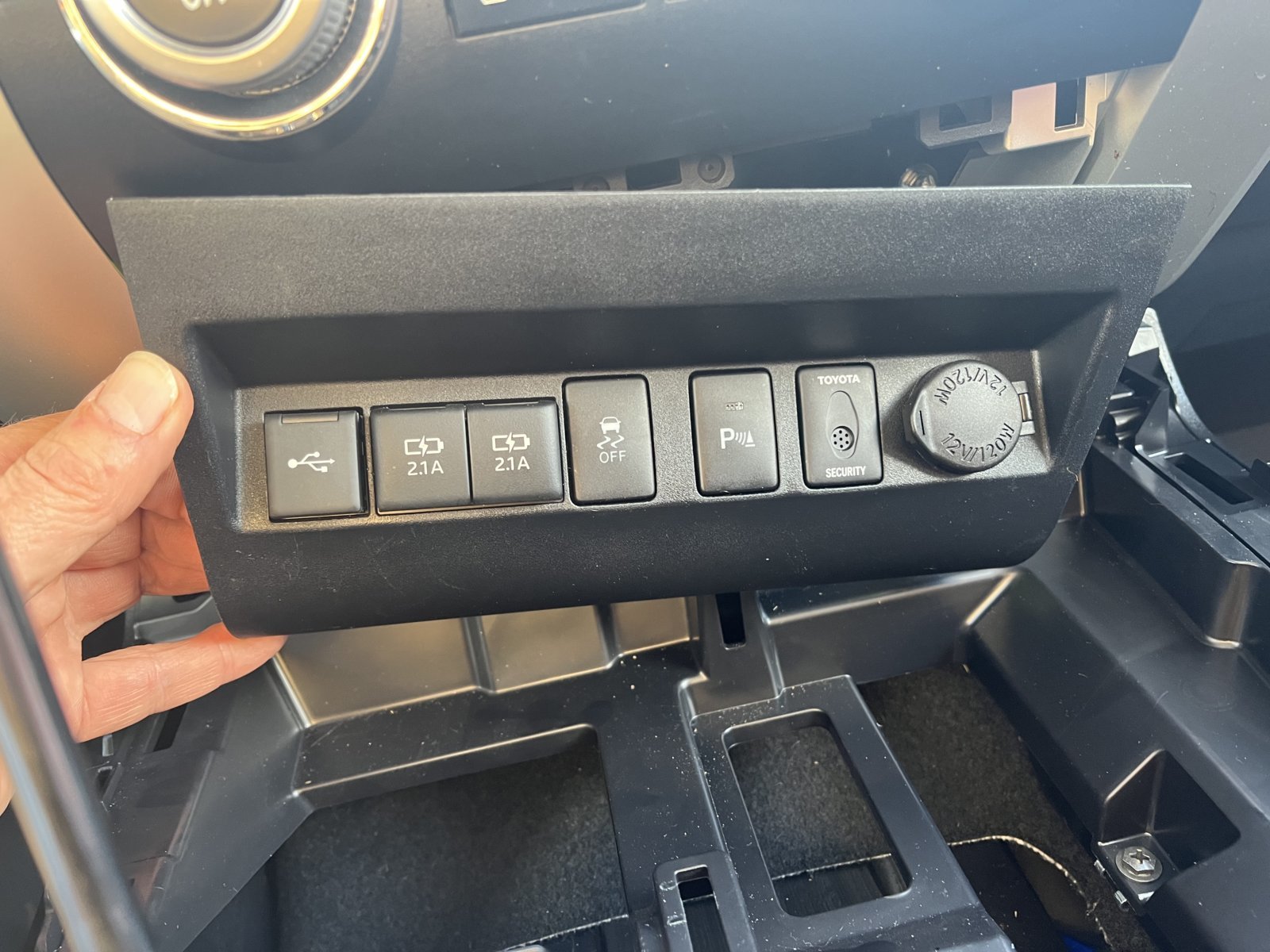

    So I started to install my Trail Grid Pro anywhere camera today after reviewing their TGP install video. Got my camera mounted in the grill okay since I am also putting a new color match honey comb grill on my gray 2021 1794 Edition. My next step was to dismantle the interior components for the wire harness install, however when I pulled the switch console it appears to have all the slots filled with no extra slot for the camera switch. See attached photos. What have you guy done in this situation? I'm sure I am not the first one to have this issue. Has anyone remounted the switch somewhere else? Also in the picture there is one standalone item called Toyota Security (what is it? Seems to have holes for audio maybe) Can I remove it from its location and tuck it behind the switch plate console? Just don't want to mess with the functionality of what ever it does.
    I have contacted TGP about this but I have not head back from them yet.
    Thanks for you suggestions.

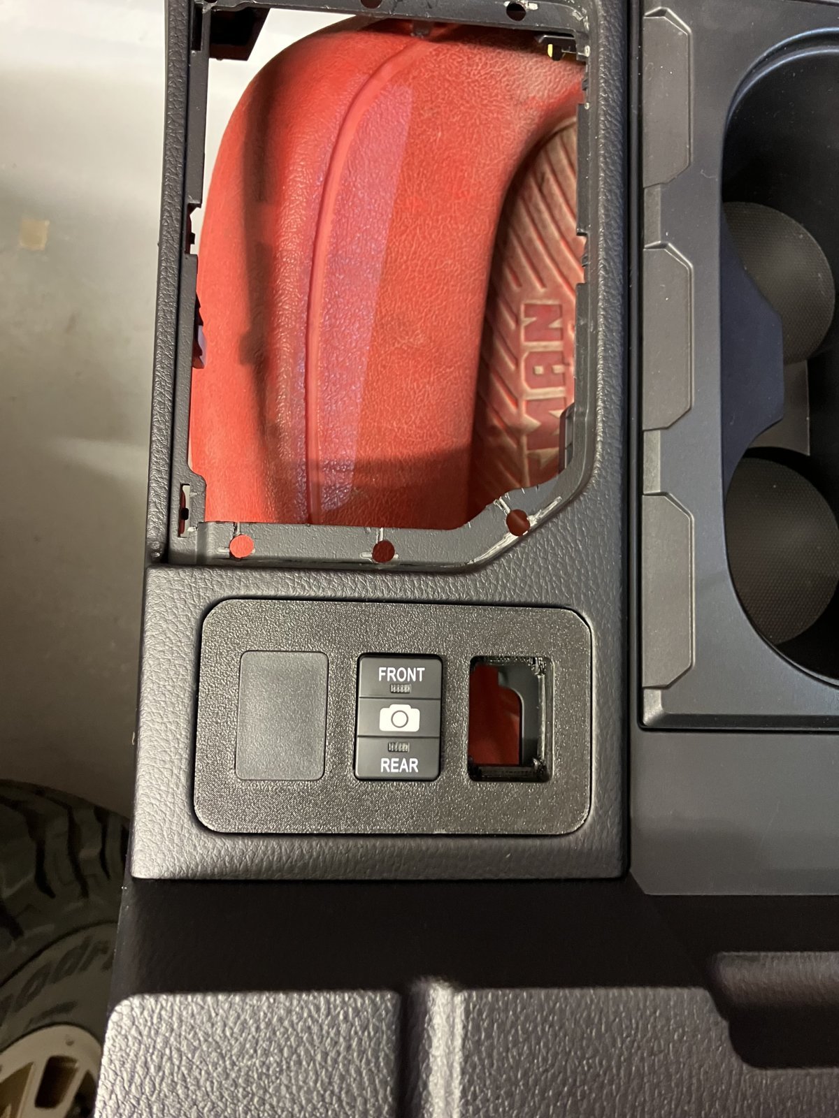

    The toyota security is a glass break sensor, a microphone. There should be a panel to the left of the steering wheel with a blank space. Other wise put it down by the TPMS reset button or the "change holder" are behind the shifter

    Thanks for the reply! Figured the sensor might be a microphone. I'll add extension wires to the pig tail for the switch and relocate in the center console somewhere. Thanks again.

    I removed the Auto High Beams button on the left of the steering wheel on my GX460. No error codes or issues. I would think about removing that instead of any on the center console.

    I end up moving mines using @RainMan_PNW 3D print switch holder.
