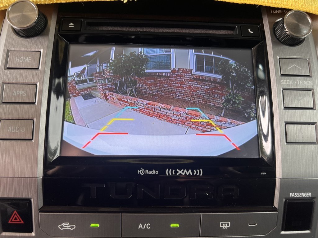

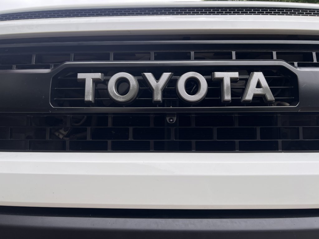

    Did you buy the prewired kit or the one you have to solder/assemble yourself? I actually just installed mines today and it was the prewired one. I also cut the purple (vertical flip) and white wires (horizontal flip).
    If you bought the prewired kit then they must've screwed up when they were assembling it, otherwise i'd think there was a misstep while you were assembling it
