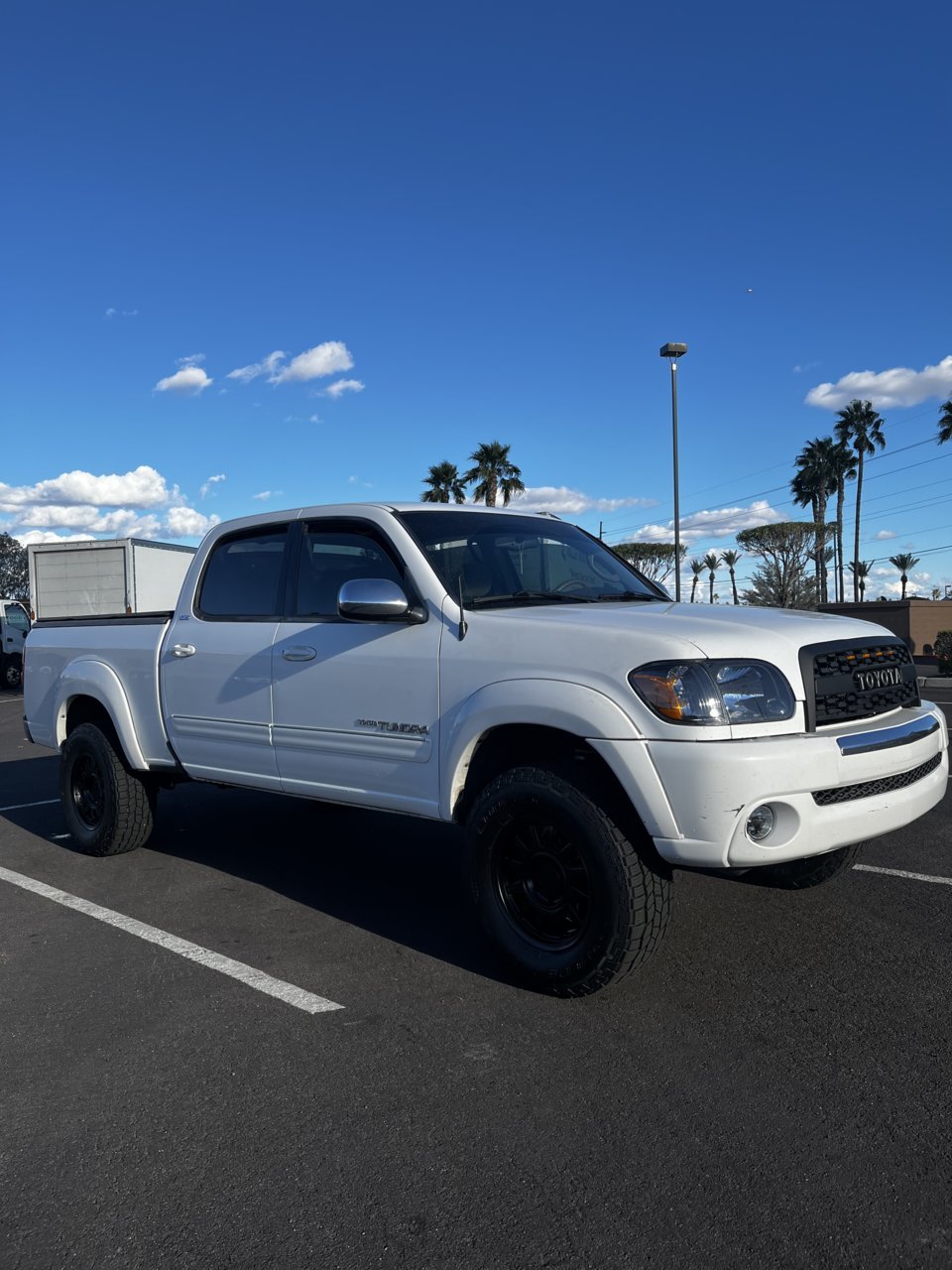

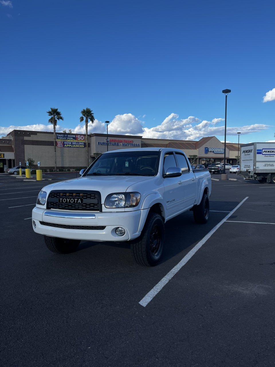

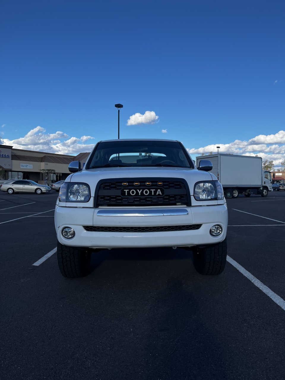

    It was a bitch pressing out the upper ball joints but other then that it went well.

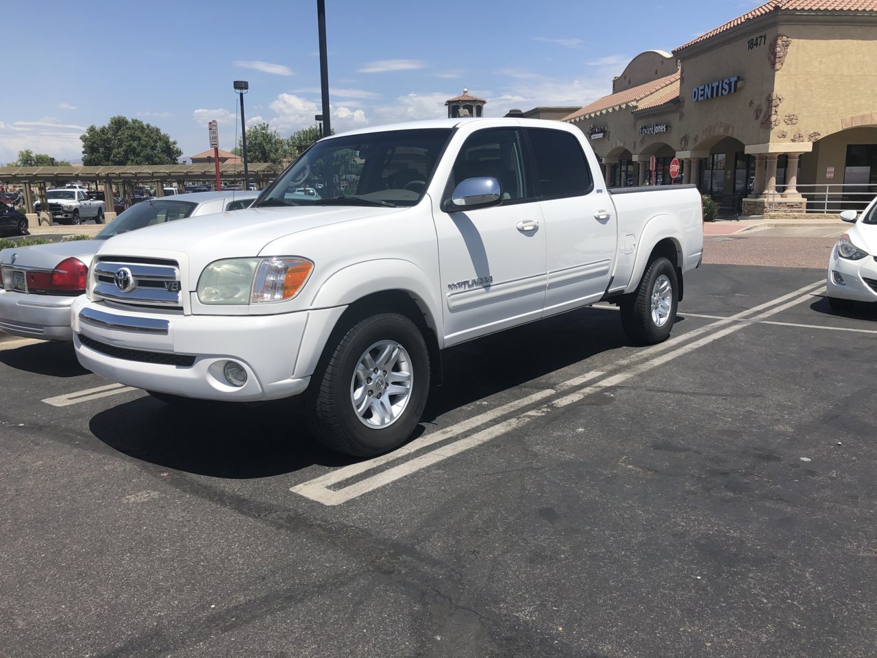

    Before:
    After: IMG_5351.jpg IMG_5353.jpgIMG_5358.jpg

    Looks good! Like a damn new truck :D
    Which Racelines did you go with? They're so dark I can't tell. I just bought some for my truck as well.
