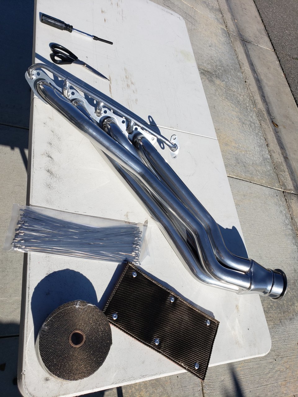

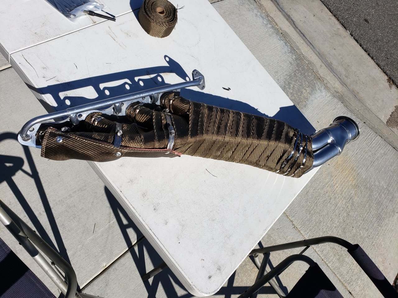

  8. May 12, 2020 at 8:29 AM
    osidepunker
    osidepunker OsidePunker
    Oct 19, 2016
    #4918
    3,000
    Alex
    SoCal
    2013 Tundra DC 4x4
    Full LT, full armor, fully self contained Speed Glamper
    you guys are just being mouthpieces for the interwebz
    Wrapping headers doesnt cause them to "rot" if you do it properly. Use high quality wrap and only do a single layer with 1/4" overlap. Dont wrap the weld joints. Wrapping ceramic coated headers is better than non coated as the coating helps the metal last longer.
    Headers are a performance part. They wont last as long as oem. Replace them when they need to be replaced.
    Now, I did it to control heat around my engine mounts. They did drop the temps by a considerable margin. BUT, they will not do anything to control noise. A proper exhaust will keep the sound levels reasonable. I am very happy with my @dirtydeeds exhaust, its not too loud, sounds great
