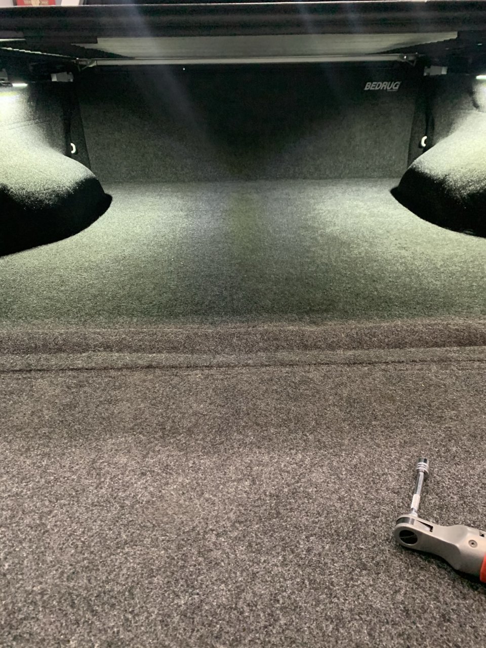

    Here you go..one 6” on each side. D84A0BBD-A3D1-43C5-86A4-C214272A469A.jpgD84A0BBD-A3D1-43C5-86A4-C214272A469A.jpg
    Shadowfax1[OP] likes this.

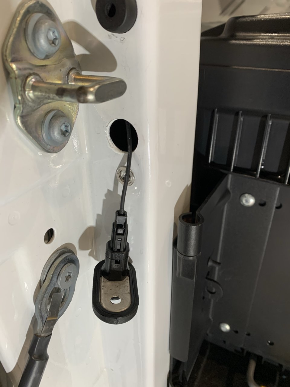

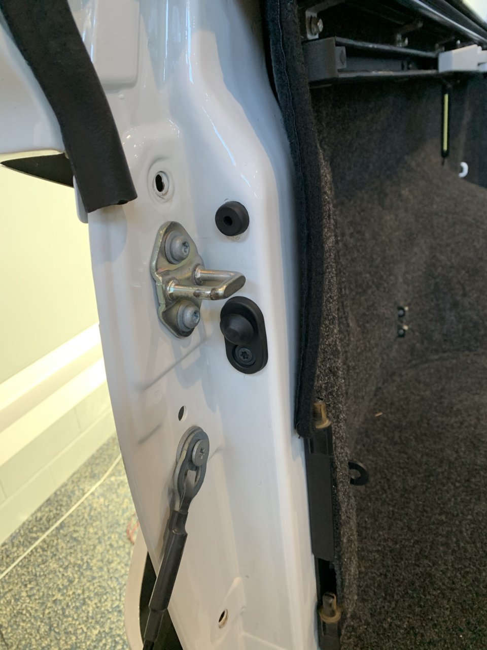

    I also used an OEM door switch to make my lights come on when the gate is dropped and off when closed. AFE5D097-3D8F-4A3C-B5AD-0A9008EE0AA3.jpg

    Wow. That's only two 6" strips? That's a good deal more light than I would have expected from only using two.

    Do you have a part number for that switch?

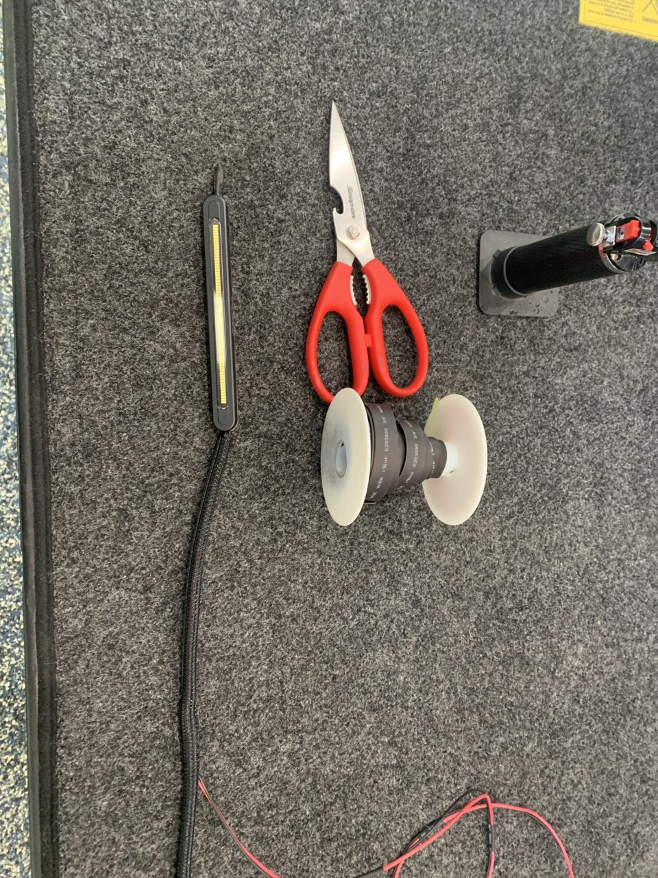

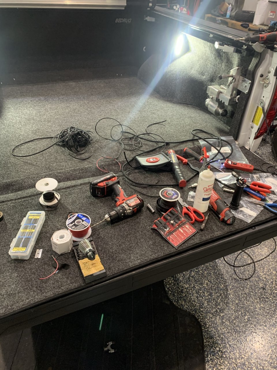

    I came straight from the battery with an inline fuse and then wired accordingly after that. I probably made it more complicated than it needed to be. I put Deutsch connections in so if I need to remove the bed I can just unplug them and all that....

    It didn't come with the fuse, did it?
    Beautiful job. Looks terrific.
    I don't suppose you have a step-by-step write-up anywhere?

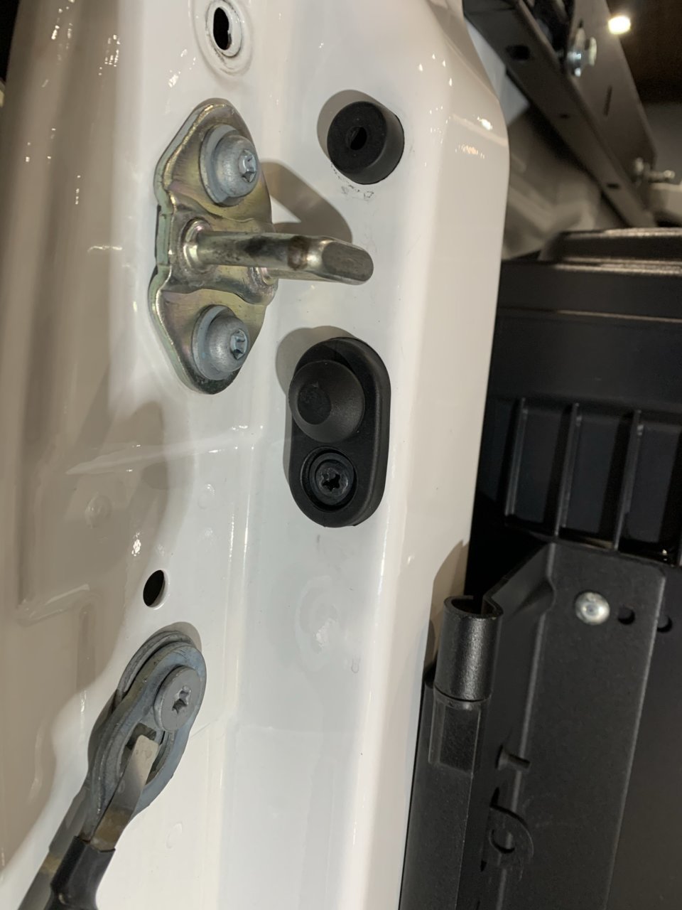

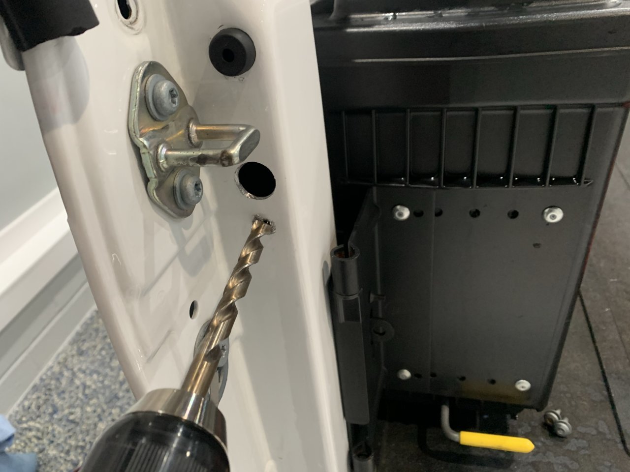

    I do not, I just went to the local pull-a-part and robbed a Toyota Tacoma. I think all Toyota’s are the same and make sure you get the torx bolt that holds the switch in.
    A0D747DB-112D-4A31-A616-7A08735ED833.jpg 02A7F49A-1311-445C-8C20-EAEDAE1B26BD.jpg 39C7F0BA-578F-4BD1-8759-D8DA4FAFF282.jpg

    No, they do not come with anything. I made a complete harness for them, but I work a lot with wiring harnesses so it’s not that big of a deal to me.
