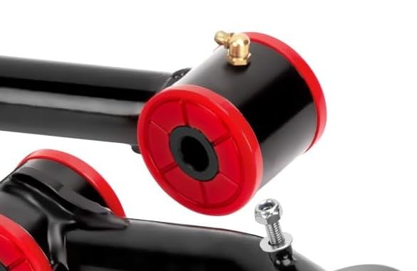

    I'd guess it'll be something like this: https://www.tundras.com/threads/solo-stock-length-lca.105150/page-3#post-2799305
    Essentially pop out your bushing, drill an appropriate sized hole for your chosen zerk, tap it for the threading of the zerk you intent to use, install the zerk, pre-grease your hole, install your bushing, install your part, then grease liberally thru the zerk.
    Just make sure you install the zerk mid-shaft, and in a place that's not going to hit a rock or get clipped when your part rotates, but will also be easy for you to reach with either a straight or right-angle zerk. Example on an a shitty aftermarket brand UCA:
