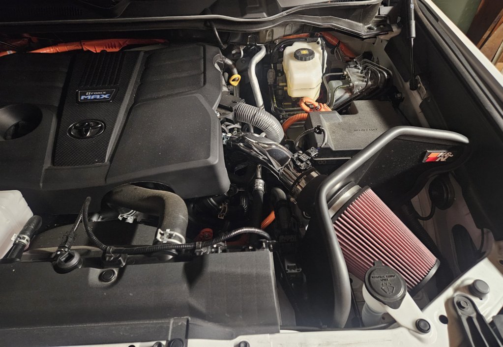

    K&N for me,put in over a year ago and zero issues.
    Love the sound of the turbos spooling up and you can distinctly hear the blow off.

    Yes, I also agree with that,until it gets tuned and hot charge pipes installed it's just throwing money at it but with just intake and exhaust installed it sounds 110% better than stock, period.
    I also think it is the objective of the OP's question.
