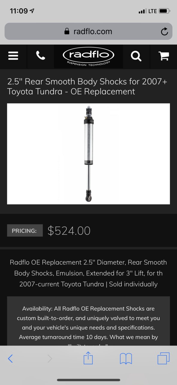

    Ya referring to these?

    yeap, but not with the 3" lift ones. and thinking i'd go remote resie's.

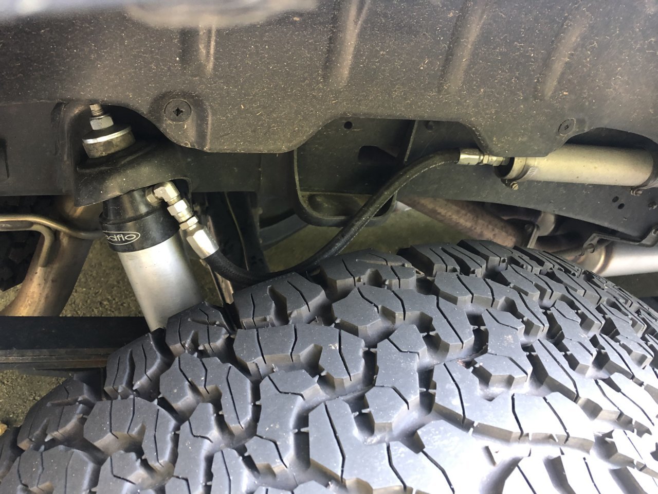

    I have the Radflo 2.5, I went with the remote reservoirs. I installed them in January and haven’t had any issues.

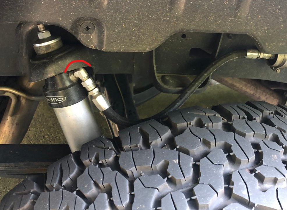

    The problem is with clearance for the resi hose elbow. If you make a small cut to the top shock mount it should eliminate that problem, quick red line edit on Phantom Lord's picture. I recall reading similar issues on the forum before, so this may not be unique to Radflo.

    I had the stock TRD off road before these so not much to compare to. I have stock leaf springs with Toytec shackles set at 1”. In my part of NC I mainly drive off road on narrow forest roads so nothing too high speed to really test them. I’ve loaded down the bed a bunch of times doing house projects and they handled that well.
    When I was installing them I noticed that. At the current angle there was between 1/8-1/4” clearance. If I rotated them 15 degrees clockwise it was really close and could possibly hit if the top shock bushing compressed at all.

    Yes, I was in the truck at the time. The elbow, from what we could discern, hit the bucket and broke. Radflow fixed it free of charge I believe. But UPS lost the shock/s, then found 'em..... Big, unfortunate ordeal.

    As other stated, my rear shock elbow broke due to clearance and we are assuming it happened during my high speed run.
    All fixed and good to go....
