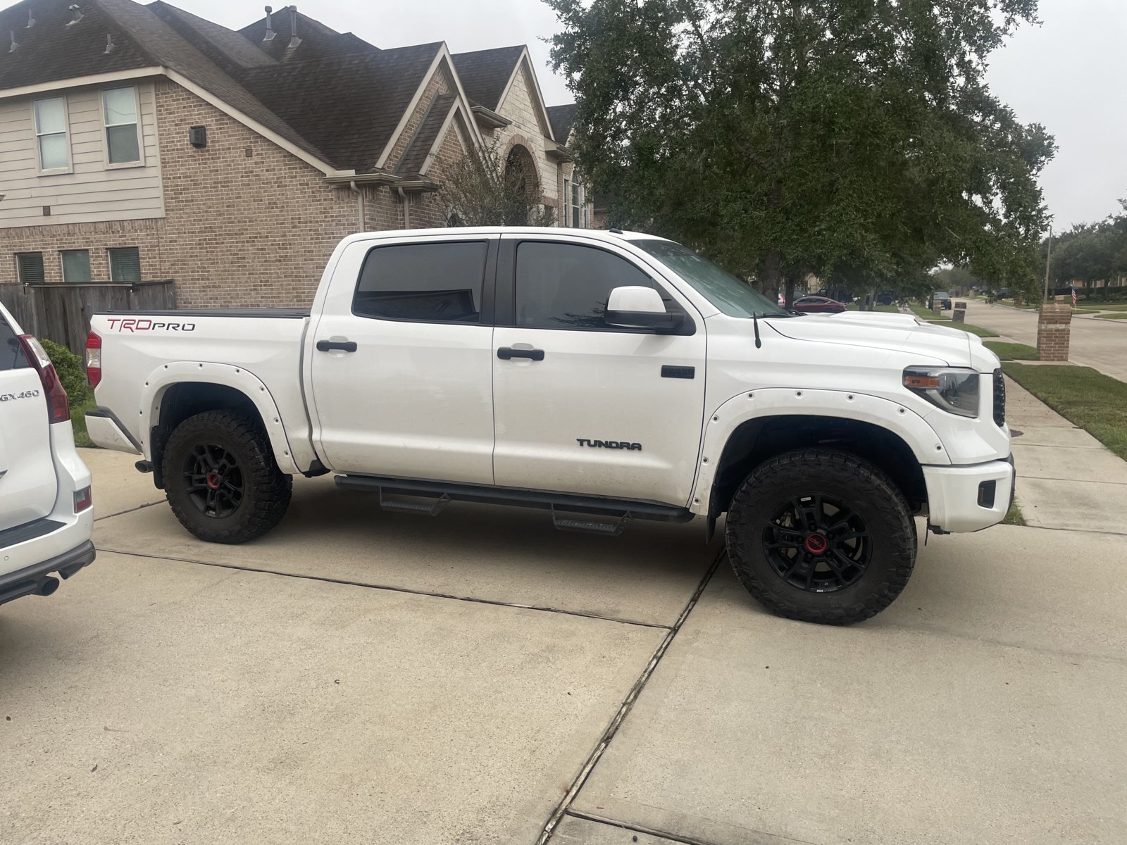

    If you are using the new Eibach spring, what are you doing to make it level in the rear? +1, +2 or +3 shackle? Any other options for the rear? Have the Eibachs for the front just want to make sure I'm level. Thanks

    I have the springs, coachbuilder steering kit, +3 shackle and new UCA ready to go on. From all the research I did it will be level.

    Sounds good. Have new UCA's also and +3 shackles. Now to install.

    Got it all installed. SPC UCA, super bumps, +3 shackles, Eibach coils and coachbuilder steering kit. Drives so nice.
