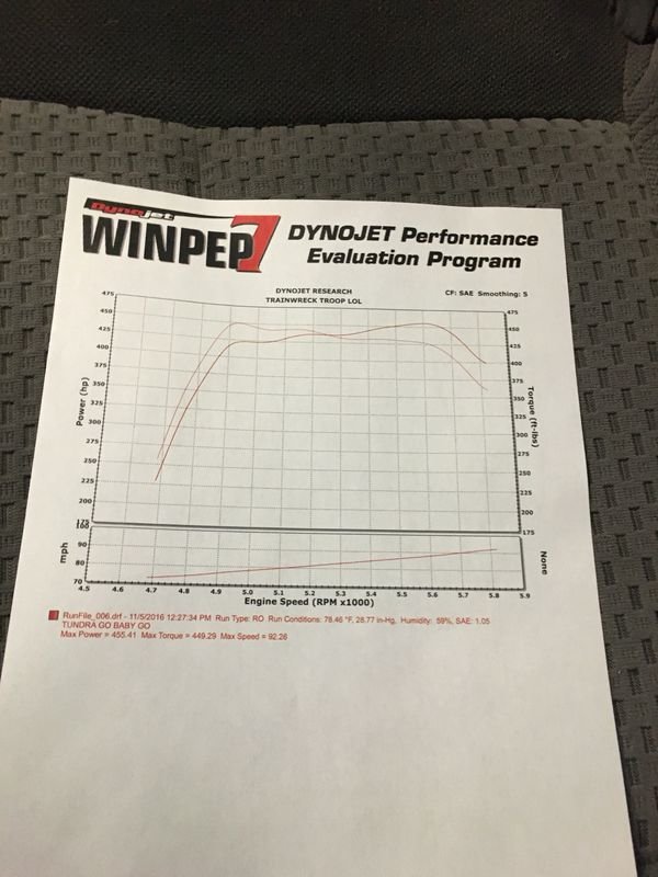

    For reference, TRD supercharger, stock exhaust :

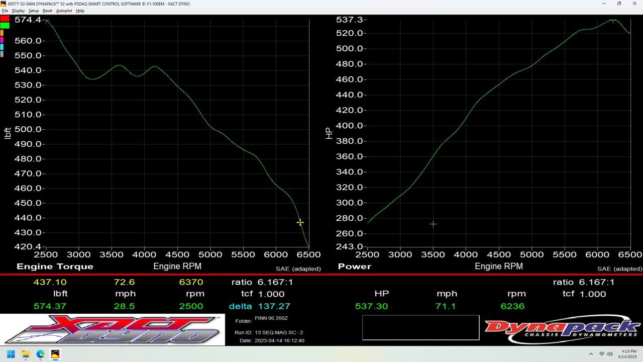

    Boosted 2013 Sequoia TRD FAUX
    My Sequoia did this yesterday.
