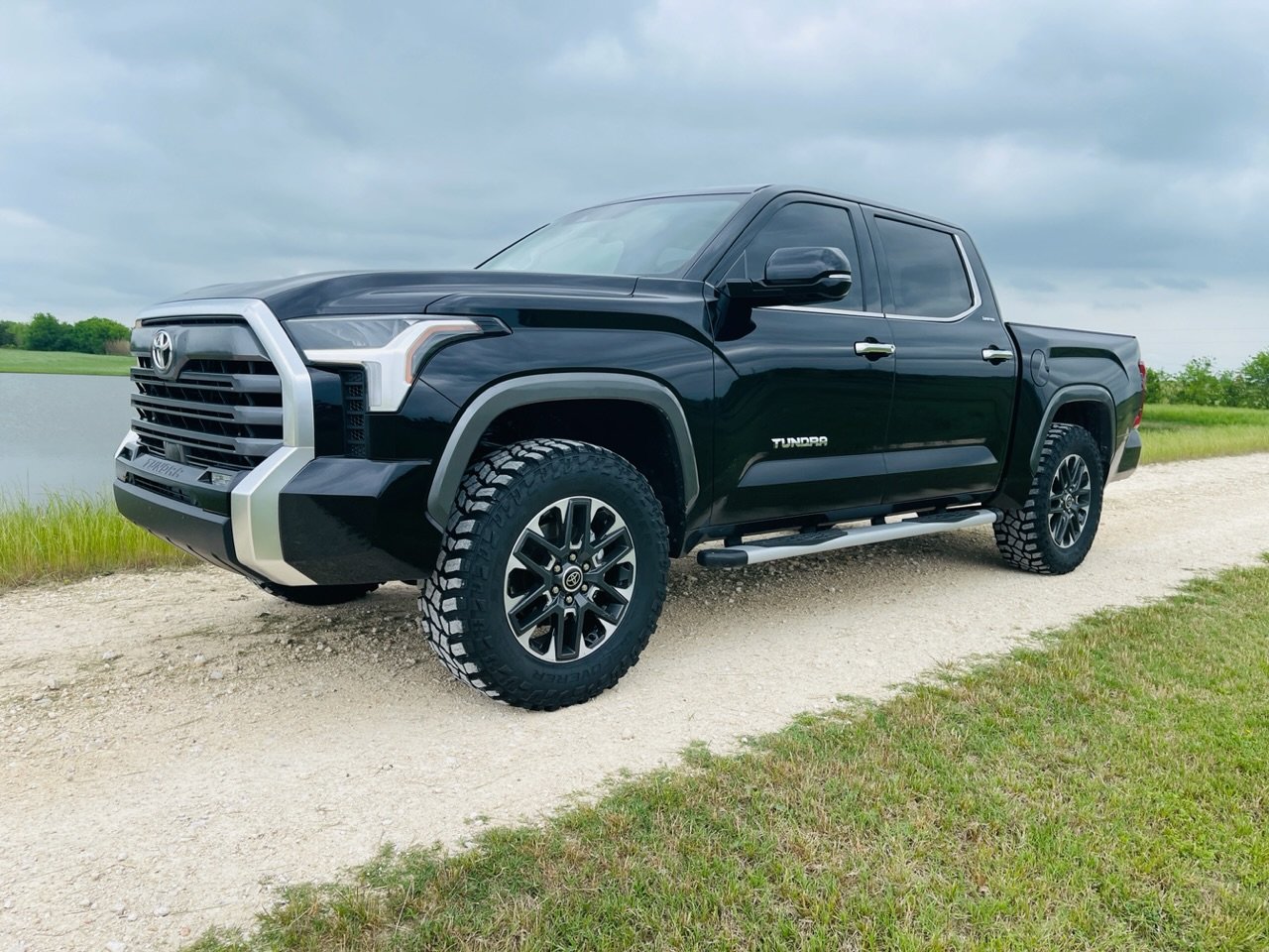

    2022 Tundra Limited 4x4 RC leveling kit and 295/65/20 Cooper STT PROs
    8791F78F-5172-4BD9-B6A6-1A85ED6E9ABC.jpg Yes I am.. well 295/65/20

    Any rubbing? Did u trip anything?
  4. Sep 30, 2022 at 5:43 PM
    vbobxSurf
    vbobxSurf [OP] New Member
    Sep 22, 2022
    #83749
    33
    2023 SR5 TRD- OR Tundra
    Toyota Tonneau Cover
    * trim sorry
  5. Sep 30, 2022 at 5:58 PM
    offshore2005
    offshore2005 New Member
    Apr 7, 2018
    #14258
    428
    TEXAS
    Nope no rubbing and there was no trimming needed.
