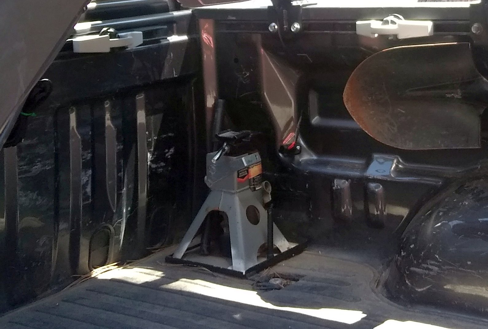

    Here's what I came up with. Pretty simple to make and holds the jack solid.

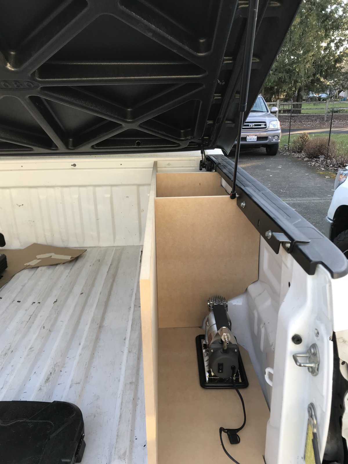

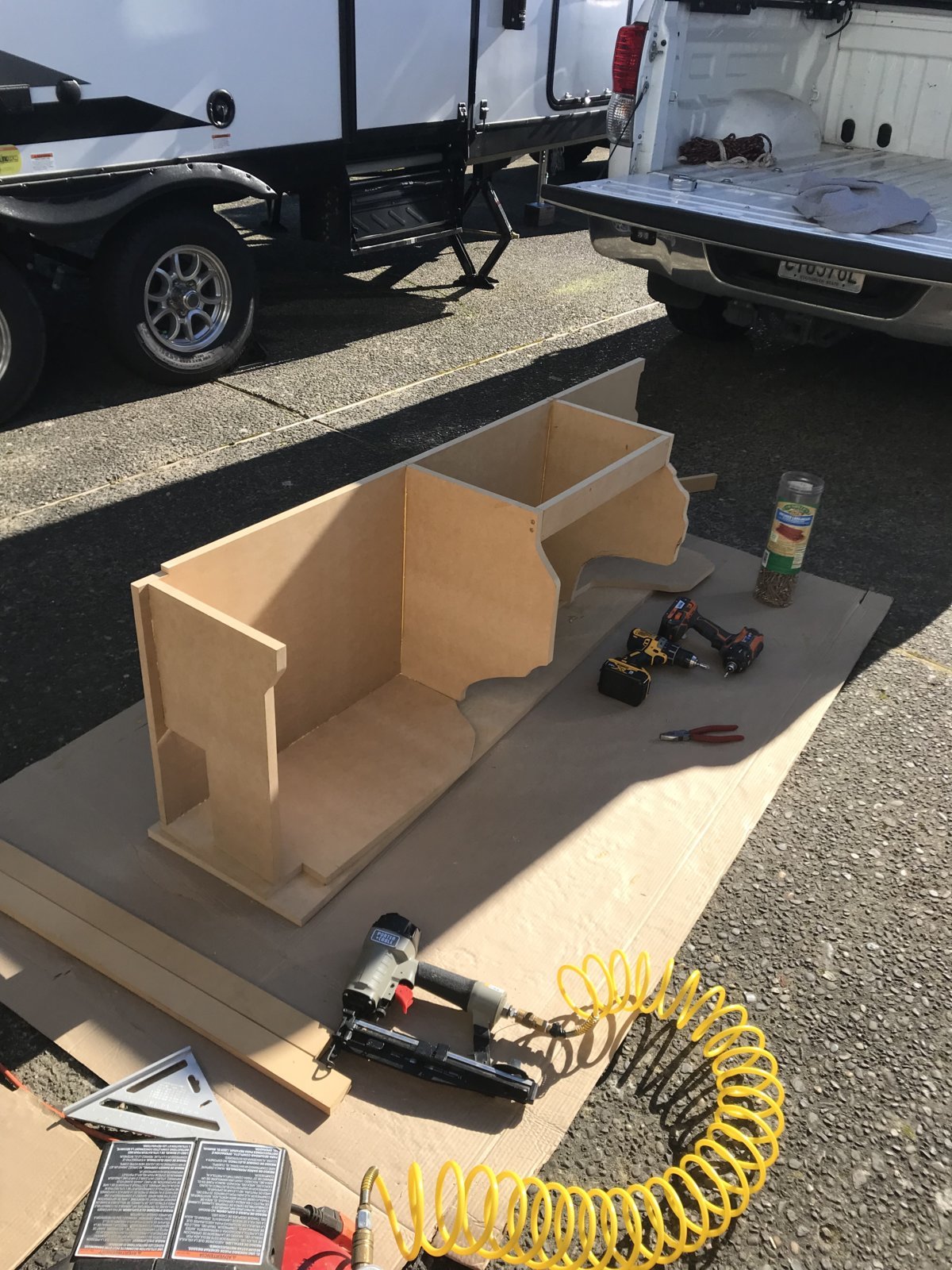

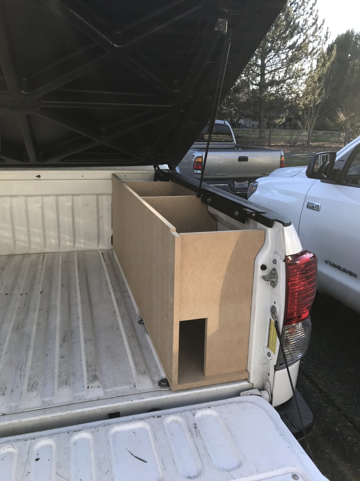

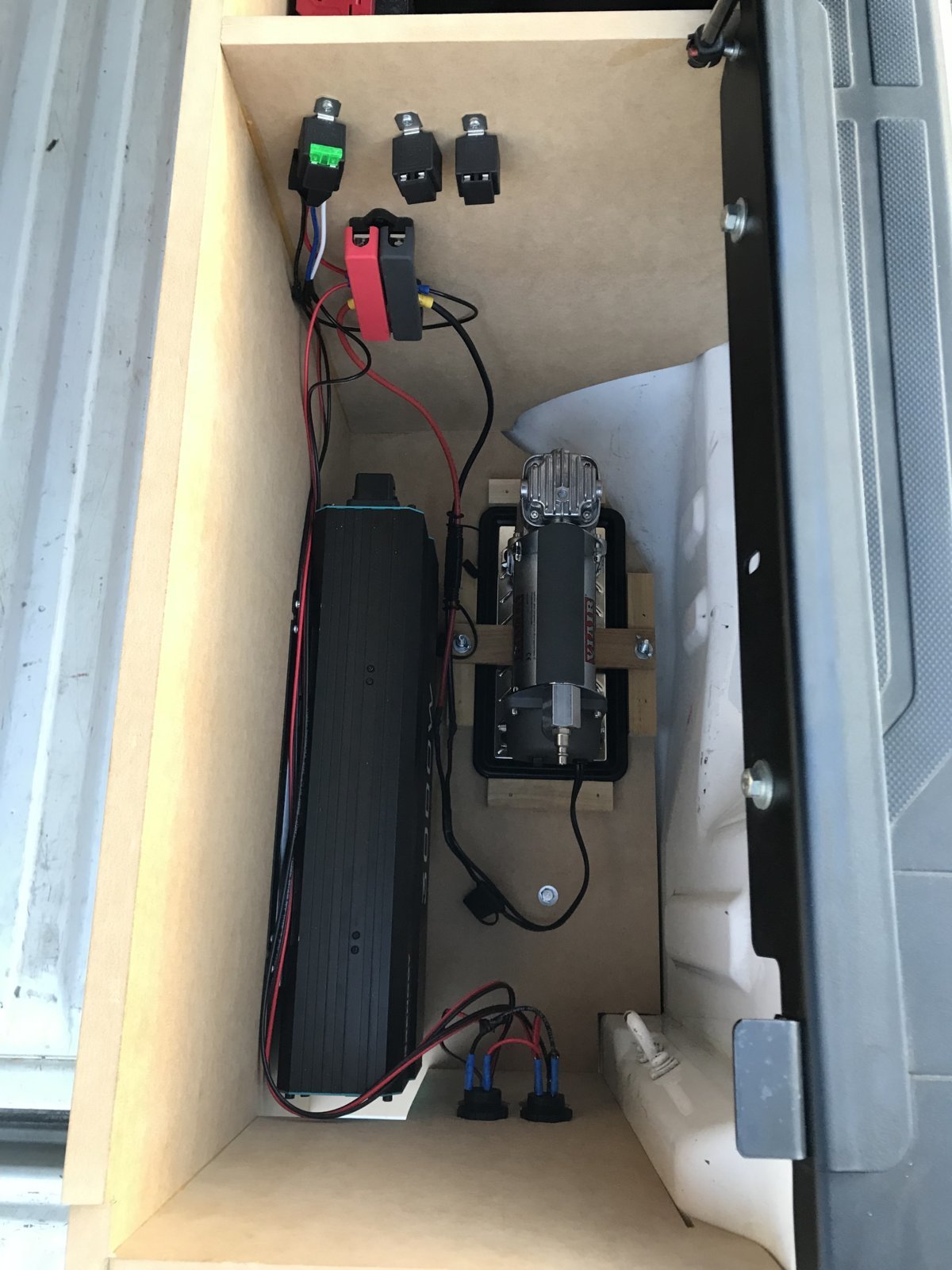

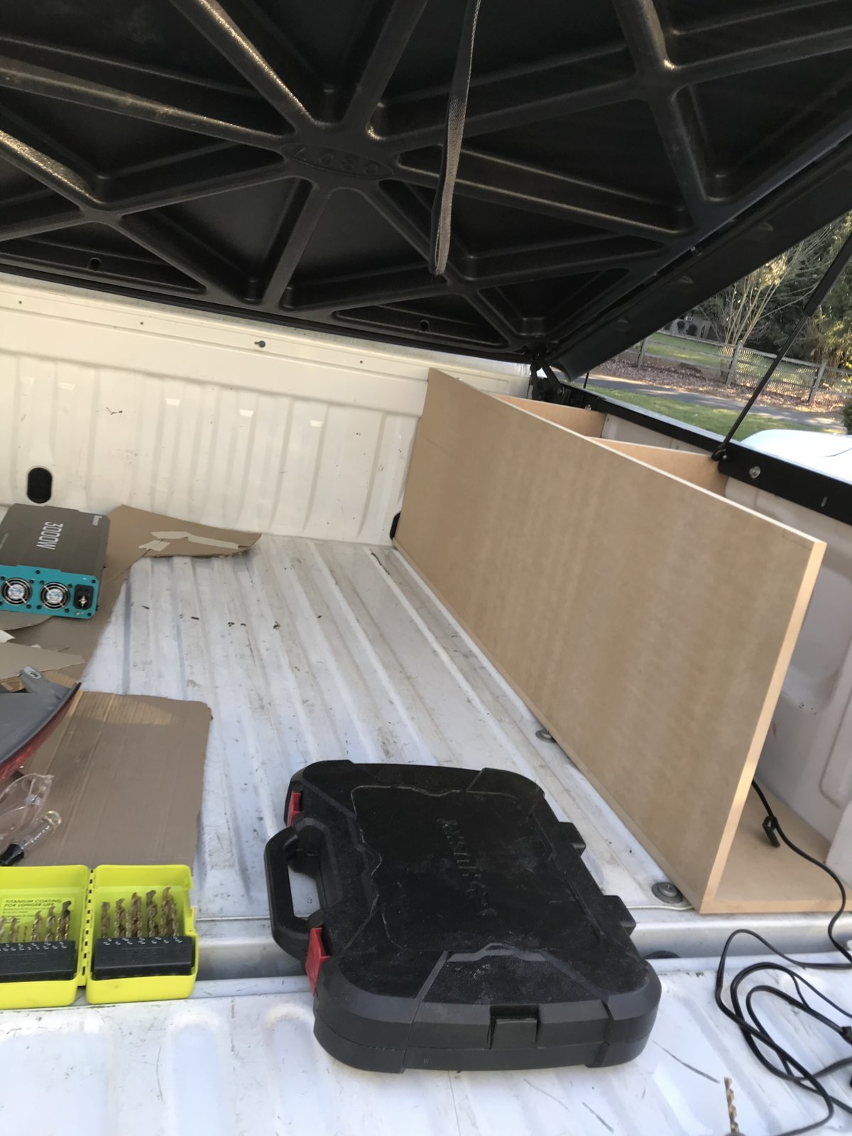

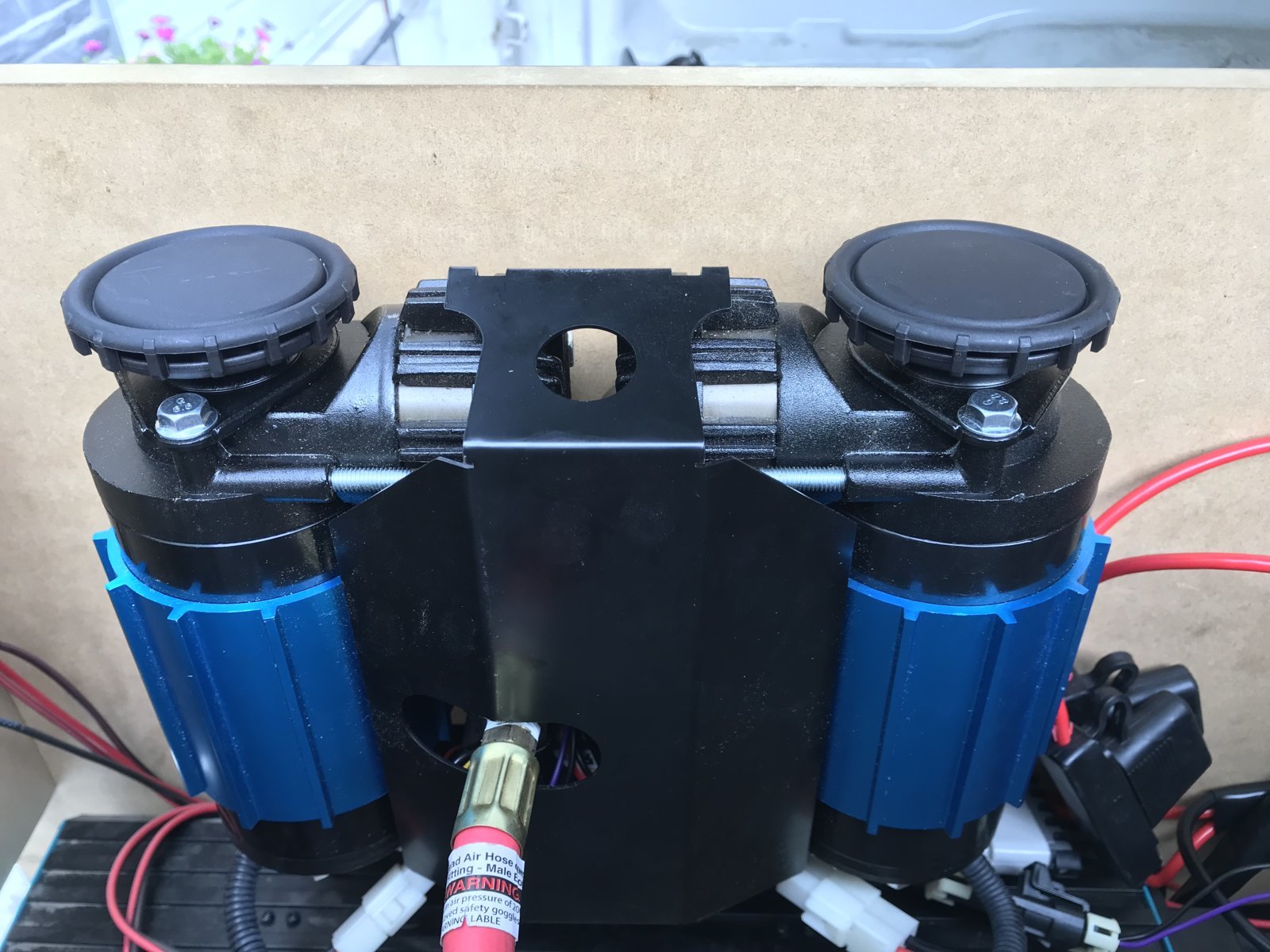

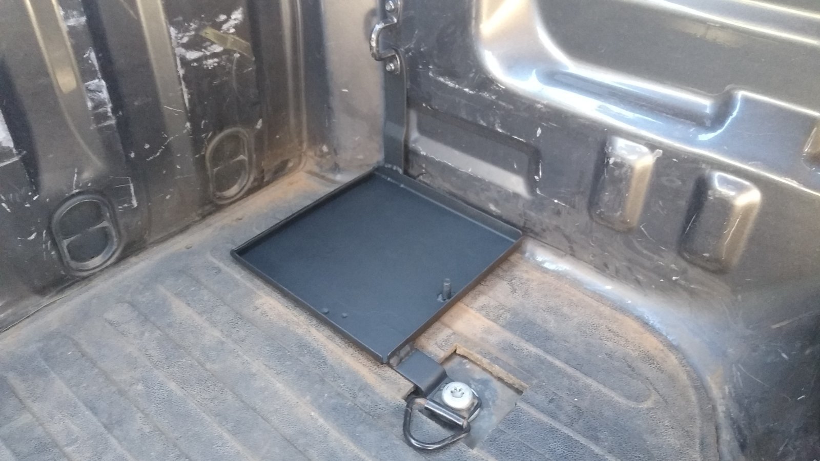

    I did not document all that well but here’s a few that I took along the way.
    The whole thing was built around my viair compressor a inverter and the husky tool set in one of the pictures. The husky case slides perfectly between the wheel well and the box wall in the middle section and the rear section is dedicated to power related items. The viair compressor is now in my brothers truck and I mounted a knock off arb and will probably be putting a battery where the viair was. Picture #2 shows the horizontal piece that sits tight to the bed rail and I hit 2 of the treaded holes that the bed track would mount to and then there are 4 bolts through the bottom with washers top and bottom. I used a bunch of cardboard and trial and error to get all the contours pretty close.
