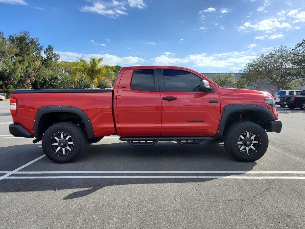

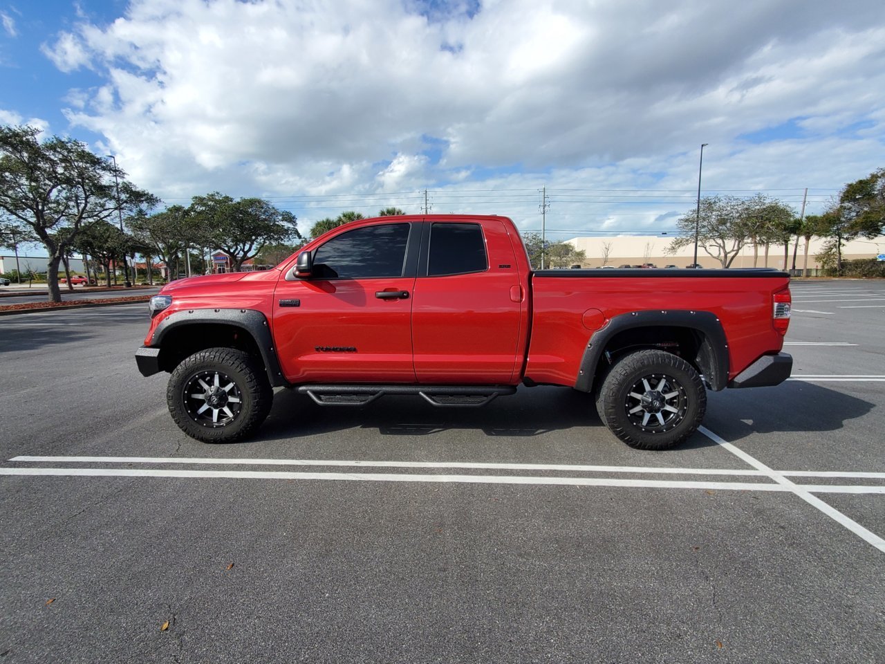

    Thanks for the pics looks pretty nice...I like it.
    I am thinking a couple inch lift with more off road worthy tires for my fire wood chores...

    Thanks. Sitting on Toytec Alumas up front. Toytec shackles with 1/2 blocks in the rear. Almost 4 inches in the front and 2 in the rear. Wheels are 0 offset with 285/70/18 (34's) Ridge Grapplers.
