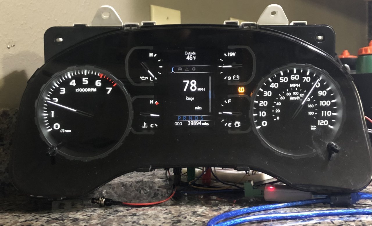

    Long shot here but hoping someone has logged or has the ability to log some of the CAN Bus data on a 2018+ Tundra. Just a text file with the raw data would be awesome.
    I am in the middle of a project retrofitting a 2018+ instrument cluster on older Tundras. The 2018+ has all the new Safety Sense systems with new CAN addresses, additionally the TPMS is now on the CAN
    Making good progress but need some CAN data to control the display screens in the cluster.
    If I have to I may break down and see if I can find a local Tundra to rent for the day.
