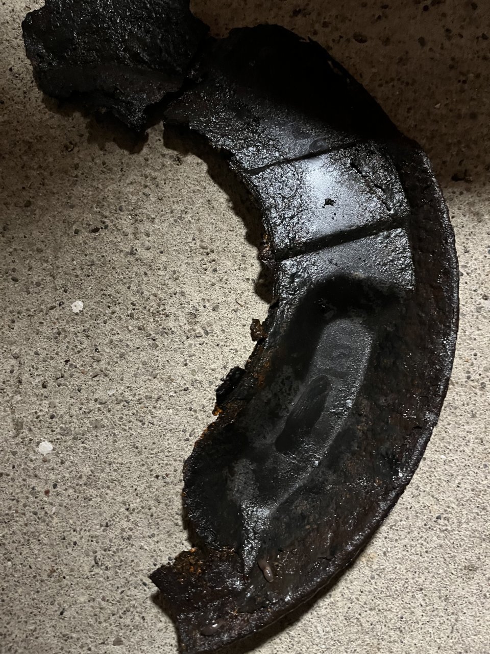

    I found this under my truck. 2006. Obviously rusted off.
    It had a bar code sticker on it that had 4R 049 on it.
    any ideas???Thanks!

    Looks like part of the dust shield for the front brakes.

    Brake backing plate for sure.

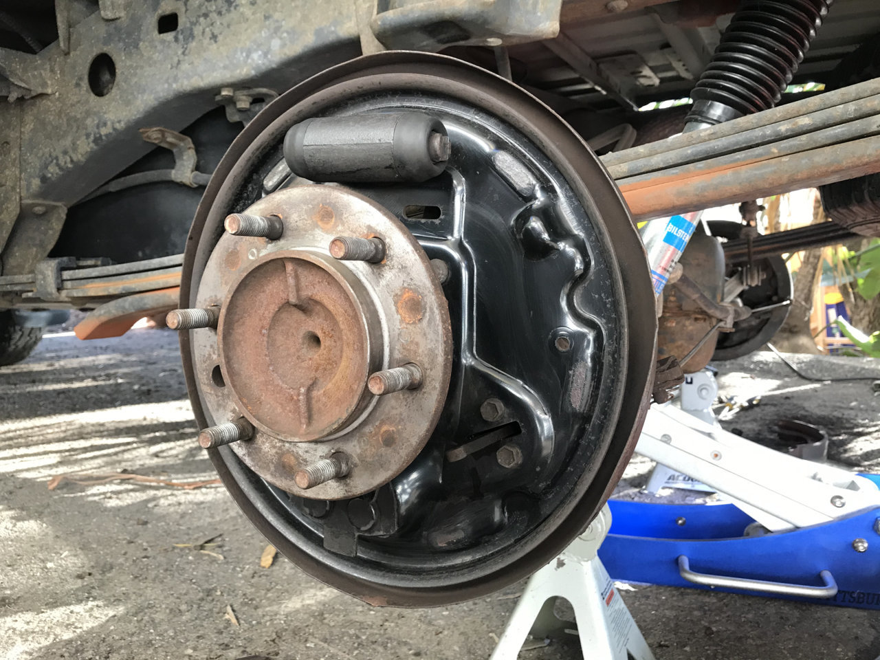

    Looks like the rear backing plate and it’s super oily, take a look before you drive it more

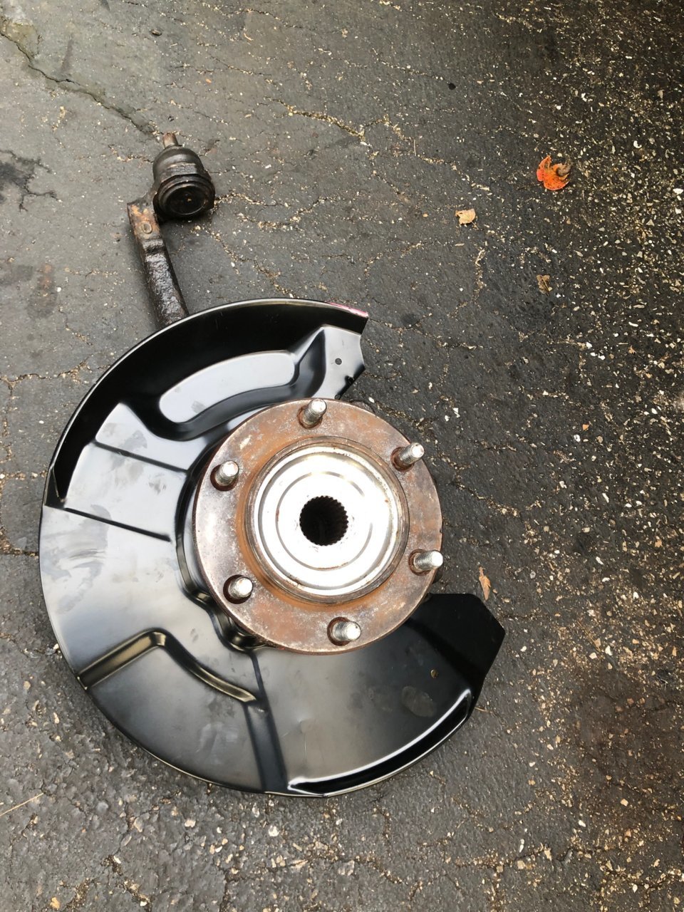

    You need a shiny new one, like this
    Aerindel and FrenchToasty like this.

    Do the '06s have drum brakes on the rear axle? Even so, isnt the parking brake mounted to the backup on rear discs?
    Methinks this truck is not roadworthy.

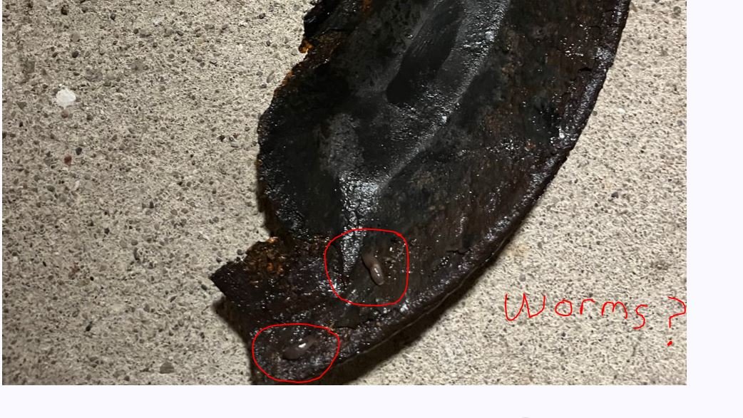

    Those look like slugs to me. If this fell off on the ground, that would totally make sense.

    Oh wow. I didn’t see those! It was sitting in my driveway after a rainstorm.

    Brake backing plates rusting off is of itself, not a big deal. I've seen that happen a lot on subarus for instance with no other rust. They are a lot like exhaust parts, thin metal exposed to high heat and which are always pelted with whatever water and rocks you're driving through. If something is going to rust off your vehicle, they are among the first to go.

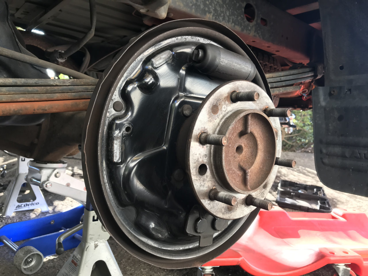

    Negative. Its the front. The rear plate is thick steel, and holds the brakes together, if that rusted out, he would know it. Its the front, its much lighter, and is just a dust cover/debris shield.

    I would agree now that I have watched several videos on replacing the front rotors. :thumbsup:
