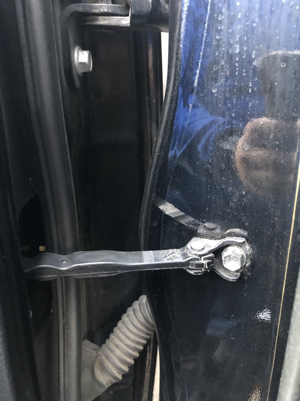

    Does anyone know what these are called and if they are hard to replace? ~Pic attached~
    The one on the driver side makes a loud popping noise every time I open the door. I think it’s cracked or something.

    I think that is called a door check. Make sure but this is what I think it is...OOPS I looked it up for a 5.7 than saw you have the other engine. Shouldn't make a difference but call @Roman at Sparks and make sure.

    @Roman doesn't work for Sparks, he works for Toyota of Cool Springs.
    Unfortunately their online store isn't taking orders right now.
    https://parts.toyotaofcoolsprings.com/
    Although I do think you have the right part.
    It is cheaper here..
    https://toyotaparts.bochtoyotasouth.com/oem-parts/toyota-door-check-686100c023
    @skphillips78 you could try messaging @Roman and see if that is the correct part.

    Wait, it's not normal for it to pop??? My driver side rear door has popped since "new"...

    Spray a little lithium grease on it.

    Try tightening up the studs on door and body. Think 10mm socket. Sometimes they loosen and create that popping noise.

    I had that happen on my Camry. I loosened the bold and slightly moved the latch and re tightened and the popping went away

    That's called a "doorcheck".

    Yes they break. Ive replaced both on both of my Tundra's. The right side of the door check where the pin goes through should not have a crack in it. The popping can also be from the inside. Basically it pulls on a plastic tab against a metal plate. That tab can easily wear out. There some video's online of removing the door panel. I was able to reach in without removing anything else. It takes a little work but less time consuming. Total project was about 15 minutes.
    https://www.youtube.com/watch?v=2KHUaUM_q28

    Also called a “detant” or “detent”.
