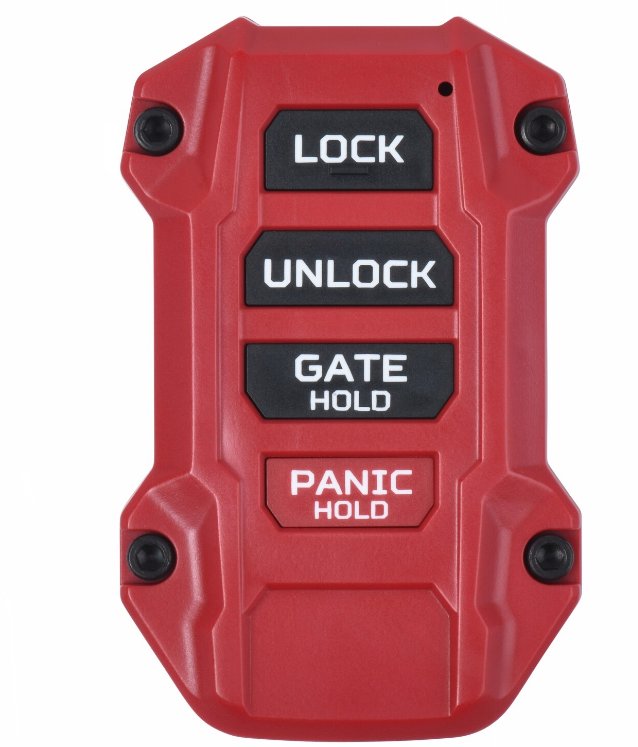

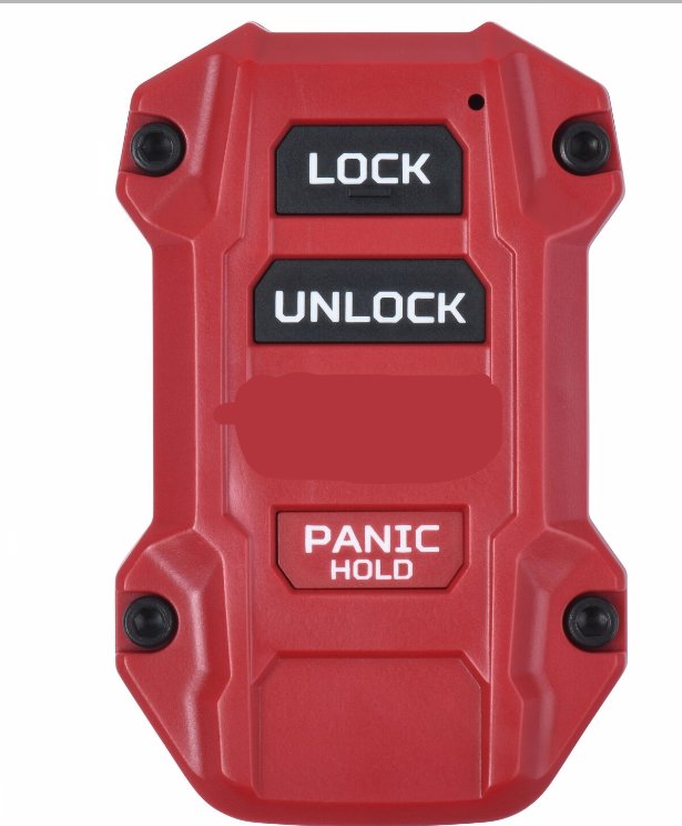

    https://www.ajtdesign-llc.com/online-store/IF020-2022-Tundra-c133985592

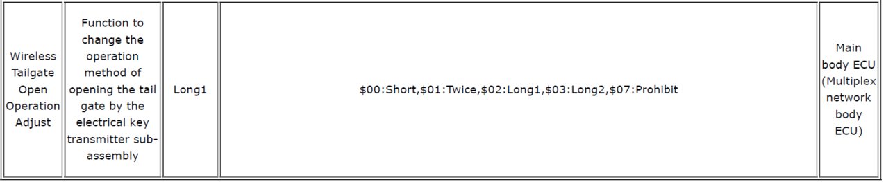

    I didn't take it to the dealer, I did it myself using Techstream I have installed on a spare laptop.

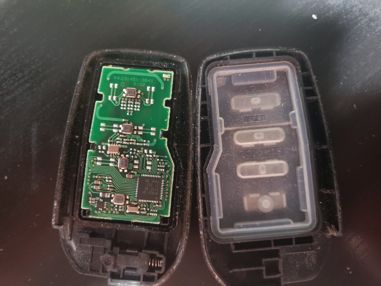

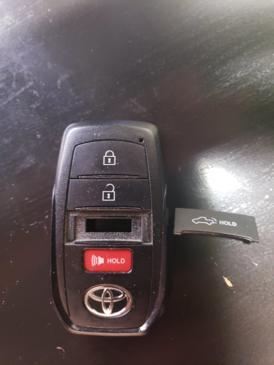

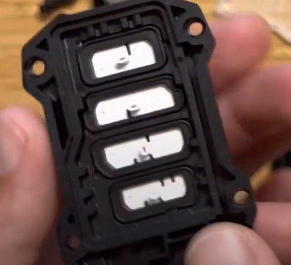

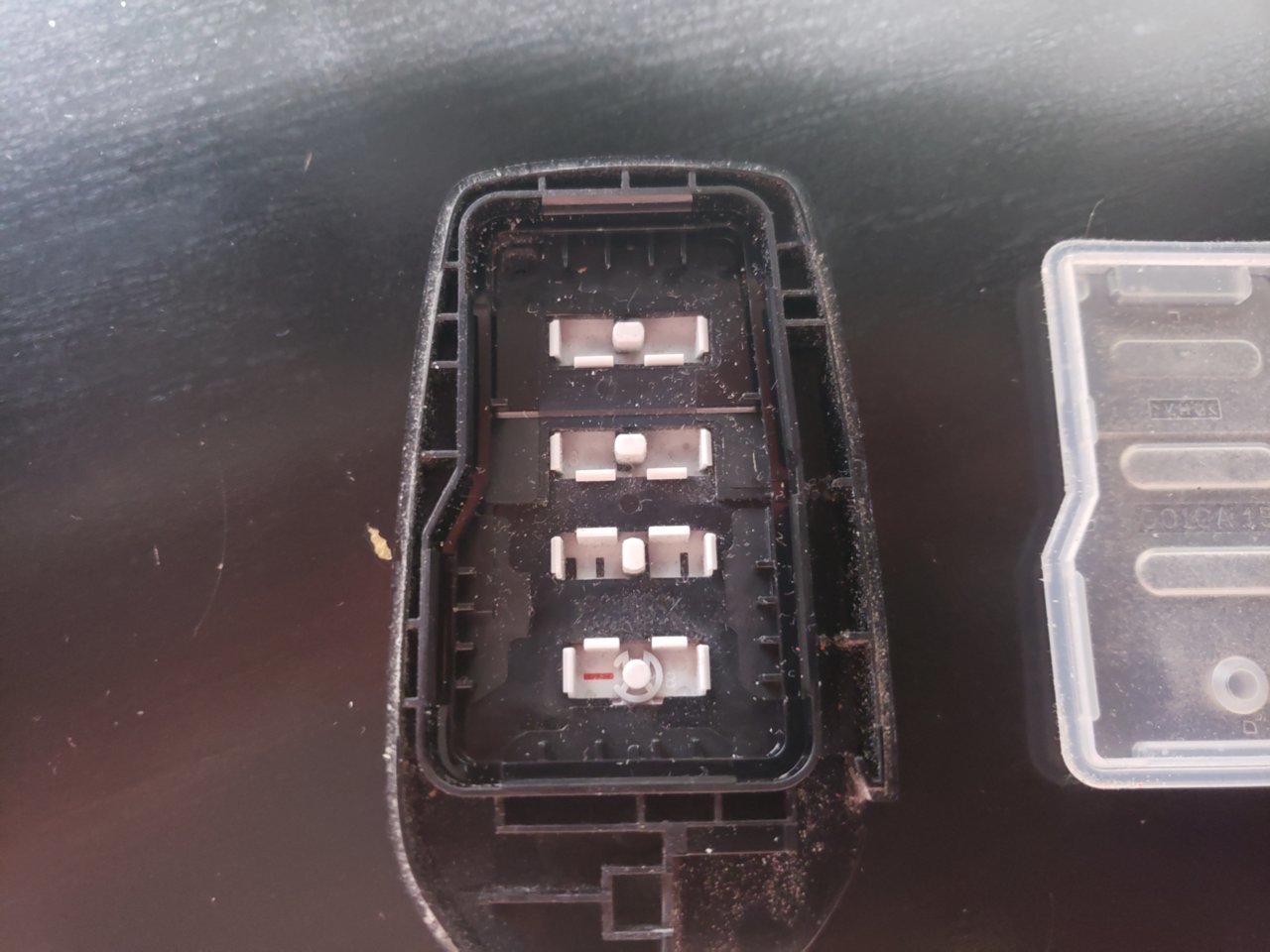

    well i went and yanked my key apart, so it looks like they are micro switches in the keyfob, not like other makes where the rubber membrane makes the electrical contact across two pads.
    if you don't have a techstream, or dealer wants to charge or whatever
    looks like you could A. cut the little nubbin off the back of the button to where it wont make contact with the switch. or B. remove the switch button entirely by pressing the lttle tabs on the back side
    watched the AJT video, theirs is made in similar way, could cut the nub off the button, maybe see if they will sell an extra gate button and be able to swap back if need be

    As others mentioned, just disable it with Techstream or Carista. Inexpensive and very easy to do with Carista. I have a VW Atlas that gets parked in the garage and did the same to it. Can't have that hatch accidentally opening up against the wall, or my tailgate dropping into the wall....
