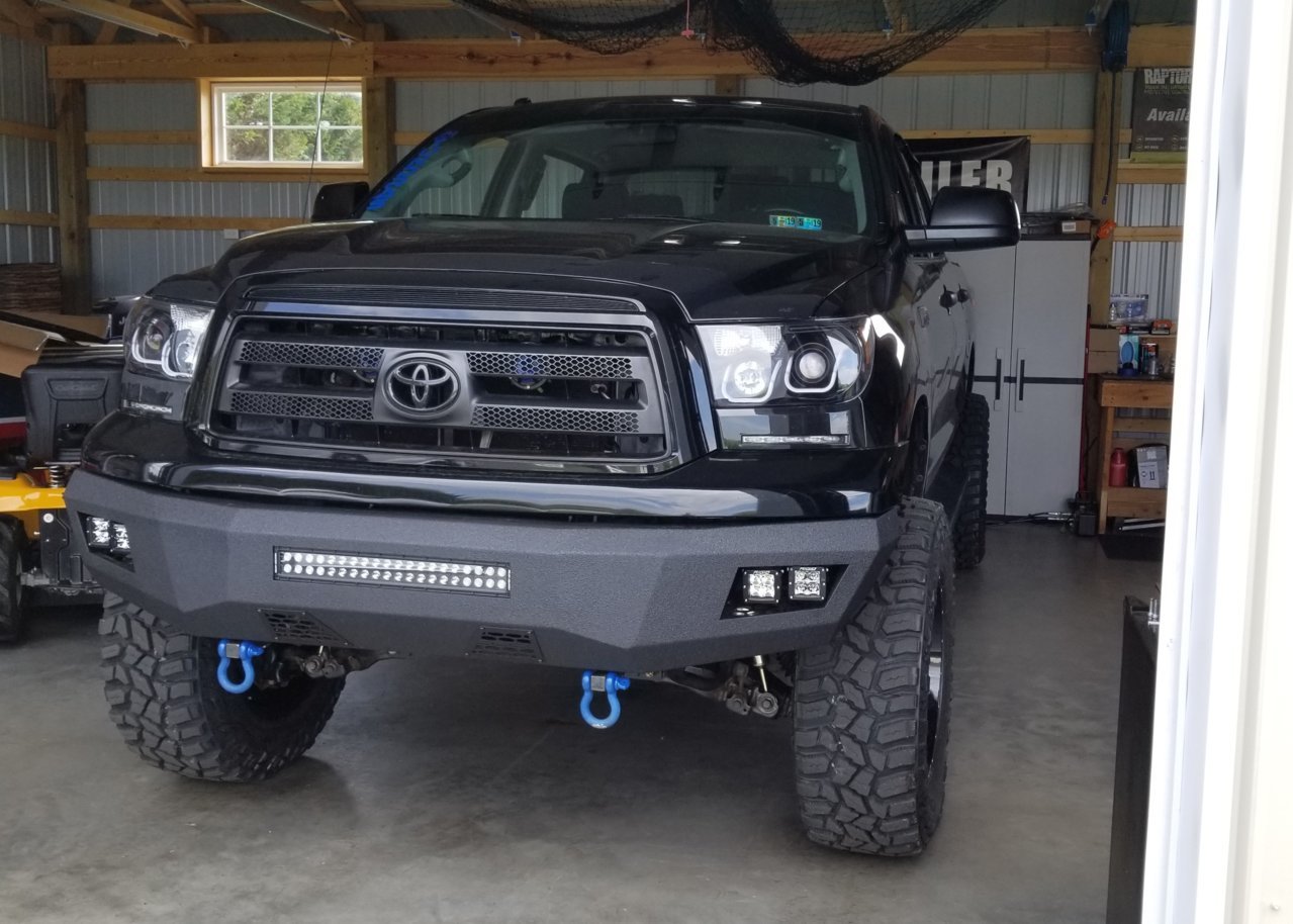

    I have a 6" lift, and have the lean going on here. I'd like to do 1/2" CB shim on the right side to correct this. Any drawbacks to this?

    I want to do 1/2" on the right side, and 1" on the left. The left currently sits 1/2" lower. I should've specified... The 1/2" on the right side would put me a total of 1" higher than the left side, then a 1" on the left side to bring it all up and level. My question was, I already have a 6" lift, I didnt know about going the extra inch, and the negative effects on my CV angles.
