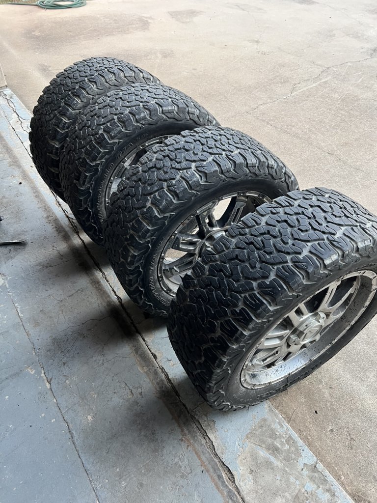

    Picked the tires up from my friend today. They are 285/55/20 instead of the factory 275/55/20 but close enough to stock. Certainly smaller than the 275/65/20 I’m currently running. Found a set of TRD wheels I’m going to pick up after payday for $250. May try my hand and mounting the tires myself or finding some small shop to do it. Hopefully I’ll be able to try it out this weekend.

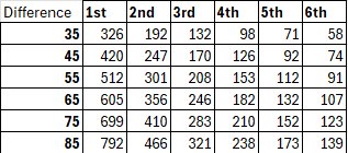

    Here's some numbers of RPM at various speeds with the 34's and 32's. Really not a big difference.
    upload_2024-11-20_14-0-22.pngCurrent 275/65/20 with 5.29's
    upload_2024-11-20_14-0-37.pngNew 285/55/20 with 5.29's
    Difference
    Smaller tires weigh the same 51lbs as the larger tires (BFG KO2 D vs Firestone Transforce AT2 E). Not sure what the wheels I currently have vs the ones I'm getting weigh but I'll find out soon. Should be picking them up tomorrow.
