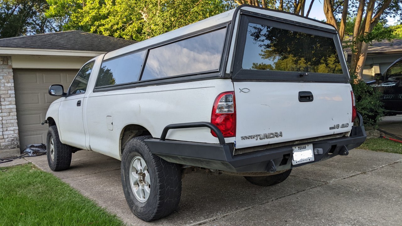

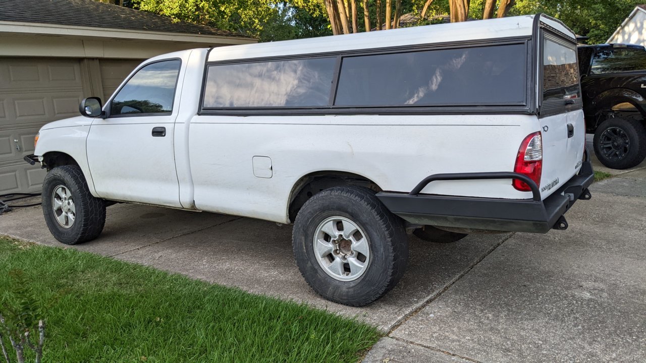

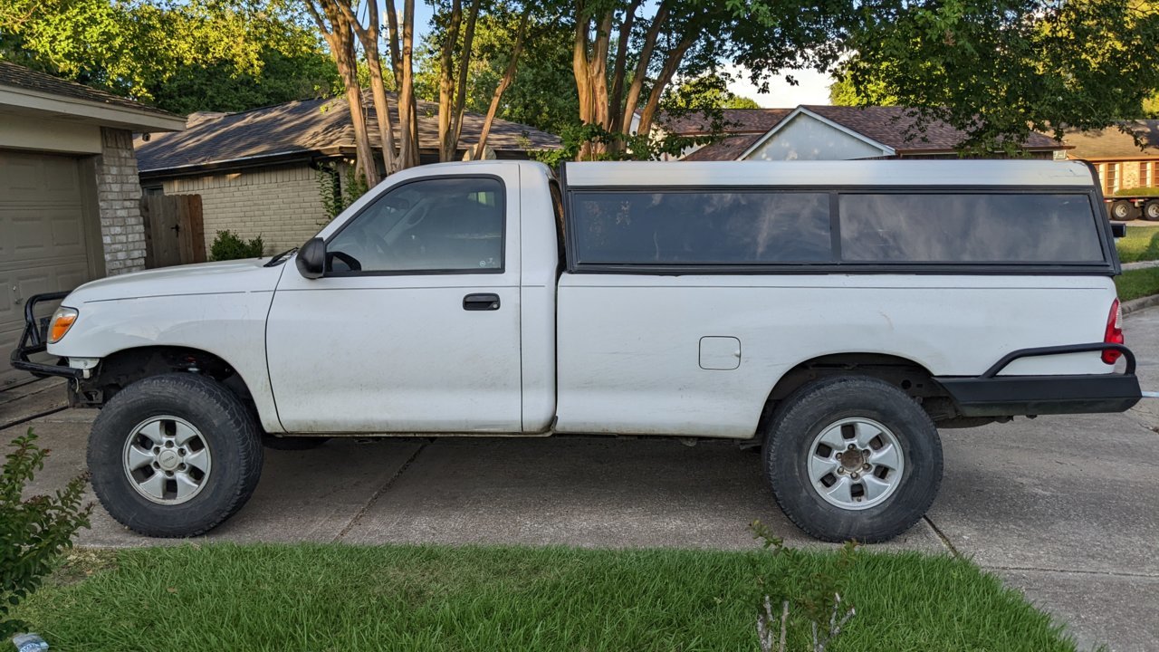

    PXL_20220603_002927611.MP.jpg PXL_20220603_002937424.MP.jpg PXL_20220603_002947306~2.jpg

    Also just in case anyone points it out, I have a 1.5" AAL kit from Toytec that I have not yet installed in the rear which will bring the rear back up to level. I recently built a tool box with slide out drawers the entire length of my bed, but allowed me to move the majority of my tools (about 350 lbs worth), over the rear axle which helped with traction and balanced out my truck while rock crawling. So the rear sits a little low now. The 1.5" lift will bring it back up.

    Are you missing a lug nut on your rear wheel?

    Pretty sure that the nut that is a generic "open" lug nut I got from the Napa. It's the same thread pitch and size as the factory lug nuts, just much shallower so it sits further down in the wheel. Good looking out though
