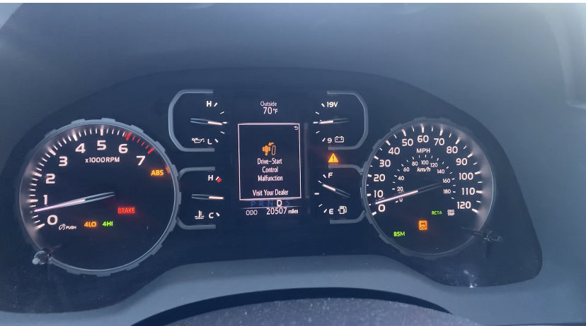

    anyone every have their dash just light up like a Xmas tree? Was driving and BOOM, 6 lights came on at once and 3
    Error messages in center info screen.

    I can go full speed. I was going about 10mph and went through a dip, which I have gone through way faster before, and all of a sudden it lit up. All hard codes, turn off and back on and still present. Would love for it to be something like alternator. Just got done going through a Lemon Law buyback on a 2019 Durango SRT and I am already having electrical flashbacks that it had. :(

    It ended up being the left side exhaust bracket broke and the pipe shifted and came down and perfectly pinched the speed sensor wire between pipe and rear axle when travel was compressed. Sensor is still fine, going to reroute anyways and once exhaust is welded back up, good to go with a new wire. "Shouldn't" be a warranty item, since it was aftermarket exhaust weld that broke, but service writer found a way to make it happen. ;)
