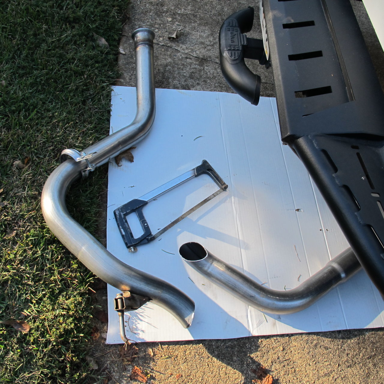

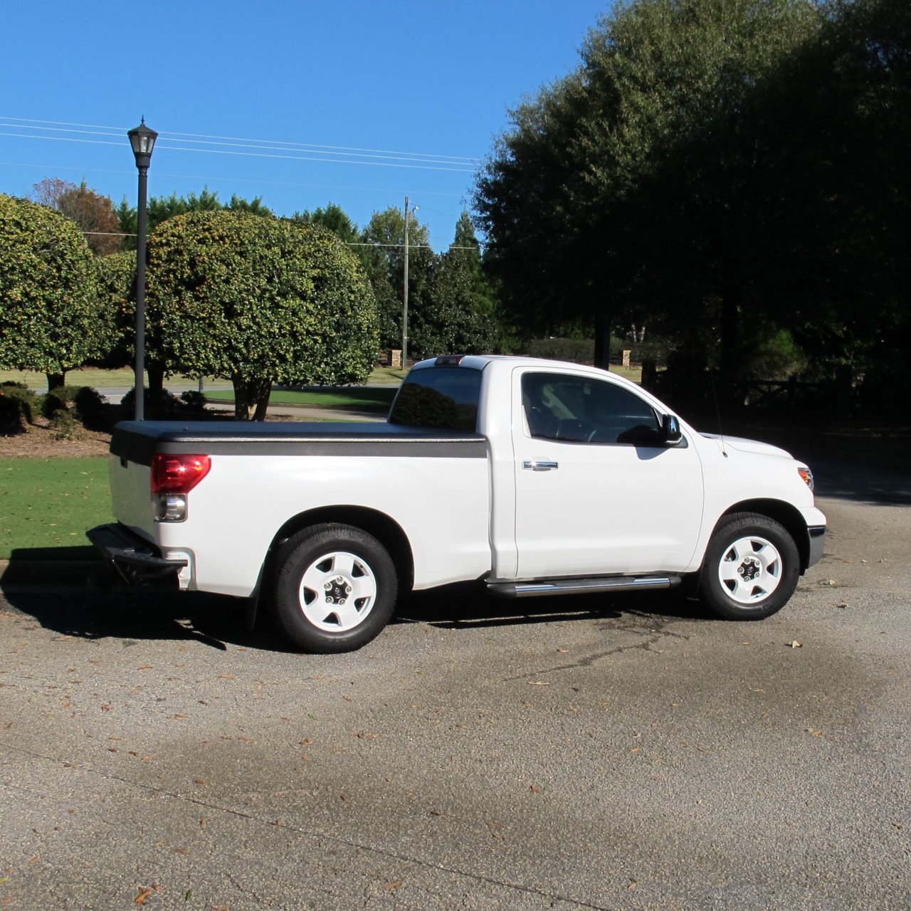

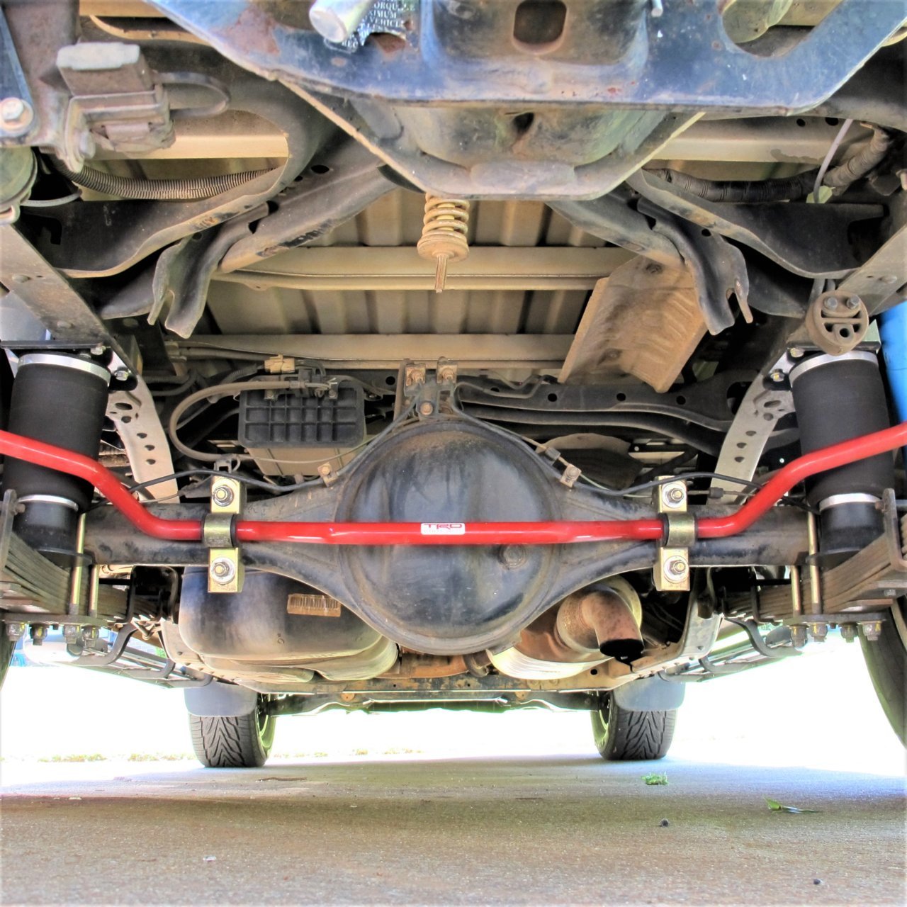

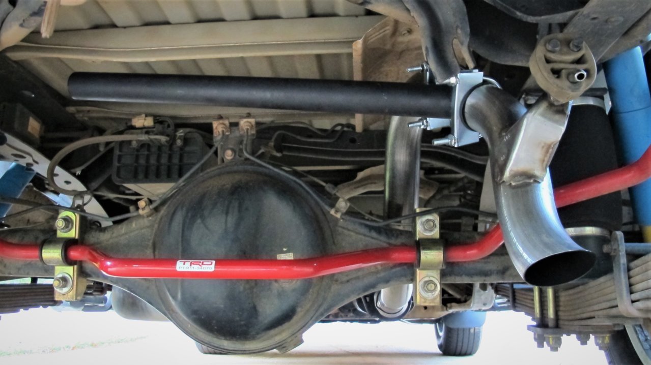

    I lowered the bed 3.25" using kit from S.O.S. Performance, the new leaf springs are from Alcan because my OEM springs were toast after 270,000 miles of hard work.
    I ended up bringing the tail pipe over the axle when I installed my custom exhaust from Dirty Deeds.
    24" of pipe was removed because it would no longer clear the leaf pack.
    The ride is great, I did not loose any ground clearance, and the truck sits level.

    @Rex Kramer , that’s exactly how I’d like mine to look! Thanks for sharing
