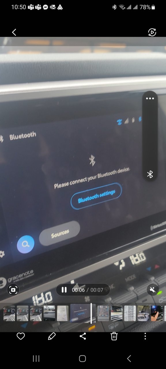

    The best way I can describe it, is the radio head loops Bluetooth disconnected connected and usually with a bit of finicking with the head unit and my phone I get a solid connection.

    It also disconnects and flaps for me. I haven't tried android auto but my Bluetooth was working fine in a 2017 tacoma never had one disconnect issue.

    Mine isn't plugged in at all it's always wireless, its the Bluetooth that keeps disconnecting randomly and looping and then sometimes as you start the truck you won't be able to play any kind of music/audio from your phone for several minutes.
    I notice if I shut the truck off entirely, turn it back on its quicker then waiting for the bluetooth loop sometimes. It's very annoying..
    You would think for a 2023 these type of issues would be long fixed ago. I had a 2008 Tacoma, no bluetooth issues ever, I had a 2017 tacoma no bluetooth issues ever, its the 2023 tundra that has issues with it. The same phone in my pops silverado instantly connects with 0 drop issues on a 800KM trip easily.
    For the S&Giggles out of it, I even connected a S22 Ultra to it, and I am able to replicate the issue quickly.
    I have tried factory resets which was a nightmare all on its own contacting toyota to re'activate my navigation.
