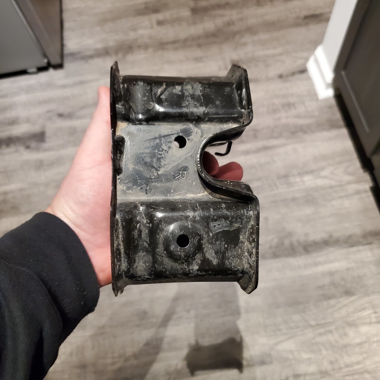

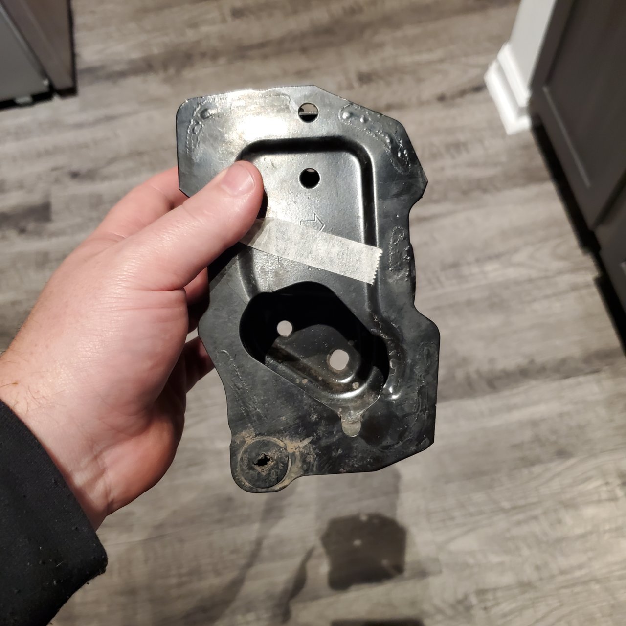

    There's a metal box behind the fender liner against the cab on each side that just unbolts. That's the only place I had any sort of rub. Removed those and zip tied the liners back using those same holes.
    Before I did the lift, the 35's would rub the top arch of the fender flares on the front as well when getting rowdy through dips.That problem went away with lift and can now more or less bottom out the suspension and not touch anything.
    You should be good with a similar setup. I've been meaning to get some new pics. Picking up the truck from getting exhaust this morning and then I can post a couple pictures in this thread for ya.

    Any chance you can send me a pic of what you removed? Is it the safety bracket that prevents the wheel from coming inside the cob in case of a wreck?
  7. Mar 9, 2023 at 6:39 PM
    GoFast157
    GoFast157 New Member
    Jul 7, 2022
    #80377
    70
    I've heard it referenced that way before. And I'm not an engineer. But how this small box held on with 2 fairly small bolts, prevents something the size of a wheel and tire from going through multiple layers of steel and aluminum I don't know. Maybe deflect it under truck? It is called a floor reinforcement bracket on toyotas site.
