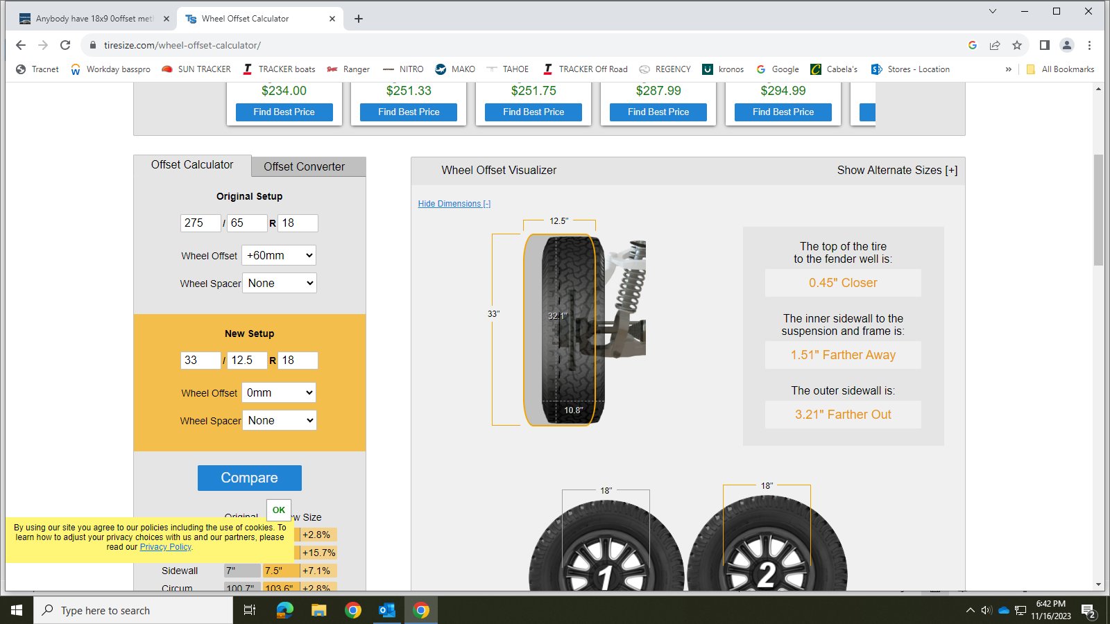

    They will stick way out, sidewall will be almost 3.5 inches further out vs stock wheels and 275/65-18s. You will probably rub in several places, so losing mudflaps, plastics trim and body mount chop may be needed. Aside from the fitment woes, they will be throwing rocks and stuff all down the truck.

    Thanks for your help! Would you recommend a 11-11.5 wide instead?

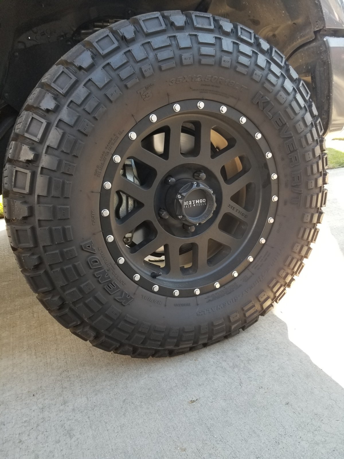

    why not the normal 18x9 +25 methods?

    I’m just worried that they’ll be too flush with the fender and I want them to stick out just a bit, maybe and inch or 1.5. I’m thinking about the +12 offset

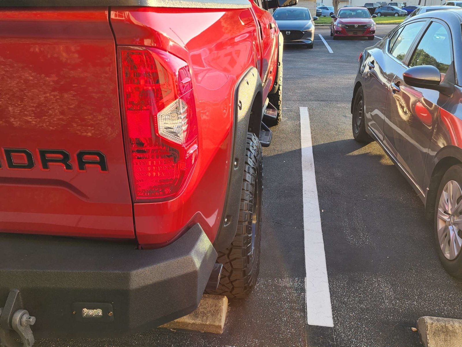

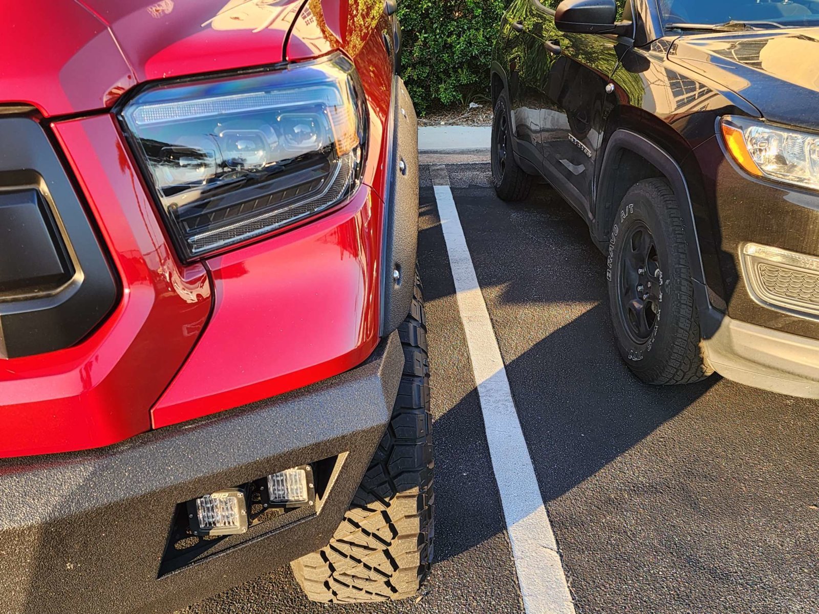

    I did +15 offset and 295/60/r20 tires and I get a bit of poke even with the TRD Pro flares.
    The mess getting thrown on the sides is still happening so I am going to add some wider mud flaps to help keep the paint from getting beat up.

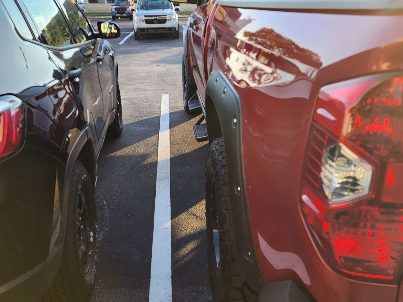

    I have 0 offset with 11.5” wide tires. Poke is a little more than I wanted but it is growing on me. Though I am looking into wider mud flaps like the Rek Gens to cut down the sling down the side of the truck. Thankfully these Mickey Thompsons don’t pick up rocks and gravel like my prior Michelin A/T2s and Wildpeaks.

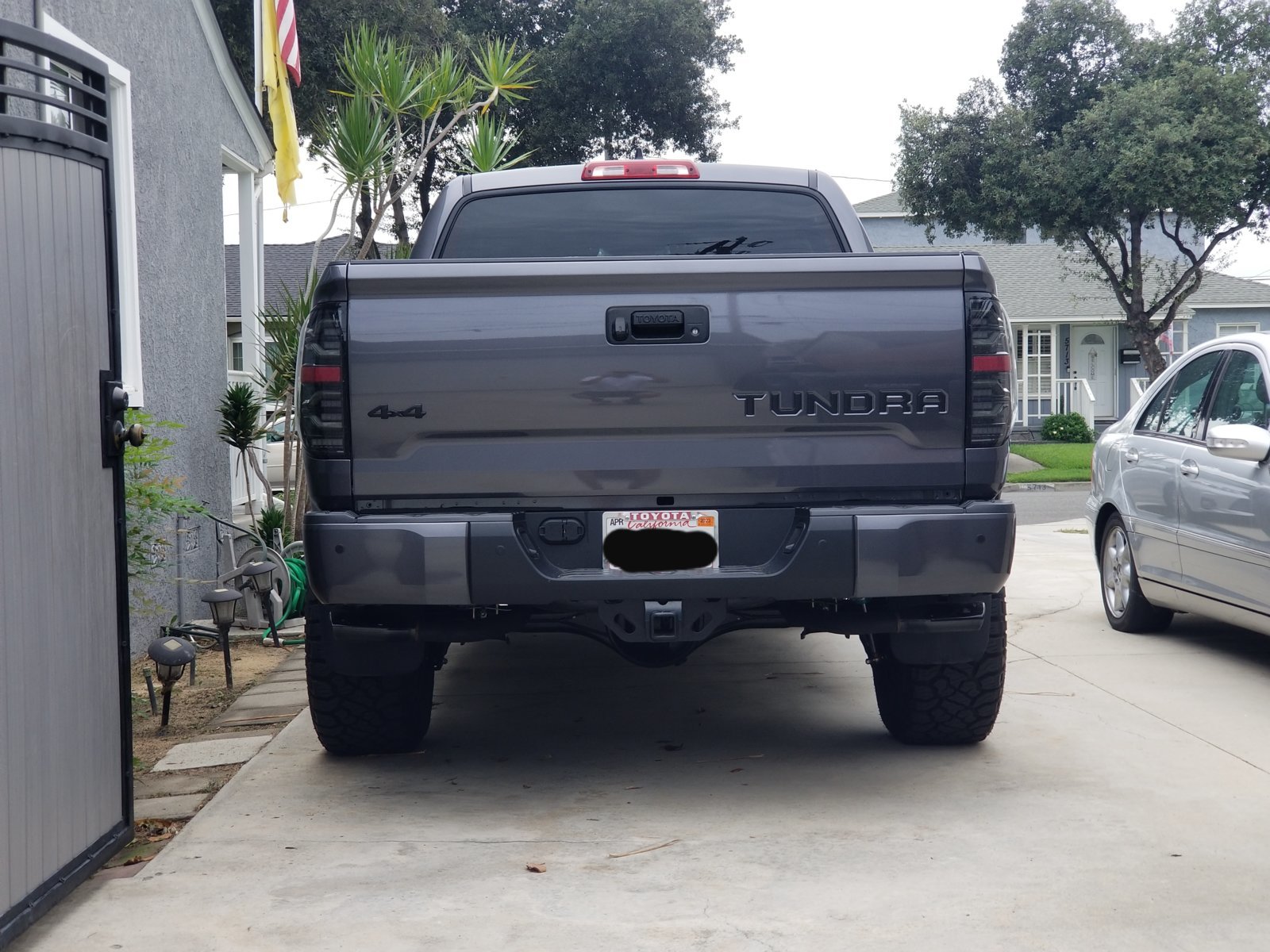

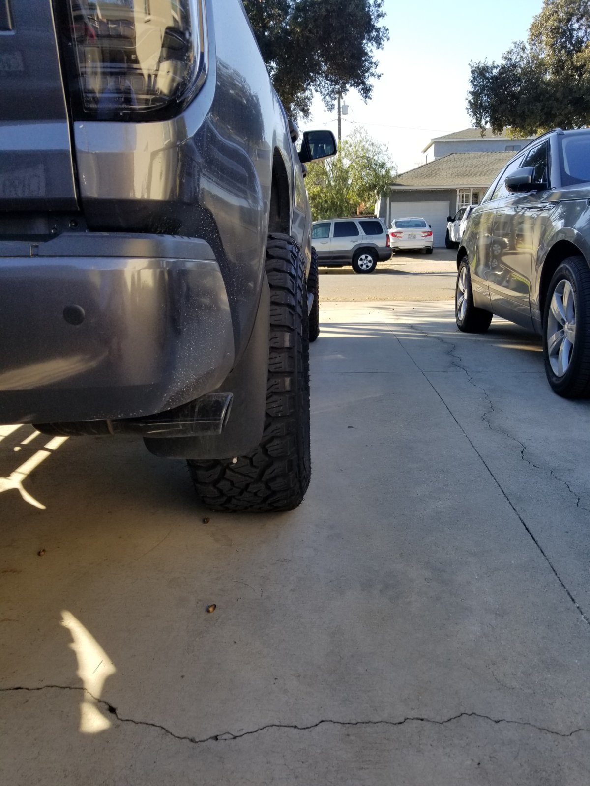

    Mine are 18x9 0 offset with 295/70's (34x11.5)

    Looks sick! Do you have any rubbing?

    No, but I am also on a 4/2 lift.

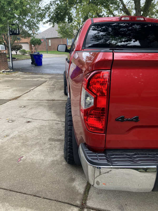

    20221224_141017.jpg 20221224_141017.jpg 20220910_113833.jpg 20221224_141042.jpg I have 18x9 +18 offset with 35x12.5 tires.

    Looks awesome! How much rubbing?

    Are you referring to me? I dont have any rubbing 99.99% of the time. I only get a slight rub if im on a weird angle and turning full lock. I do have a bmc and kings are set to about 3 in

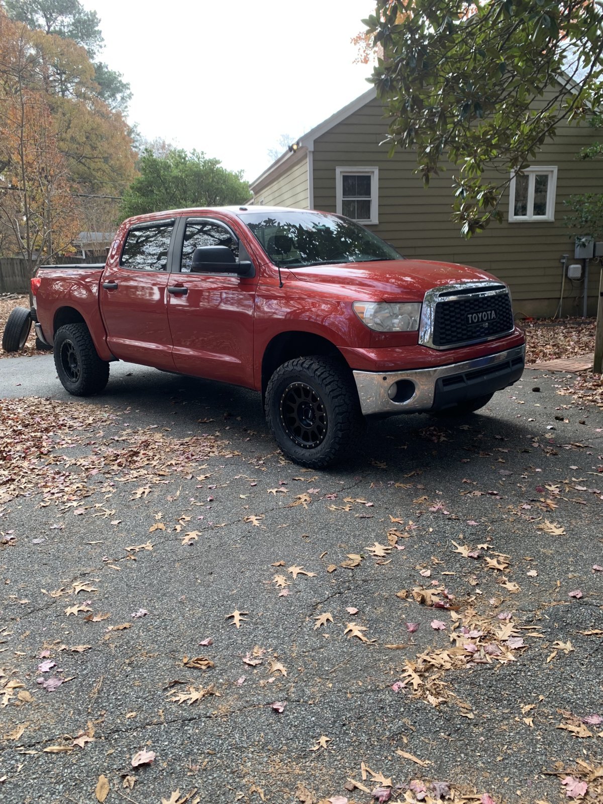

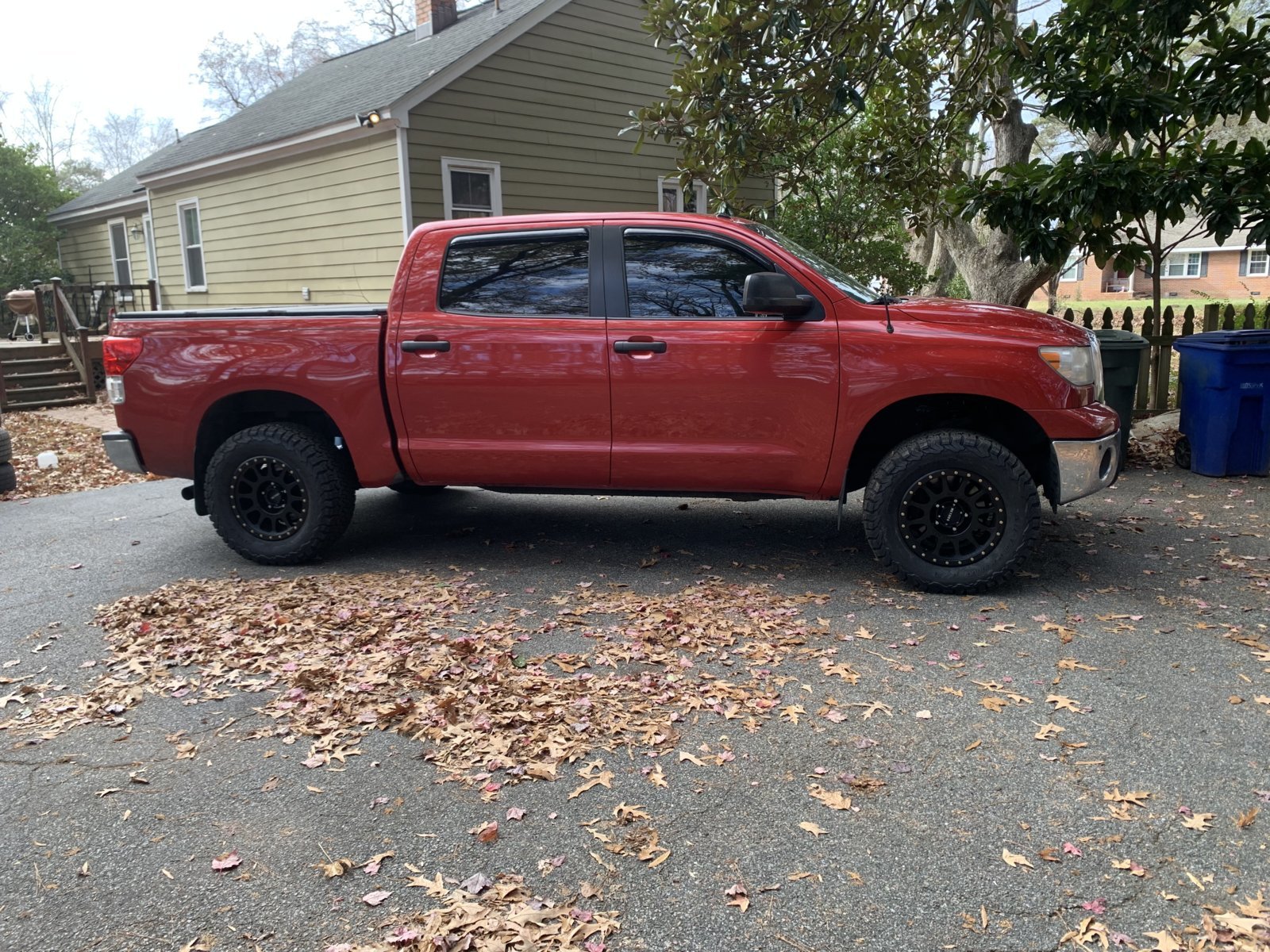

    Finally got the wheels and tires on and new coil overs to level it. I went with the method 305 18x9 0 offset with BFG ko2s 33x12.5
    Like a brand new truck love it!

    Here’s a before and after
