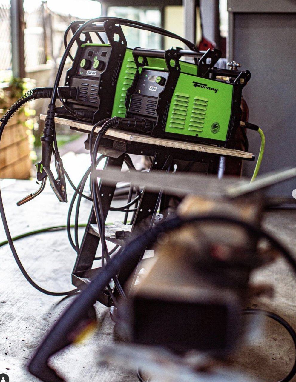

    So I consider myself pretty handy with building stuff (basic electrical, plumbing and wood-working), but there are so many projects I would love to do that would require some basic welding skills. Unfortunately I am completely clueless when it comes to this though, so I would love to teach myself and up my mods game.
    Here are the welders I'm considering: (yeah, they aren't the best or most powerful, but I'm not really considering doing anything over 1/4in)
    Any other cheap units I should consider?
    Here is where the questions come into play...
    • First of all, will a basic 20amp 110v circuit handle these machines? Would suck to get one and then figure out that my outlets can't handle them.
    • Are these even the right TYPES of welders for a beginner that wants to keep the overall costs down?
    • Other than wire, a helmet and gloves, what else would I need?
    • What types of materials could I weld with this? could I do basic tubing (like for sliders and a bull bar) What about for gusseting my spindles?
    • What else am I overlooking?

    I would highly recommend getting a gas mig setup, while flux works it is nasty and a complete pain in the ass. Gas mig is a lot nicer to weld with, albeit the setup is more expensive since you'll need a gas tank too.
    I haven't looked at the welders you listed besides they're from HF, the HF welders I've seen are actually pretty good especially for an entry level. Ive never used those ones in specific so I'd watch some videos, but I'd have no issue rocking a HF setup.
    As for outlet capability, most tools seem to require a 30A breaker. Well maybe not require, but that seems like the common size. I would think 20A would be fine, but can't say definitively. My mig has an internal breaker on the back, so with some research you can probably find the current draw of those welders even if they don't list it.
    For safety stuff, you are correct you just need gloves and a helmet. There are consumable items, like tips for the gun and wire. Tips are very cheap, the welder will probably come with some and those just wear out over time. Wire is not cheap, but you can buy small spools too. I find the HF wire doesn't seem to weld as well as like a Lincoln or name brand stuff (Home Depot has it if there's not a local welding store). You need tips that match the wire diameter. Personally I only have .030" wire since that's kind of a medium/average size, but there's smaller and fatter wire depending on how much material and heat you want to dump in. I had a HF helmet for a long time and it did the job just fine and was cheap, a good helmet goes a long ways. I now have a $100 helmet from Weldcote that is pretty cheap compared to most helmets but hits at a higher price point for it's quality. I'd get the HF helmet to start with, and make sure it's self darkening (helps a lot, especially starting out). Mig gloves are usually pretty thick since mig runs really hot, again HF gloves are fine.
    Other items to consider is a grinder with a flappy disk---clean metal is very critical even though lots of welds are on nasty shit. The cleaner the material the better the weld will be. Again, a HF grinder for $10 and some disks goes a long way. I have a nice cordless Makita grinder and then three $10 HF ones each dedicated to a cut off wheel, grinding disk, and flappy disk so I can quickly swap around at my bench. They get the job done, even if they're not the smoothest thing.
    You'll be able to weld any steel or derivative. Galvanized, zinc plated, etc. can be welded but it's gross. A bull bar, suspension parts, stuff on the frame, will all weld really nice and easy.
    Welding sleeves are nice if you're laying under something. They're not mandatory, but highlight that you should have expendable clothing since mig (especially flux) throws lots of molten metal around.
    Check reviews, decide if flux is fine for you or you'd rather start with a gas system (which can run flux, you don't have to have gas initially but it'll let you expand down the line). Then go splurge at HF on a few tools and start practicing! Welding is one of the most useful tools in my opinion.

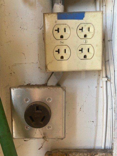

    Many units can run 120 or 240. Do yourself the favor and install a 30A 240V plug, it's worth it. The extended voltage range is better when dialing in your settings.

    I may have a 240v plug already... There is one of these in my garage that I've never used. Came with the house.
    240?

    Assuming it's on its own breaker and not somehow tied into that outlet next to it, yeah, that'll work. Welders only need three legs - hot/hot/ground.

    Was more implying that he has the electrical at that outlet to support a welder. The receptacle is your choice. I swap all of my gear out for Hubbell 50A twist locks. Granted, I made an in-wall conduit junction box and am running overhead power now. Overkill for the average setup.

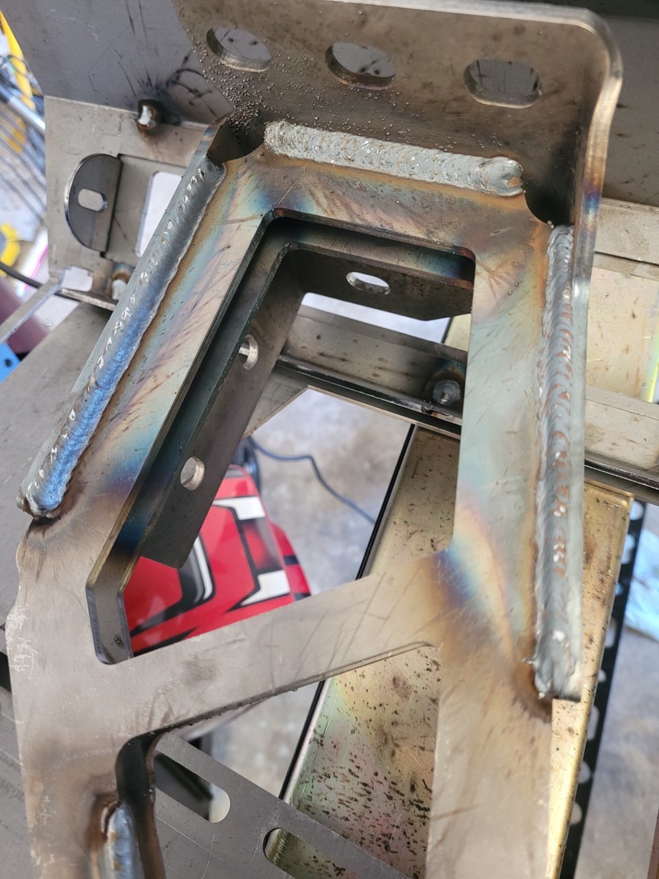

    Screen Shot 2022-06-24 at 7.21.05 PM.jpg One of the best toyota fab guys out there uses Forney.
