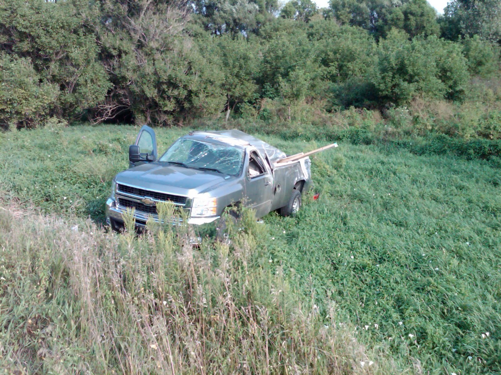

    They don't fix everything. This was the result of my dad pulling a poorly balanced trailer. Notice what is hangin from the tongue....

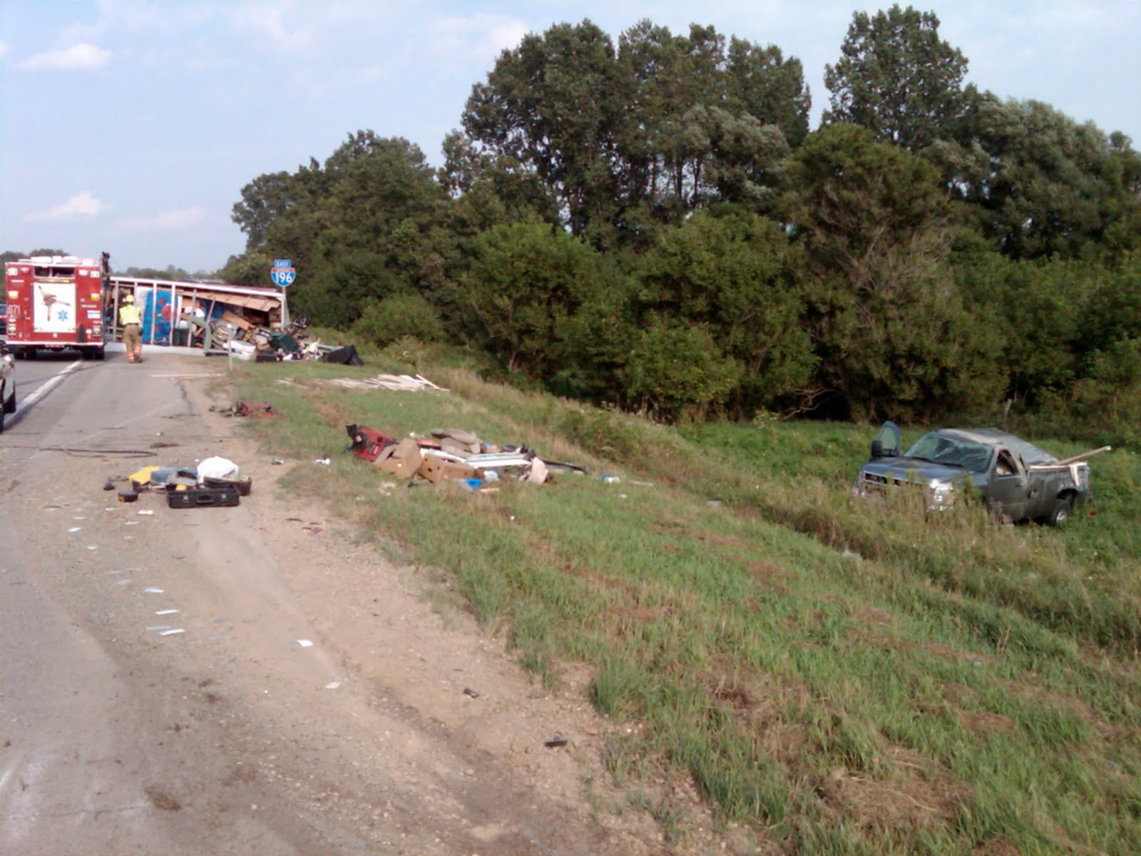

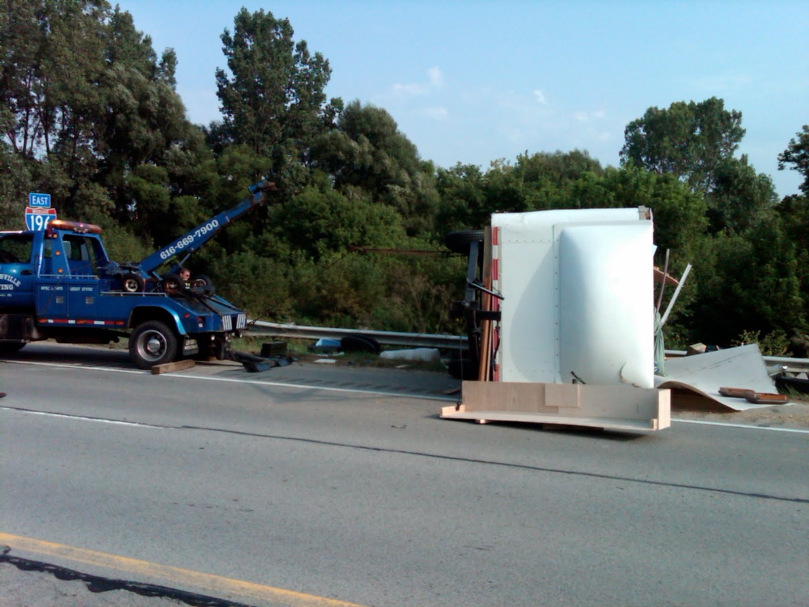

    My brother-in-law loaded this trailer for their move to Florida. My dad stopped at my house on his way home to adjust his hitch. I told him that he did not have enough weight on the tongue. He thought that he would go slow on the way home (about 15 miles) and then we could re-load it before he left for Florida the next morning. He go on the highway a got it up to 55 when he got passed by a truck and well.....
    He walked away from it and it was a single car wreck! The grace of God.IMG00067-20100807-1811.jpg
    It takes one bad judgement when towing to wreck a lot!
