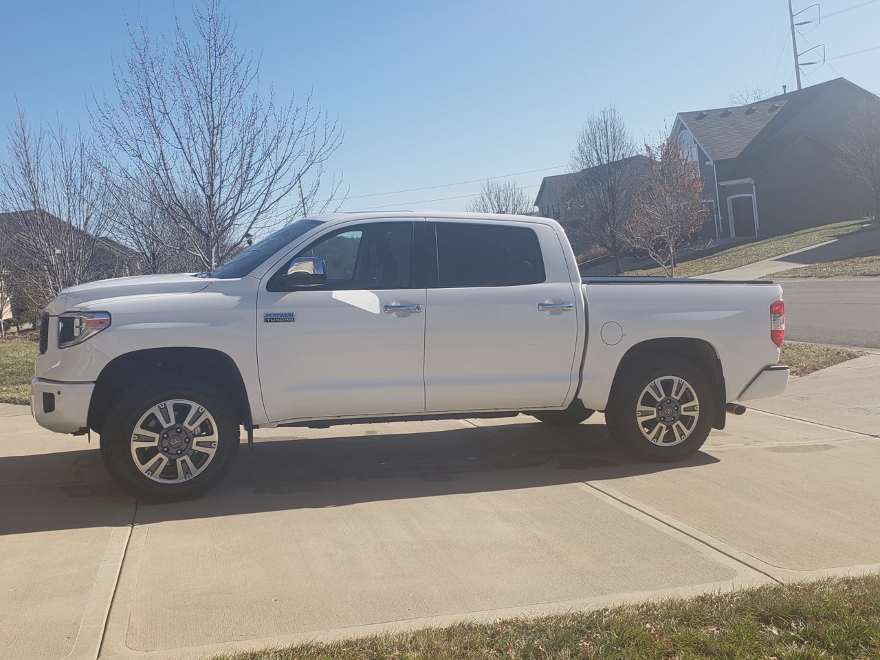

    Went with Fox 2.0 coilovers front and rear. Toyo 275/65/20 tires on stock platinum wheels. Had to trim skid plate slightly.

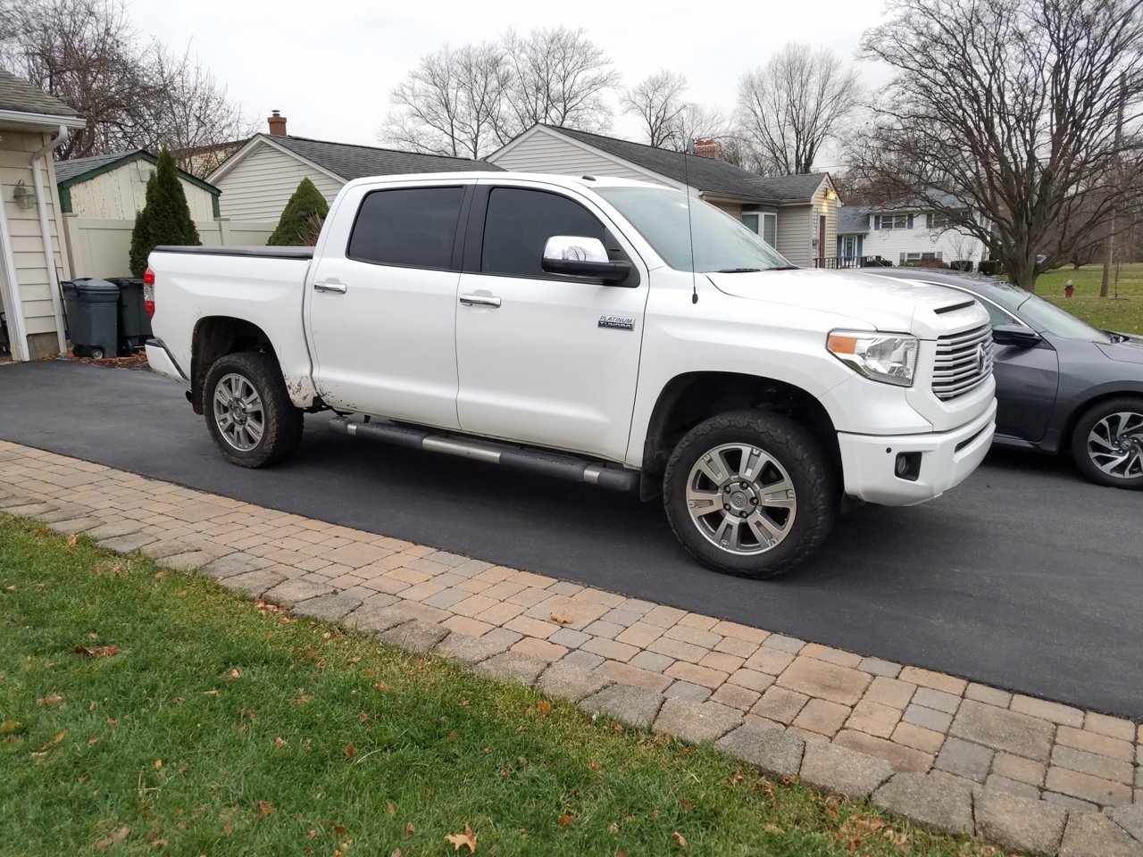

    Platinum here stock wheels, stock tire size. 2.5 in front with the 6100s and actually got 2" in rear with toytec shackle at top setting with 5160s. The ride is really nice, I was worried about harshness at the top setting; not at all an issue.
